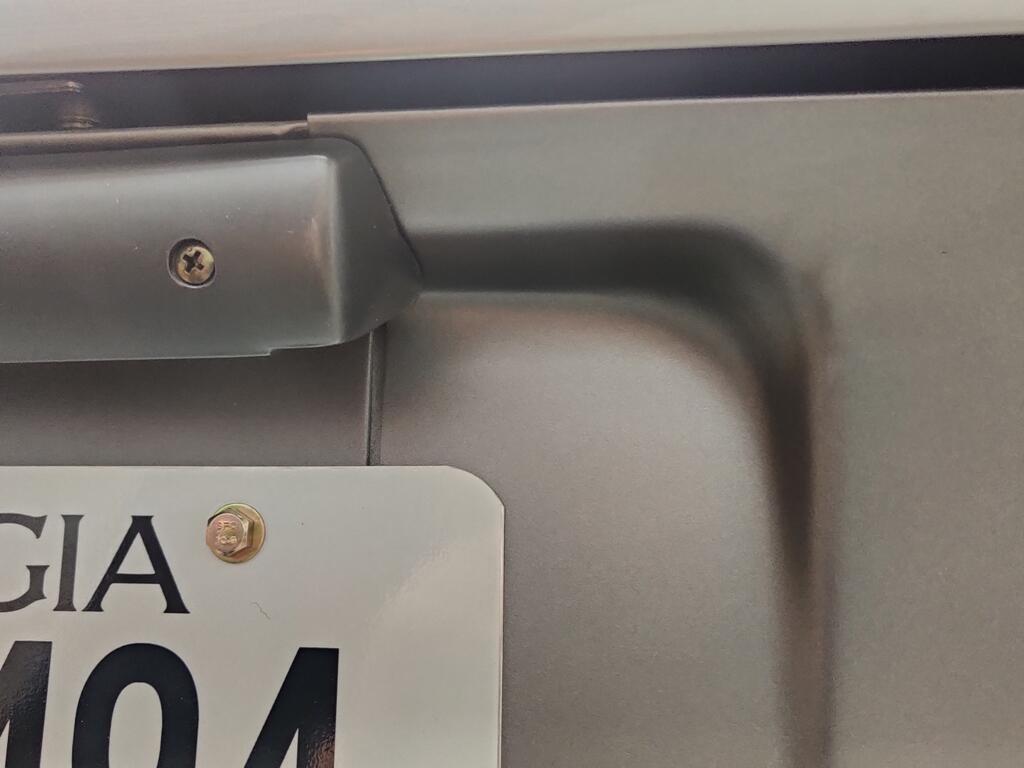

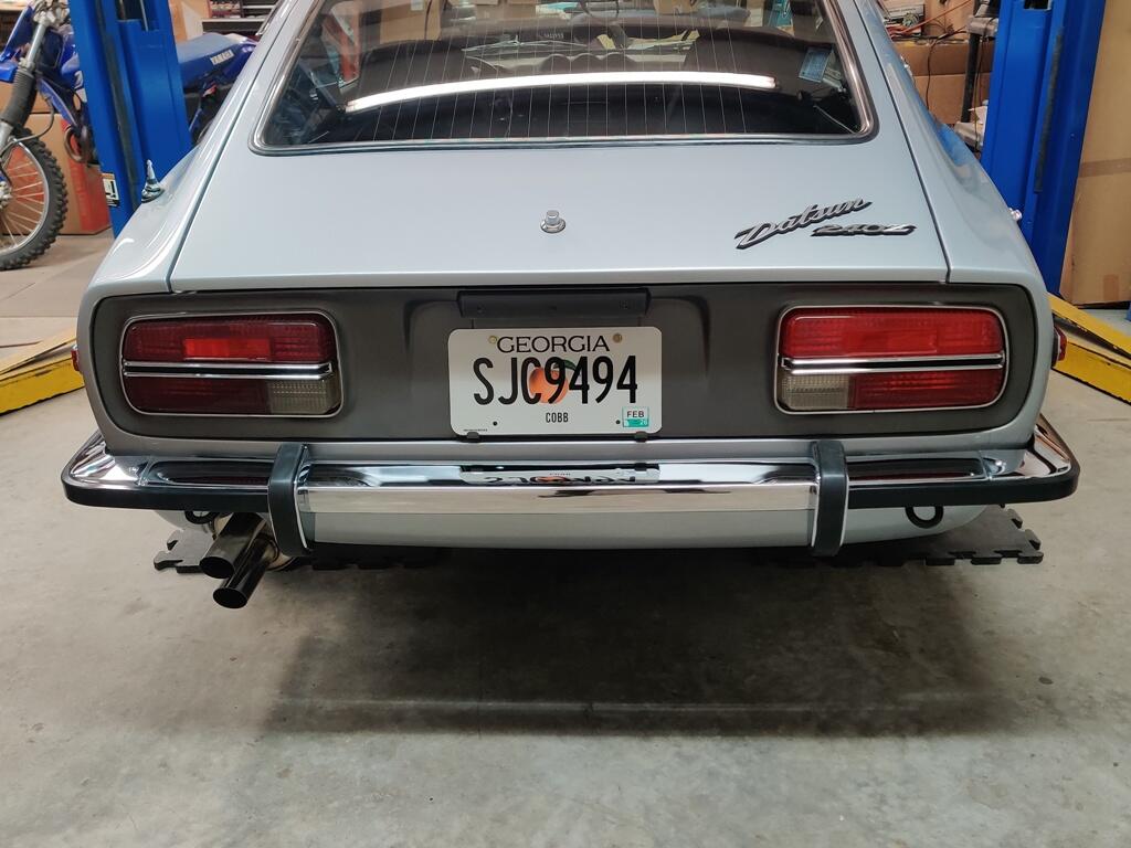

January 5Jan 5 Author comment_672893 I worked on the car for a lot of hours today. I adjusted the brake pedal the proper way: I ran the bump stop all the way in, and threaded the rod into the clevis until I had the right measurement from the firewall/floor to the top surface of the pedal pad. That was 206 mm. Then I threaded the bump stop out until it moved the pedal down 3 mm. Net was 203 mm. Then I adjusted the clutch pedal the same way, setting it even with the brake pedal. I took the car for a short drive. The brakes and clutch work very nicely. When I got back, I put the car on the lift and check all around for leaks. The temperature sender nut needed to be tightened. I was getting some weeping there. The differential fill plug needed to be tightened - there was a drip there as well. The valve cover bolts also needed to be tightened. Some oil was making its way down the right side of the engine at the back corner. I also had a slight exhaust leak at one of the joints, so I tightened all the exhaust clamps. I had not tightened a couple of the clamp sufficiently. Lastly, I painted the tail light finishing panels and installed them. I used the BFM0360 Ford Dark Shadow grey (and matte clear). Comparing it to my NOS license light, the Dupli-color paint looks a bit lighter than the original color, but it is reasonably close. Edited January 11Jan 11 by inline6 Link to comment https://www.classiczcars.com/forums/topic/63087-restoration-of-bringatrailer-240z-hls30-35883/?&page=85#findComment-672893 Share on other sites More sharing options...
