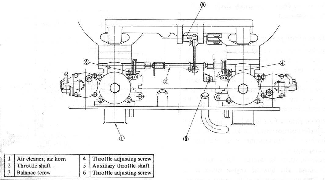

January 19Jan 19 Author comment_673455 "sticky" throttle linkage has been a problem with two out of two 240z's I have owned. To go from no throttle to just a little it of throttle, there is noticeable resistance. I notice that as I try to apply a gentle amount of force, nothing moves. Then I apply more force and more force, until finally, the linkage "jumps" open and the car jumps forward. Driving the car to work the other morning for some show and tell, and getting into the midtown Atlanta area during the commute, this issue was extremely annoying. Yesterday, I worked on all parts of the linkage for the better part of 2 hours. Everything in the linkage has been examined and lubed. Adding grease to the auxiliary throttle shaft (5) helped a little. I disconnected all of the pieces in the linkage and checked each one for issues. Each piece in the system operates smoothly. With the gas pedal disconnected, and carburetor linkage return springs disconnected, I operated the connected parts of the linkage. So, the (5) aux shaft connected to the throttle shaft that slips into eyelet of the bracket on the fire wall, the rod that connects from that shaft to the bell crank, and the rod that goes from the bell crank to the gas pedal. The only thing I can detect as a potential problem in that assembly, as far as resistance to movement goes, is that the rod that goes through the rubber bellows may be rubbing against the inside of the bellows a bit. It is hard to tell with the other end of that rod disconnected from the gas pedal. But I felt some kind of rubbing or vibration coming through the bell crank when operating the linkage. I removed the gas pedal and its mounting bracket (which is made of plastic) and put grease on the pivot points. With that reassembled, I tested movement of the gas pedal alone, and it operated smoothly. However, when I reconnected the gas pedal to the rest of the linkage, and put the carburetor linkage return springs back in action, unbelievably, I got a squeak at the gas pedal pivot (which I confirmed was unrelated to the spring that is there. That is what I chased for a good part of the time I was working on this "little" issue. After I got that quieted down, I decided to do a brief test drive around the neighborhood to see how much better it was. I was able to control the throttle application a little better, but it's not good enough for me. Anyone else have luck addressing this? I have an old recollection from when I dealt with this issue on my other 240z many years ago. I believe I ended up changing the length of the adjustable connecting rod and that was helpful. In concept, that would alter some of the operating angles of the system. Edited January 19Jan 19 by inline6 Link to comment https://www.classiczcars.com/forums/topic/63087-restoration-of-bringatrailer-240z-hls30-35883/?&page=86#findComment-673455 Share on other sites More sharing options...

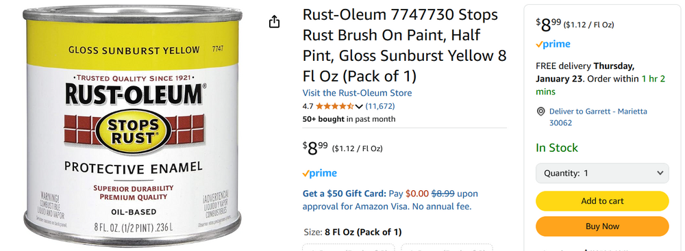

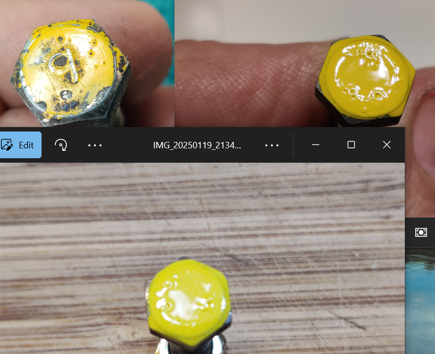

January 20Jan 20 Author comment_673467 I bought some of this yellow paint to see if it might be close to the stuff that was used in the original assembly line. It was inexpensive, so I thought I would have a look. Lighting is a big factor in the look from a picture. But here is an original fastener with paint that is in pretty good condition, along with a fastener that I dipped into the new paint. My skin color is darker in the picture of the new paint, which tells me the lighting is darker. I also took a picture in another room (kitchen) with different lighting. It looks reasonably close in the pictures, but I think is a bit "lighter" than the original paint. Edited January 20Jan 20 by inline6 Link to comment https://www.classiczcars.com/forums/topic/63087-restoration-of-bringatrailer-240z-hls30-35883/?&page=86#findComment-673467 Share on other sites More sharing options...
January 20Jan 20 comment_673509 I think you scored the right paint.. the old bolt with orig. paint is old AND dirty.. so the new paint looks good for it's job. Link to comment https://www.classiczcars.com/forums/topic/63087-restoration-of-bringatrailer-240z-hls30-35883/?&page=86#findComment-673509 Share on other sites More sharing options...
January 20Jan 20 comment_673510 I think the throttle issue is related to the bellcrank on the firewall under the hood. On my 74 I noticed the the angle from the bellcrank to the auxiliary throttle shaft was somewhat extreme, so I cut the upper arm off a spare bellcrank and welded it on higher up on the tube. This reduced the angle to the throttle shaft and made it a little easier to control the application. I got this idea looking at an early 240 bellcrank. Link to comment https://www.classiczcars.com/forums/topic/63087-restoration-of-bringatrailer-240z-hls30-35883/?&page=86#findComment-673510 Share on other sites More sharing options...

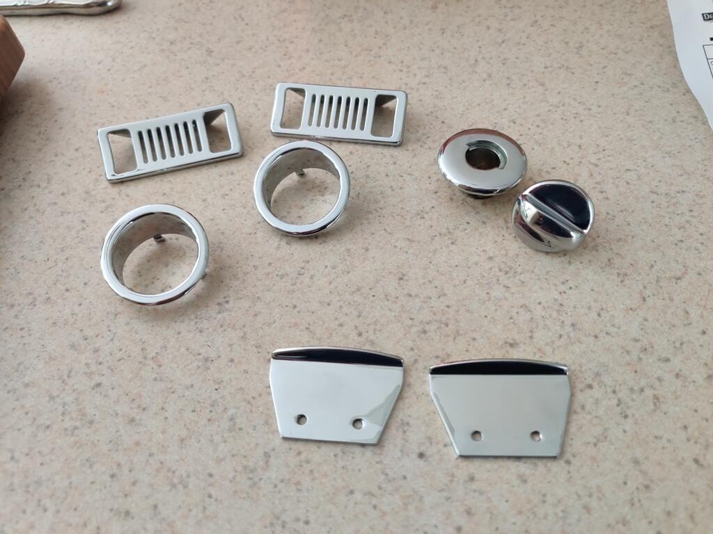

January 25Jan 25 comment_673663 On 10/6/2024 at 1:08 AM, inline6 said: am pausing on the seat bottoms for now. I need to think about how to make them look right. It is going to require something other than just hog rings to secure wire in the flap to the wire under the Pirelli straps. More distance will be required to keep the material from being yanked down too far. In the meantime, I got the small parts back from the chrome plater. They came out nicely. These cost about $250 to have redone. Who did this chrome work for you? and what are the two flat pieces with the lip? Link to comment https://www.classiczcars.com/forums/topic/63087-restoration-of-bringatrailer-240z-hls30-35883/?&page=86#findComment-673663 Share on other sites More sharing options...
January 26Jan 26 Author comment_673676 On 1/25/2025 at 7:07 PM, Patcon said: Who did this chrome work for you? and what are the two flat pieces with the lip? This is the place: Decorative Metal Coatings 2613 Temple Heights Dr. Ste. C Oceanside, CA 92056 Tel: (760) 746-3378 Fax: (760) 940-8781 Email: Accounting@DecoMetalFinishing.com Those plates are part of the ash tray parts. The plates seems to be something you can grab onto to lift the front of the ash tray out of the console. I had two sets of ash tray parts done. Link to comment https://www.classiczcars.com/forums/topic/63087-restoration-of-bringatrailer-240z-hls30-35883/?&page=86#findComment-673676 Share on other sites More sharing options...
January 26Jan 26 comment_673680 Thanks for that. I have a number of parts that will need chroming. Gas door latches, hatch thimbles, ashtray parts, int door trims. Could get expensive... I found a company in Marietta. Did you speak to them? https://www.chromeatlanta.com/?utm_source=GMB&utm_medium=organic Link to comment https://www.classiczcars.com/forums/topic/63087-restoration-of-bringatrailer-240z-hls30-35883/?&page=86#findComment-673680 Share on other sites More sharing options...

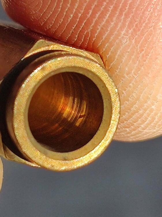

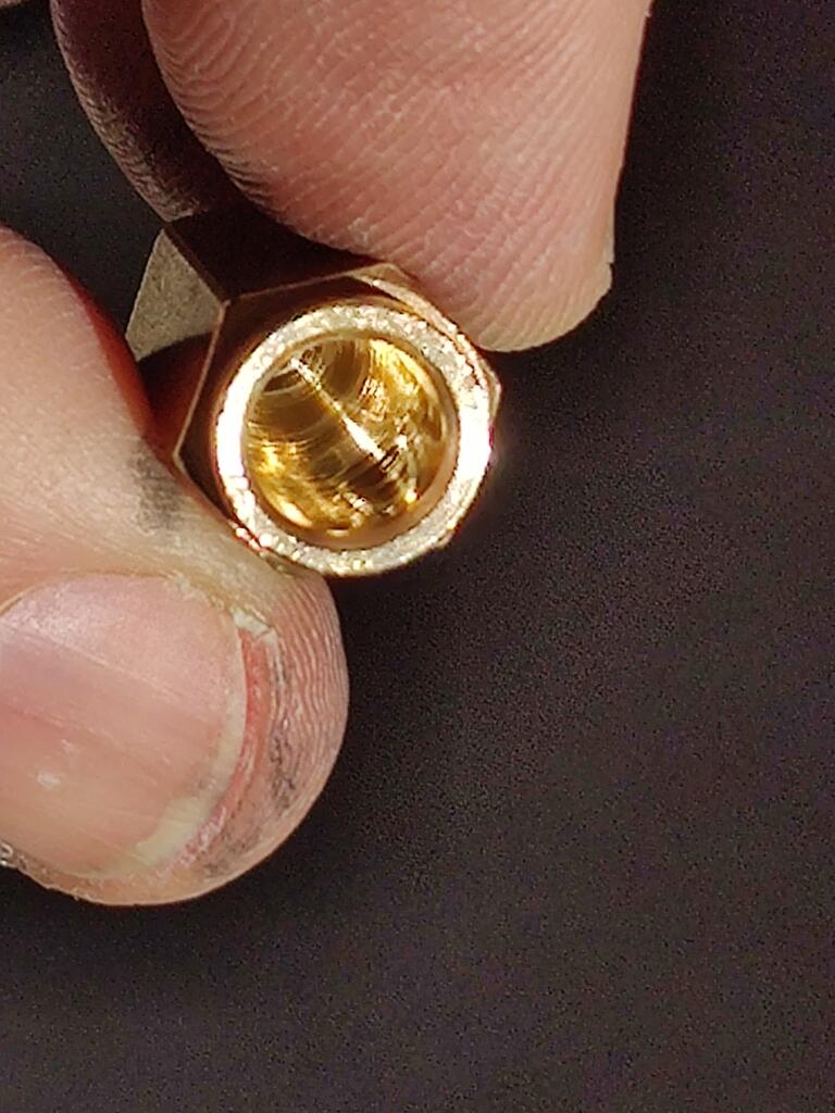

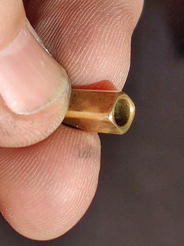

January 26Jan 26 Author comment_673686 The replacement connecting rod for the carburetor showed up in the mail today from ZTherapy. Thanks @Patcon for suggesting I contact them. Unfortunately, the replacement needles and seats did not show up in the mail today. So, I found myself removing the rear carburetor needle and seat... just to have little look see at it for issues. Well, one thing led to another, and I found myself on Youtube watching a video someone made about their needle and seat not working properly and causing fuel to gush everywhere. That person used a Q tip in a drill and some metal polish to polish the inside barrel of the seat. I decided to have a close look at mine. I wasn't able to take a good picture, but you can kind of see from the above one that the inside of the seat bore where the needle sits is not exactly smooth. So, I grabbed a small section of 1500 grit sandpaper and rolled it around a drill bit which I inserted into this bore. Using the drill, I smoothed out the ridges on the inside of the seat. Then I used a Q tip and some metal polish and a drill to polish the inside of the barrel. I then sanded the corners of the needle with some 2500 grit sand paper and polished the corners of it as well with the Q tip and metal polish: I After cleaning them, I put the needle and seat back together in the carburetor. Because I had to take the linkage apart to install the new connector rod, I synchronized the carburetors again. Here is something interesting: While I did the standard balancing procedure which included setting each carburetor's set screw so that each carburetor had the same flow at idle, and then screwing in the auxiliary shaft screw (to activate the linkage against both carburetors) and setting the balance screw to have the same flow during throttle application, I also did something similar for the choke. This is not something I saw in the factory workshop manual. For proper choke function, the factory workshop manual provides instruction to set a specified gap between the throttle plate and the body of the carburetor when the choke lever is pulled. This is to be done for each carburetor. After this is done, in theory, when you pull the choke lever, the choke mechanism will open the throttle plates on the front and the rear carburetor the same amount. I did as instructed in the factory workshop manual. However, I then started the car with the choke lever slightly activated. This raised the speed of the engine above normal idle speed. And then, I checked the flow of air through each carburetor using the Uni-Syn. Well, the flow was not the same. Similar to the procedure to balance the front and rear carbs when the linkage is activated, I used the Uni-syn flow meter to set the flow between the two carburetors to the same amount with the choke lever in operation (slightly). To adjust flow I had to shorten/lengthen the connecting rod for the choke. After completing this adjustment, when I pull my choke cables to start the carburetors, both throttle plates are opened to a position where both carburetors are flowing the same! I never was able to get the chokes working well on my track Z (when it had SU's), but I think this will be the ticket to getting the chokes to operate well on this car. I will be able to test that tomorrow when the engine is cold. I did take the the car for brief drive after messing with the needle and seat. So far, so good! I hope I have solved the issue with the rear carburetor puking fuel. Edited January 26Jan 26 by inline6 Link to comment https://www.classiczcars.com/forums/topic/63087-restoration-of-bringatrailer-240z-hls30-35883/?&page=86#findComment-673686 Share on other sites More sharing options...
