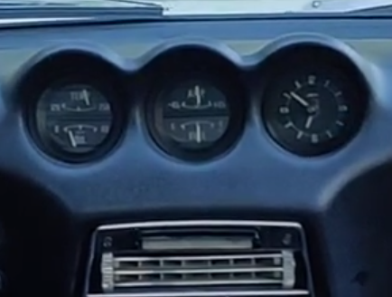

January 28Jan 28 Author comment_673755 Snagged this from a driving video I shot a couple of days ago. I have just stopped from pulling into my driveway. Temp gauge reading is actually even higher than I was saying - looks like the needle is cutting through the P in TEMP. Thanks @Captain Obvious for the pictures and comments about adjusting. It is a bit of a pain to get the gauge out at this point, but it is on my short list.  Link to comment https://www.classiczcars.com/forums/topic/63087-restoration-of-bringatrailer-240z-hls30-35883/?&page=87#findComment-673755 Share on other sites More sharing options...
January 28Jan 28 comment_673759 Yeah, that temp gauge is a little disconcerting. Even if your logical mind knows that it's an instrumentation issue and not a real temperature issue, just looking at that thing would drive me nuts. So while you are in there, are you happy with the location of the oil pressure readings? Because if you're going to be into the guts of the gauge, that would be the opportunity to adjust the OIL as well. Link to comment https://www.classiczcars.com/forums/topic/63087-restoration-of-bringatrailer-240z-hls30-35883/?&page=87#findComment-673759 Share on other sites More sharing options...

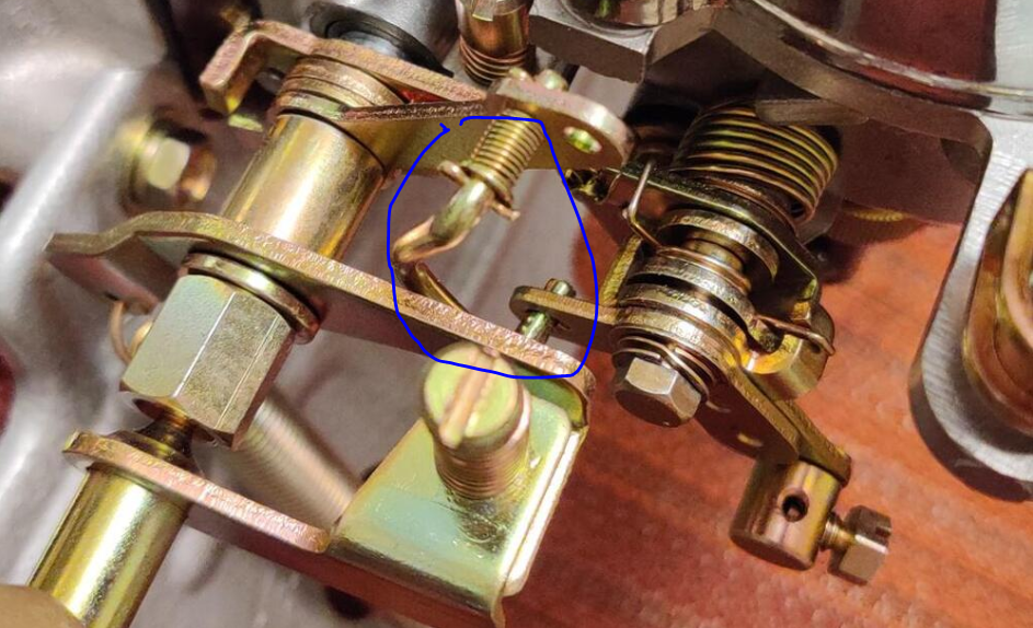

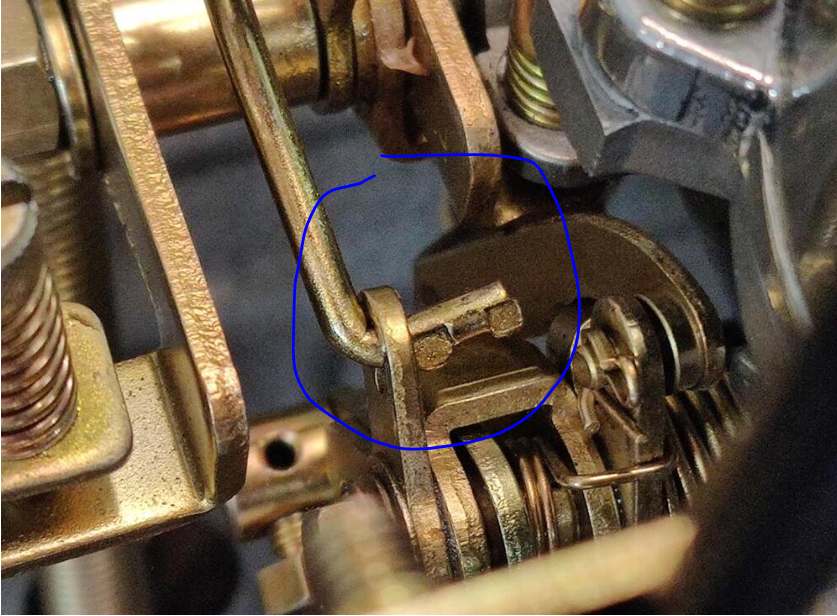

January 29Jan 29 Author comment_673799 I started the car from dead cold a couple of days ago - this was after using the Uni-Syn to measure flow through each carb while the choke was in operation. I am very happy with how car starts now with the choke. I have also eliminated my sticking nozzles by bending the "Connecting Plate A". This is the flat bar part of the linkage that attaches to the bottom of the nozzle. Slight bends to it removed sideways force being applied to the nozzles. I had to do this for both carburetors. And, by setting the throttle plates firstly, to open to the gap specified in the factory workshop manual, and secondly, to achieve the same flow rate in each carburetor as indicated by the Uni-Syn flow measurement tool, I believe I have set the "starter interlock opening" on both carburetors very accurately, and I have achieved a well functioning "starting mechanism".  The first step is to get the gap between the bottom edge of the throttle plate and the carburetor bore (as measured by a piece of ductile wire which I hammered to the right thickness and then used as a feeler gauge) to the .0232" to .0271" which is specified in the factory workshop manual. The second step is to start the car and set the "choke" lever to a spot where the engine is running at a fast idle speed (with the starter interlock acting on the throttle plates in the carburetors), and adjusting the "bent" connecting rod. This rod is circled in blue here: By bending it either more or less at the kink, you adjust its length, which changes the amount that this starter interlock linkage opens the throttle plates via the operating arm to which it is attached. When I was working on resolving my sticking nozzles a week or so ago, I managed to break the connecting rod on the front carburetor. I have since figured out what happened. When the screw holding Connecting Plate A to the bottom of the nozzle is removed, the starter interlock linkage (which is spring loaded) will forcibly move itself to a position where the bottom of this connector rod (blue circle in this pic) can shift laterally. In this picture, the rod on the rear carburetor has indeed shifted. It needs to be shifted to the left, so that the arm is located on the rod between the two pinched spots.   The two pinched parts of the rod can align with the "key hole slot" in the linkage arm. When they do that, then the rod can shift out of its correct position as seen above. I did not notice this the other day, and when I couldn't bring the linkage back down to attach Connecting Rod A back to the nozzle, I just applied more force. The bottom of the rod had one of the pinched parts in the "key hole" on the attached linkage arm, preventing rotation at this joint. When I applied more force, this end of the rod twisted and broke. So, that is something to watch out for if you decide to work on your sticking nozzles!  Edited February 8Feb 8 by inline6 Link to comment https://www.classiczcars.com/forums/topic/63087-restoration-of-bringatrailer-240z-hls30-35883/?&page=87#findComment-673799 Share on other sites More sharing options...

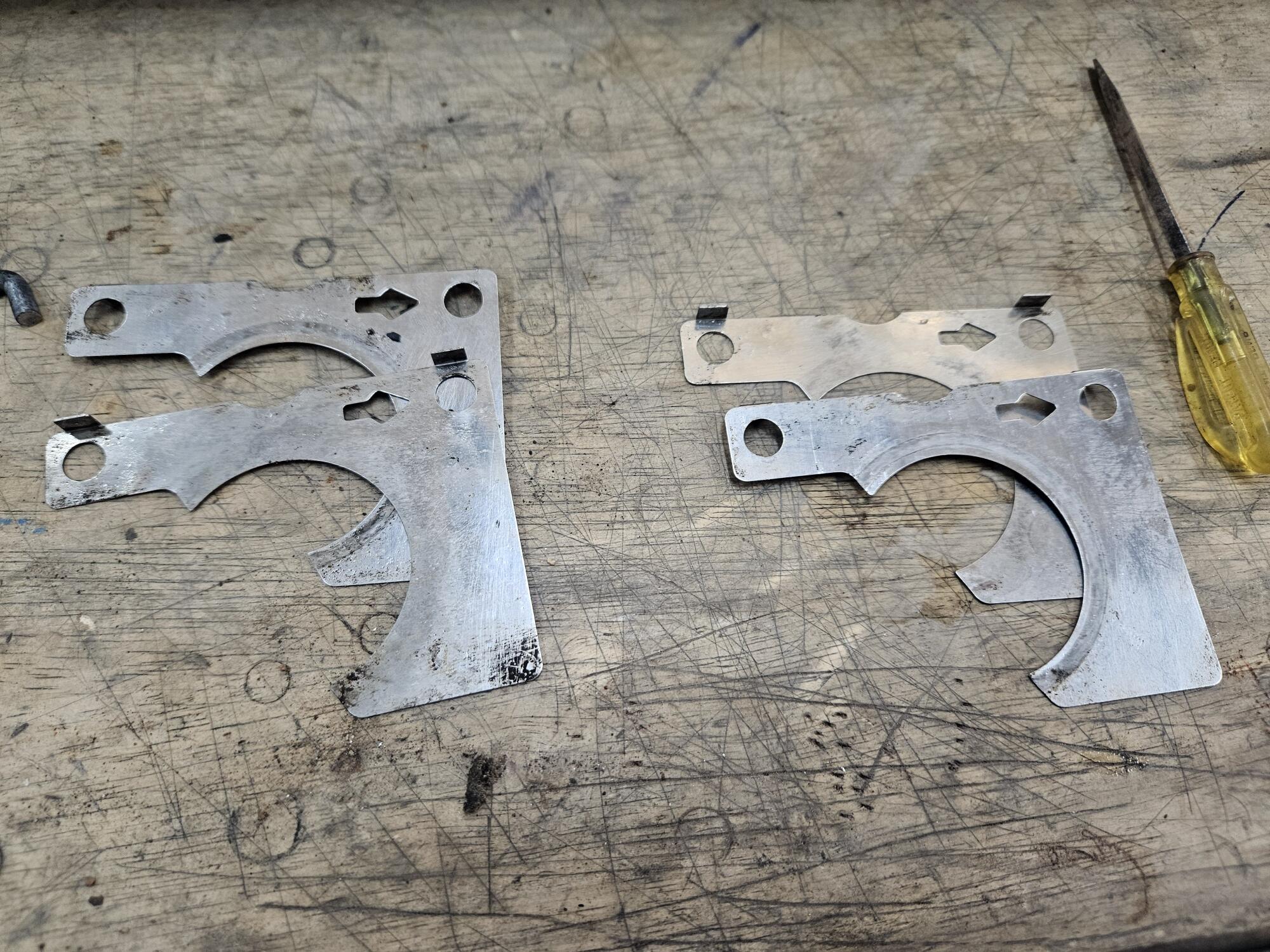

February 10Feb 10 Author comment_674409 Anyone have a full set of these?  I can't find any in my parts stash, and my brakes are squealing something fierce. Link to comment https://www.classiczcars.com/forums/topic/63087-restoration-of-bringatrailer-240z-hls30-35883/?&page=87#findComment-674409 Share on other sites More sharing options...
February 11Feb 11 comment_674426 6 hours ago, inline6 said: Anyone have a full set of these?  I can't find any in my parts stash, and my brakes are squealing something fierce. I might. Id have to look this weekend Link to comment https://www.classiczcars.com/forums/topic/63087-restoration-of-bringatrailer-240z-hls30-35883/?&page=87#findComment-674426 Share on other sites More sharing options...
February 11Feb 11 comment_674427 In case you cant find a set. High temp brake silicone grease on the piston, brake quiet spray on the back of the pad and chamfer edges of the pad. Bed them in real good. That usually works for me. Link to comment https://www.classiczcars.com/forums/topic/63087-restoration-of-bringatrailer-240z-hls30-35883/?&page=87#findComment-674427 Share on other sites More sharing options...
February 11Feb 11 comment_674431 13 hours ago, inline6 said: my brakes are squealing something fierce. Did you also take the corners off of the pads in a 45 degree way? that stops most squealing.. Â Link to comment https://www.classiczcars.com/forums/topic/63087-restoration-of-bringatrailer-240z-hls30-35883/?&page=87#findComment-674431 Share on other sites More sharing options...
February 15Feb 15 comment_674545 Link to comment https://www.classiczcars.com/forums/topic/63087-restoration-of-bringatrailer-240z-hls30-35883/?&page=87#findComment-674545 Share on other sites More sharing options...
February 16Feb 16 comment_674554 2 hours ago, Patcon said: I wonder if Skillard might consider making reproductions of those. Link to comment https://www.classiczcars.com/forums/topic/63087-restoration-of-bringatrailer-240z-hls30-35883/?&page=87#findComment-674554 Share on other sites More sharing options...
February 16Feb 16 comment_674558 Sendcutsend has .030 thick stainless. That's the thinnest they list. @Patcon, what's the thickness of those anti-squeal shims? Link to comment https://www.classiczcars.com/forums/topic/63087-restoration-of-bringatrailer-240z-hls30-35883/?&page=87#findComment-674558 Share on other sites More sharing options...
February 16Feb 16 comment_674560 41 minutes ago, Captain Obvious said: Sendcutsend has .030 thick stainless. That's the thinnest they list. @Patcon, what's the thickness of those anti-squeal shims? 0.016" approx thick. They have two small tabs bent 90d on the top edge Link to comment https://www.classiczcars.com/forums/topic/63087-restoration-of-bringatrailer-240z-hls30-35883/?&page=87#findComment-674560 Share on other sites More sharing options...
