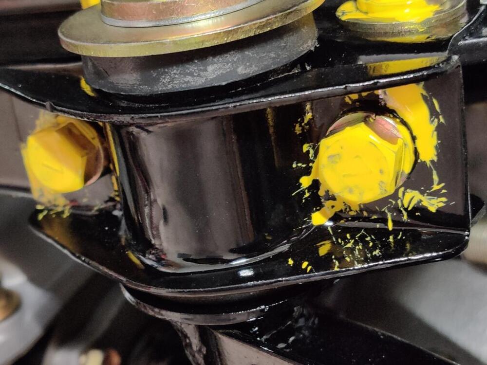

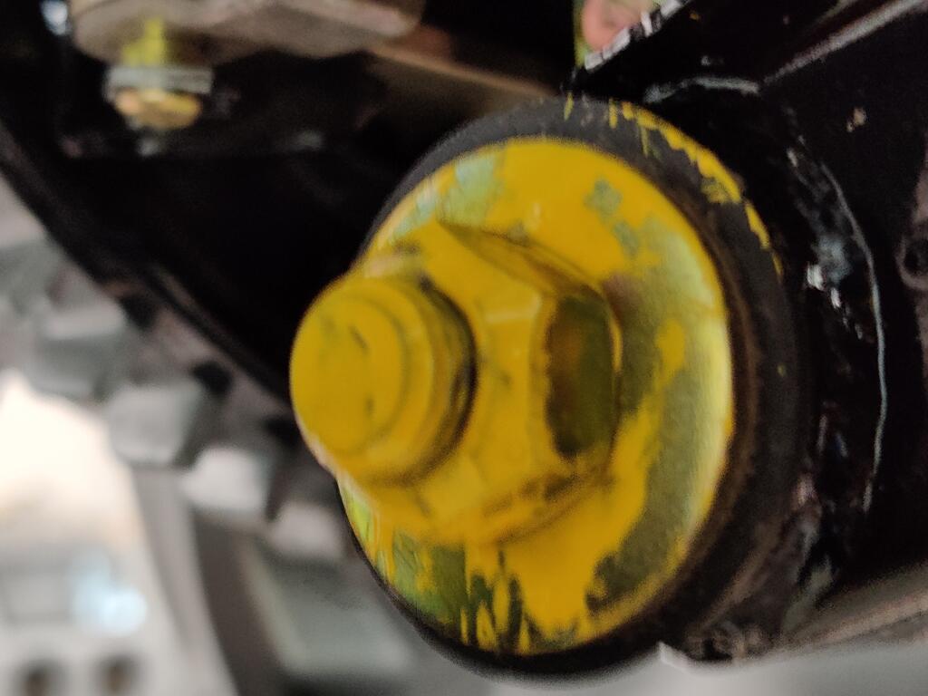

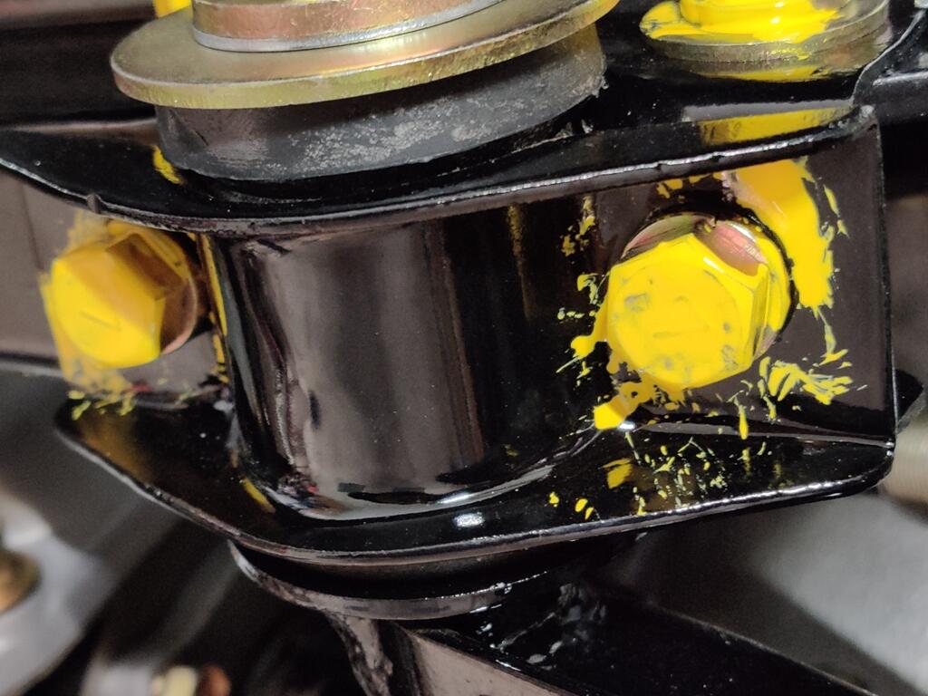

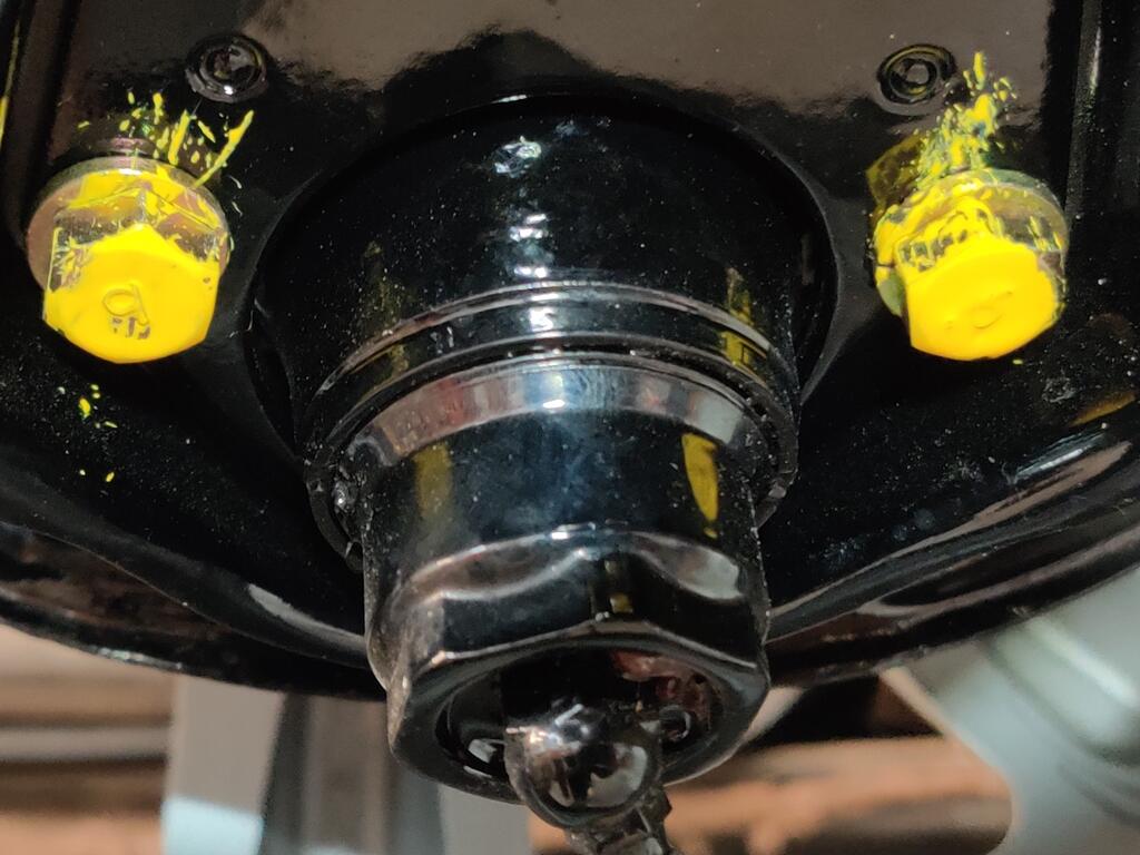

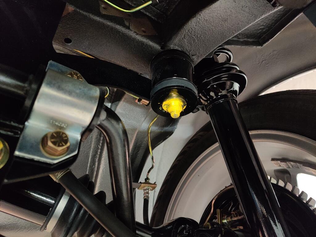

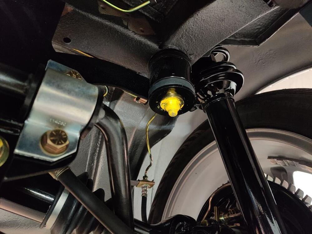

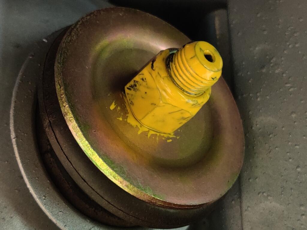

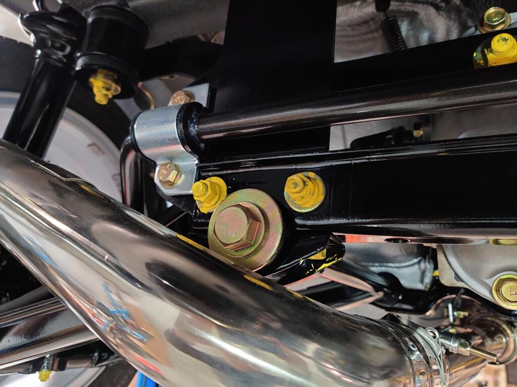

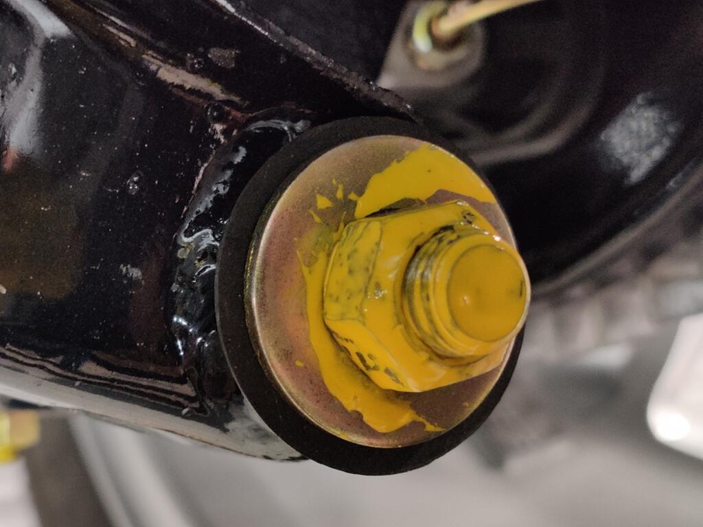

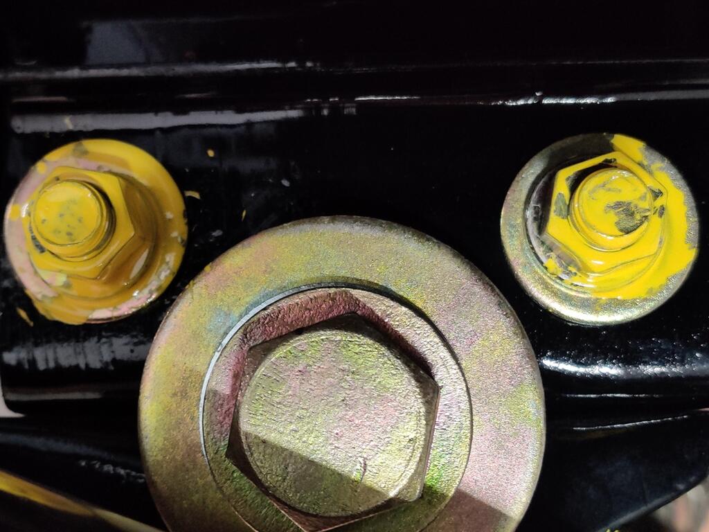

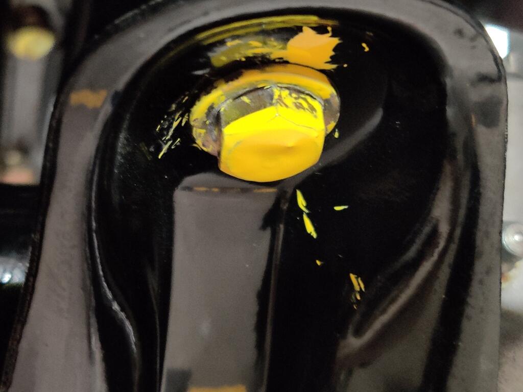

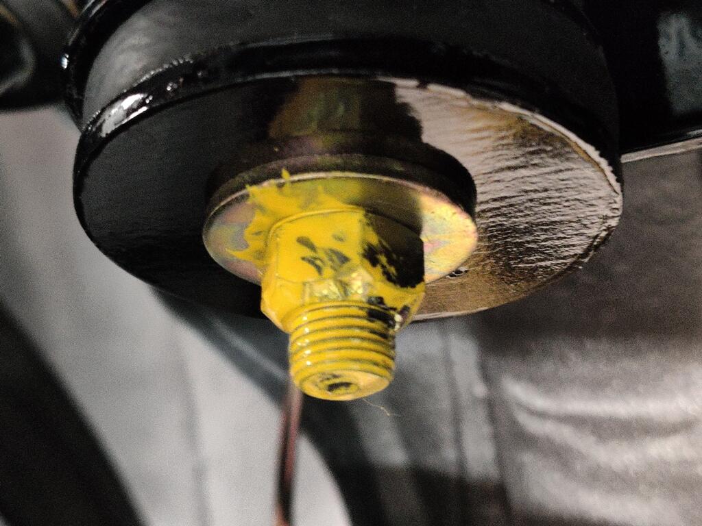

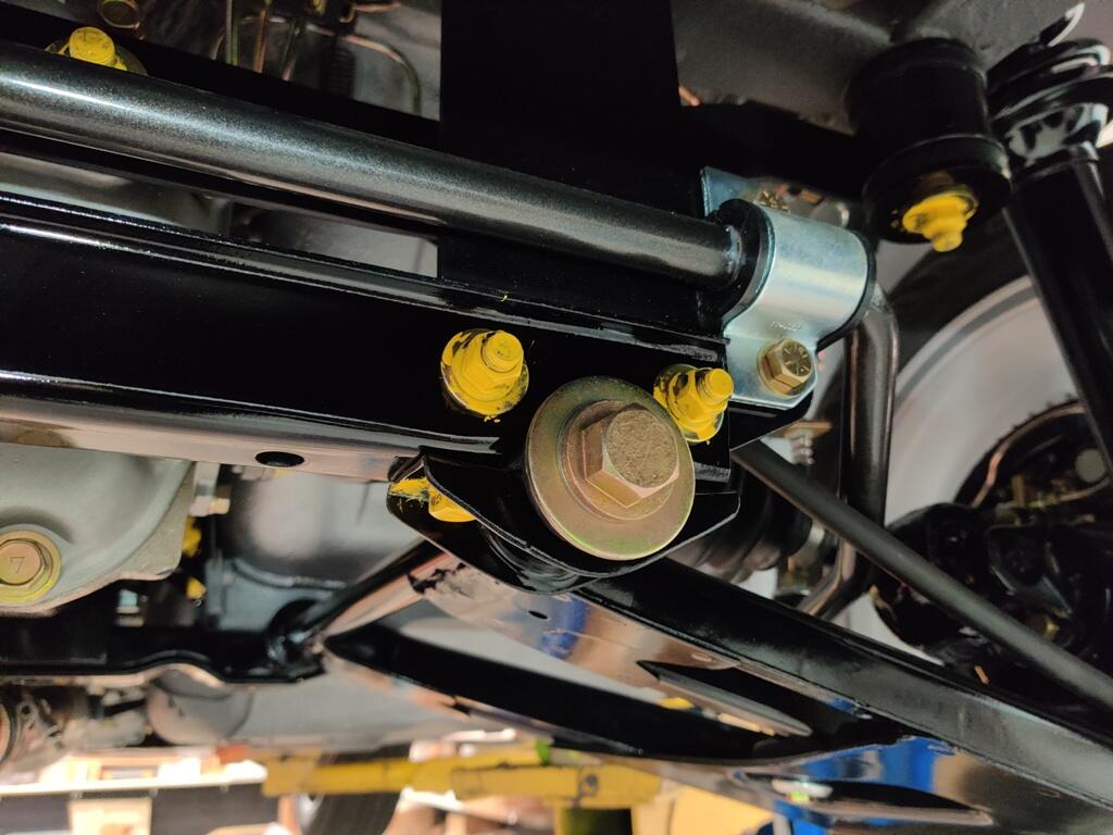

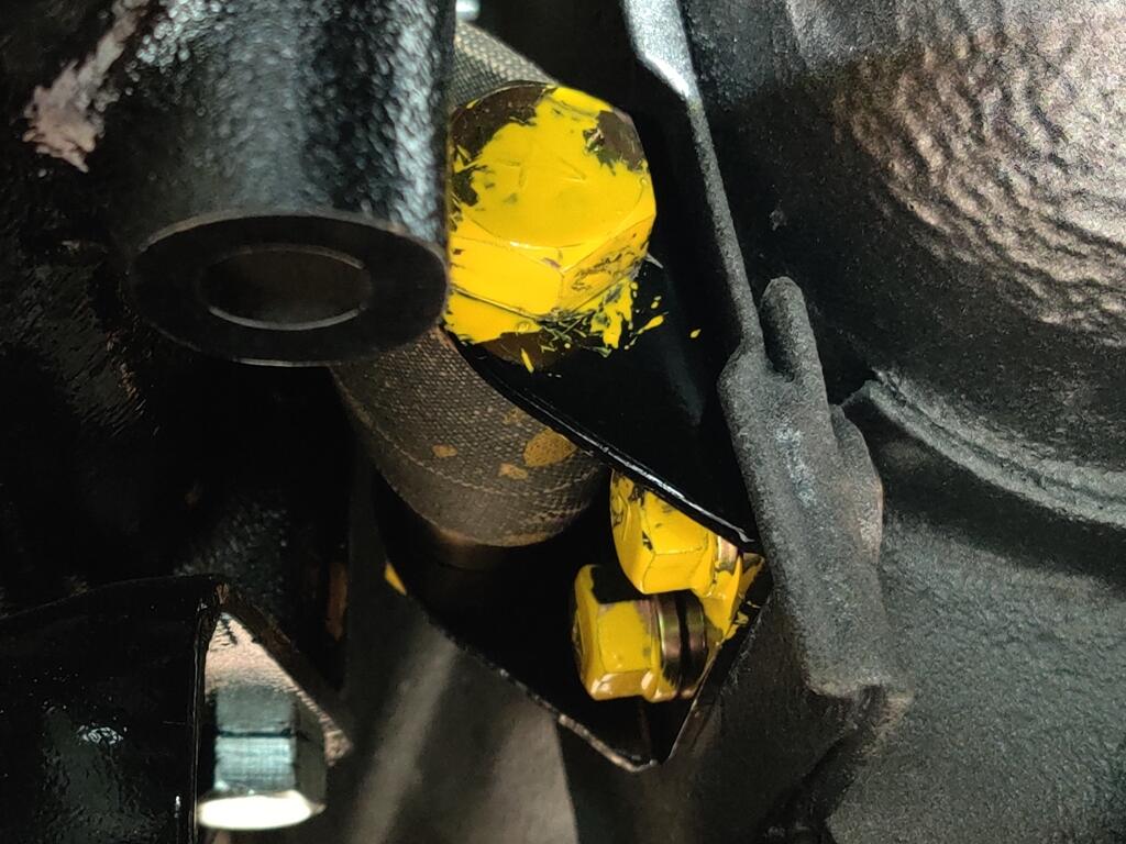

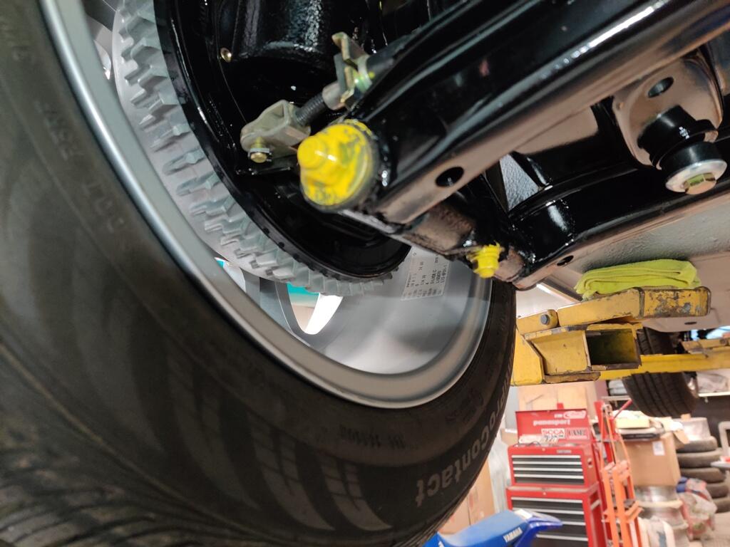

I had some fun putting yellow paint on the suspension bolts yesterday.  I took some a bunch of closeups.
The last picture above is of the left outer tie rod end.  As taken out of the box, it had a yellow paint swipe across the top.  I'm not sure what that means.  The "green monster" on BAT has a yellow paint mark that goes around the rod.
Sorry if i sound a bit of a critic (a$$hole.. ) but i think you missed the resoning of the yellow paint on the bolts..
It needs to be just a little stripe of paint that indicates if a screw has come loose after some time.. not thowing a lot of paint on some screws..🙈
Metron Marker as a Torque Seal, Torque Stripe, Tamper Seal, and ...
Just a stripe or a little blob..  It's function is that your sure you installed the bolt to specifications AND that you can see on a later inspection if anything has moved!
I hope you can take my criticism..  lately more and more people 🙊  can't..   (I'm just here to learn some english and teach others some things in exchange. 😁)
No. It indicated that the fastener had been torqued to spec on assembly and checked. Nothing after that.
