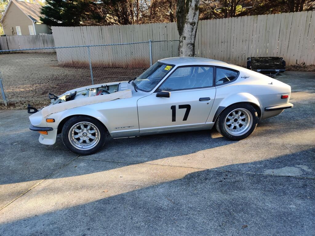

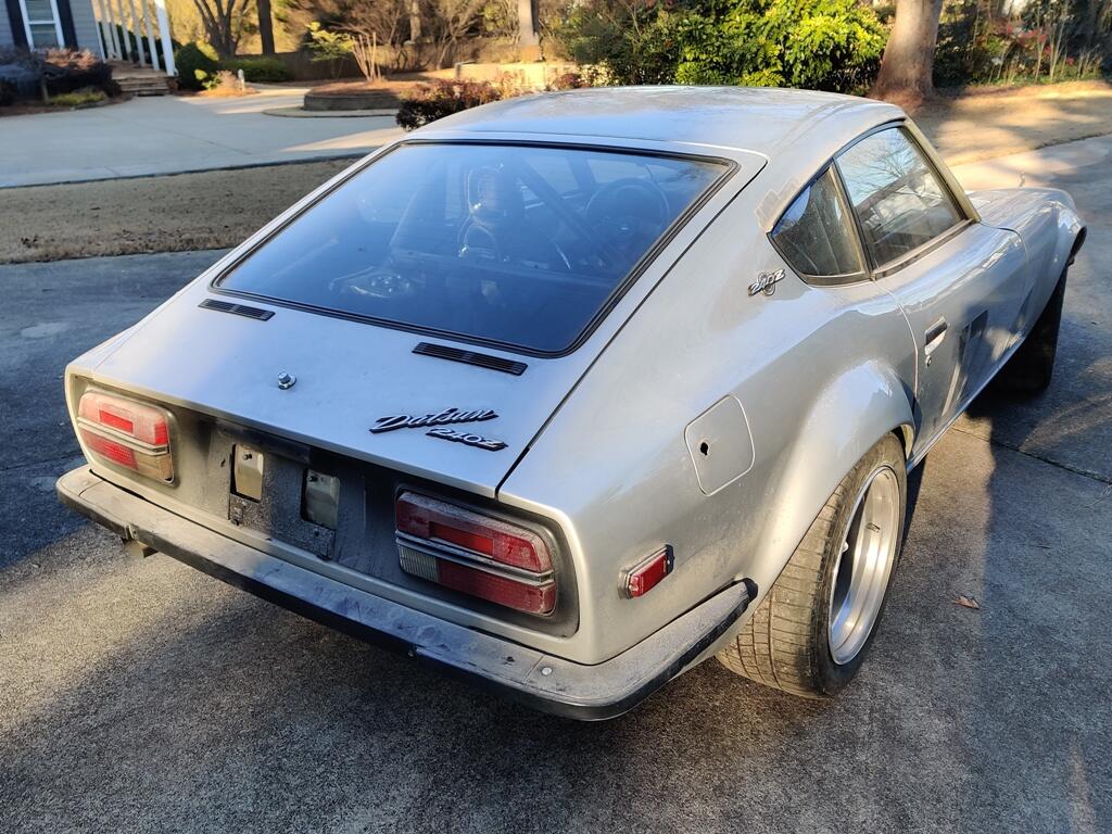

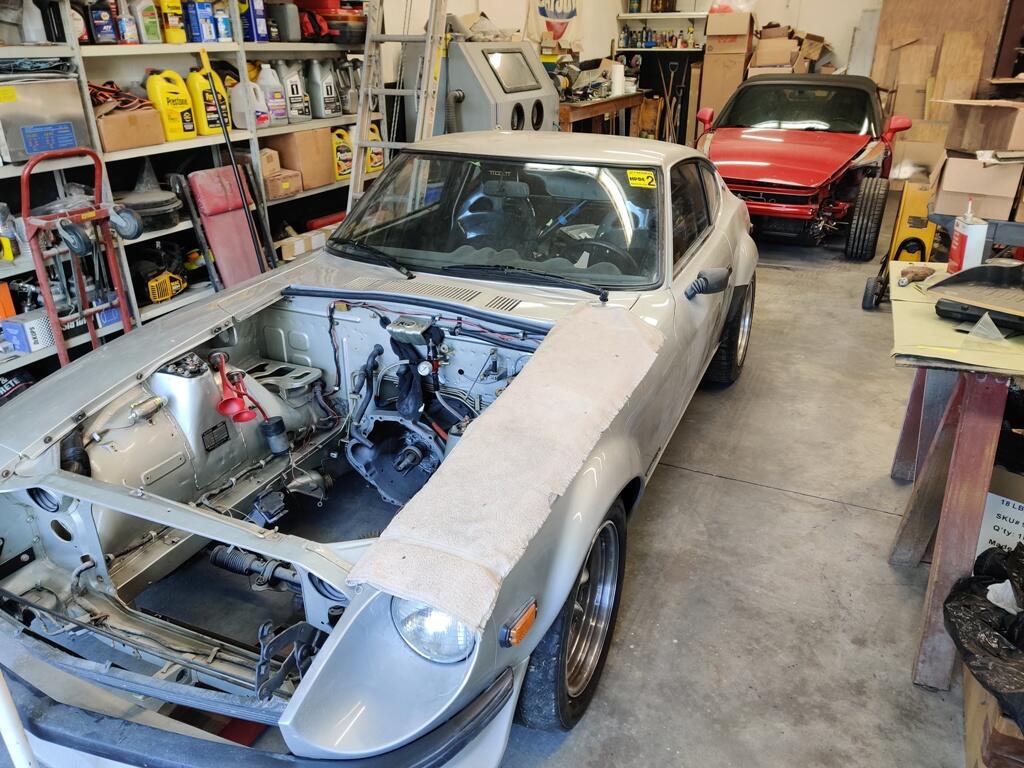

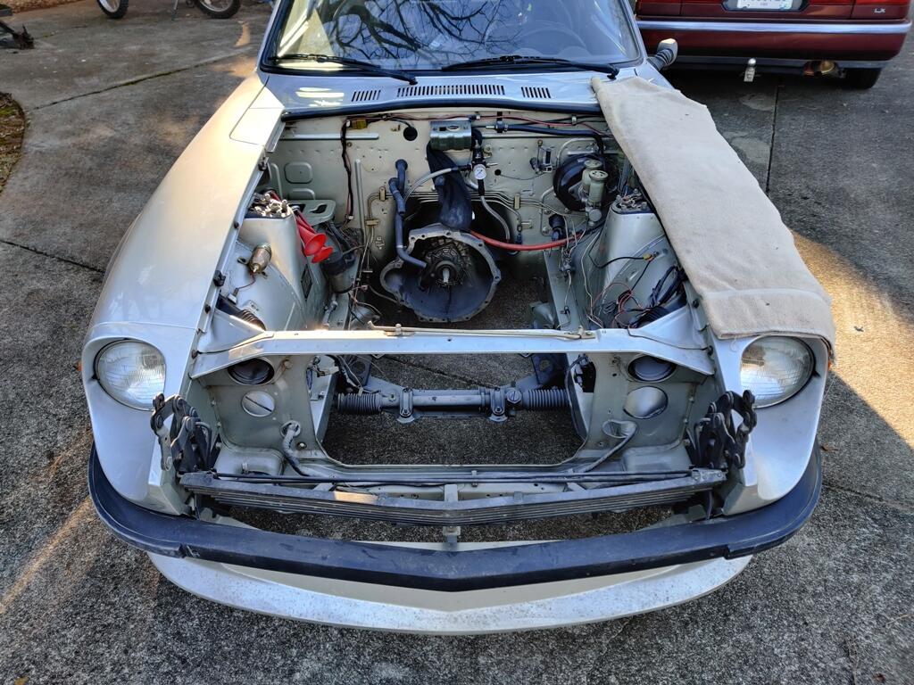

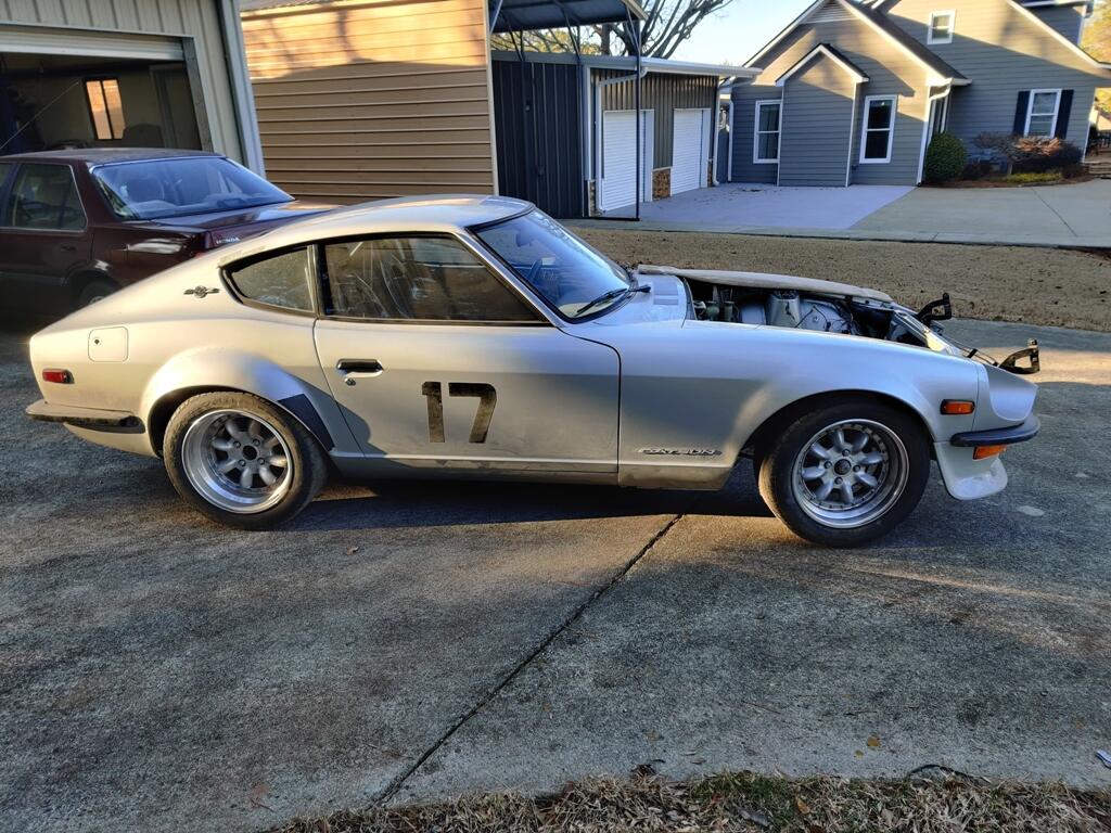

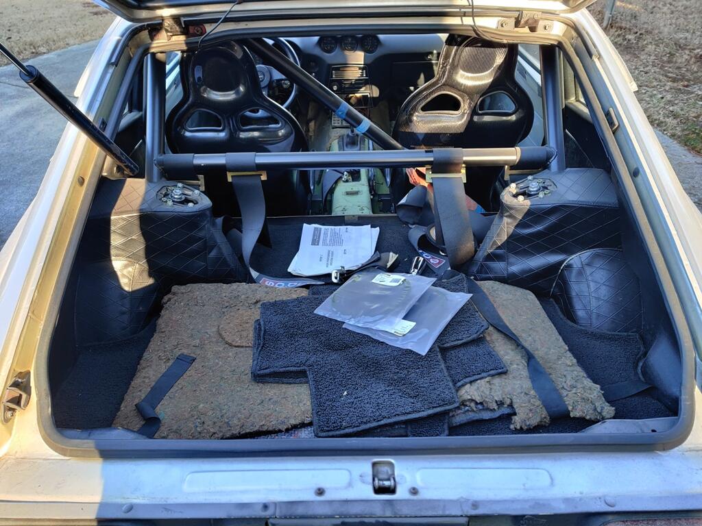

This past weekend, I moved all of my project cars around to facilitate getting started on the "track car" - my 240Z with a prod date of 12/70:
I blew the motor up at Road Atlanta 9 years ago.  It took many of those years to get a replacement, but I have that sitting in the corner of the shop.
While I had the project cars out of the "shop", I organized some things and put a bunch of parts away in boxes and on shelves.  Then I put them back in the garage.  My order of attack will be to bring this 240Z back to life, then repair my wrecked 2004 Honda S2000, and then build the 1970 510.  Unsure how long it will take, but going to guess 6 months or so on the Z.  Hopefully less than a year on the S2000.  And, I really don't know how long for the 510:
Probably several years.
