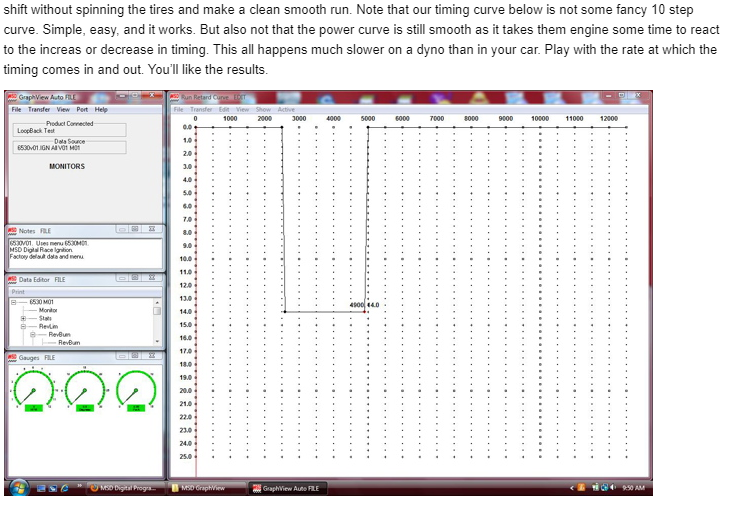

I posted in this thread about using an MSD or Crane module but I don't think that their programmability is very complex.  Their ad copy is deceptive.  Here is a system that does what I was thinking of.  Lots of ways to get spark control, especially in today's programmed world.  Somebody has probably developed an app that will let you use a "phone" to run your engine.

I found an article that shows how MSD's ads are deceptive.  They describe set-point timing retarding as "curves".  They're not curves.  They're just rebranding their rev-limiter technology.  Pretty sad, MSD used to be top of the game.
https://bangshift.com/general-news/tech-stories/engine-tech-how-a-programmable-ignition-can-make-anyone-look-like-a-pro/
