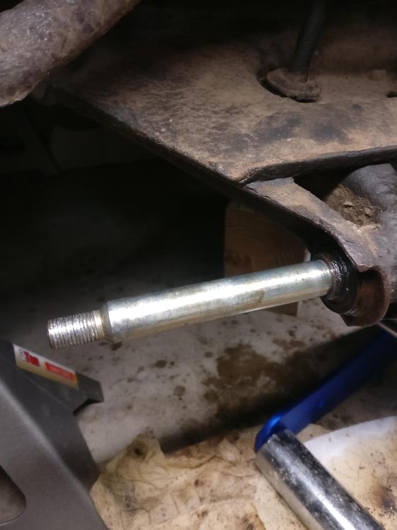

Also started removing the spindle pins. Used the stack of washer approach which was working really well, but then the threads on the end of the spindle pin started to strip out. Seems to be coming out very slowly with wide punch and a few wacks of the hammer. Any risks to hammering this thing out? And/or is there a better way to do this?
Transmissions are drained and stored for yrs without any problems, you'll be okay.
Spindle pins, lots written on the subject, if yours are moving you're in luck.  You will need new pins now that the threads are damaged, try and get penetrating fluid in there and as long as the pin keeps moving well just keep hammering.  If it gets stuck hammer it back to where it was moving, more penetrant, use pair of Visegrips to spin it then keep wacking it in the original direction, take your time.
