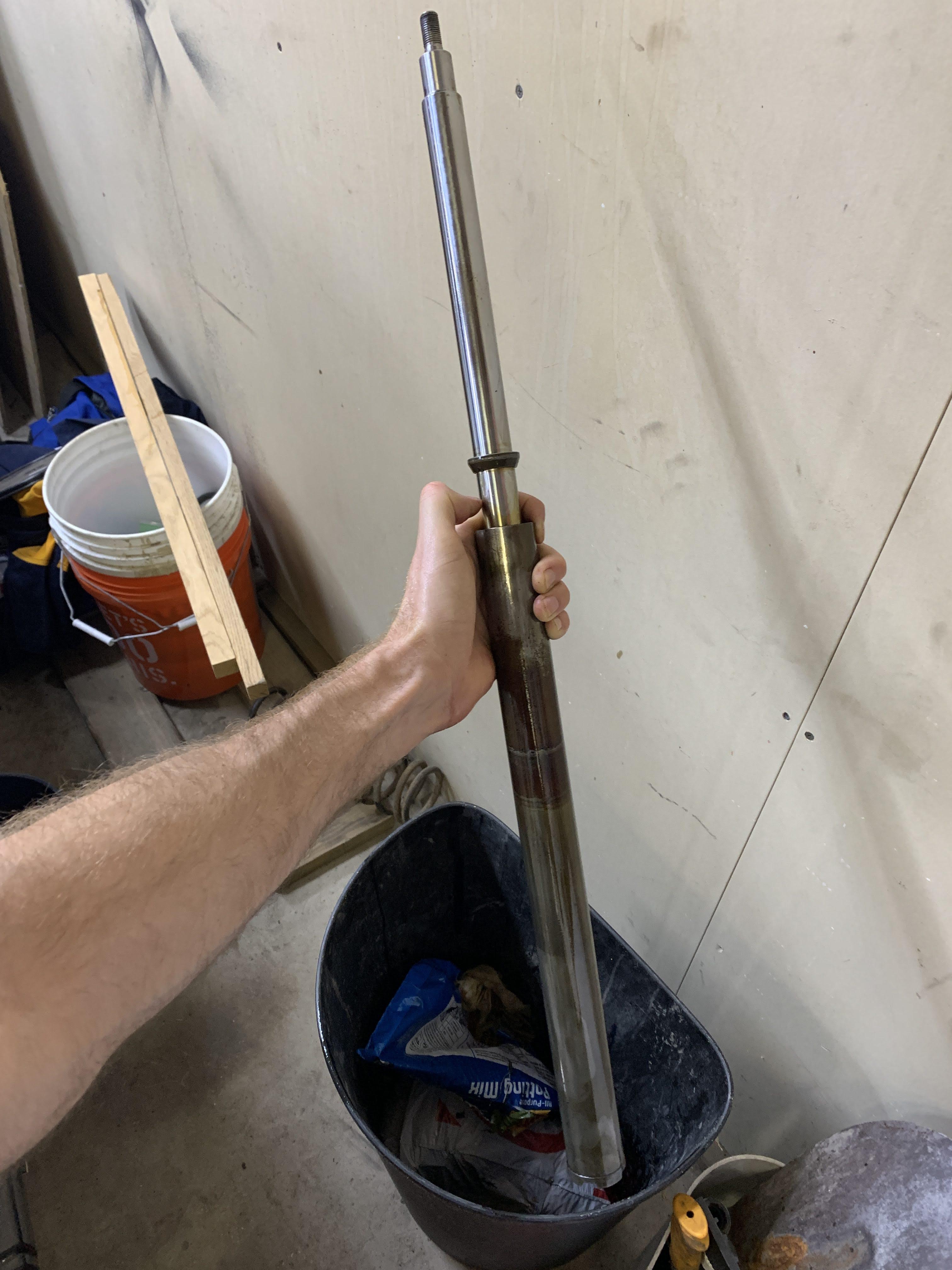

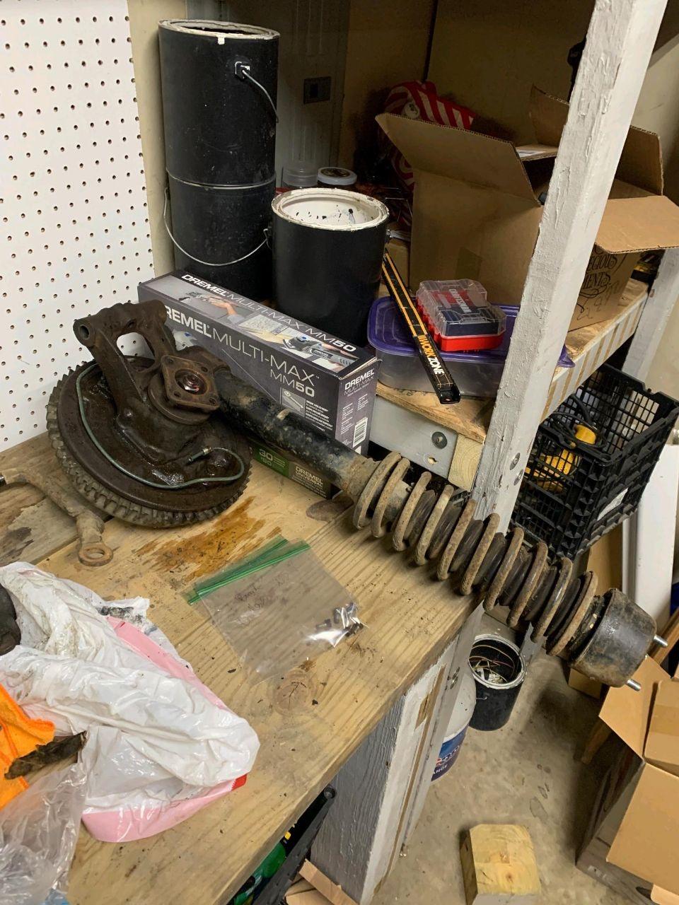

Replacing the worn out struts first. Went to pull the first one last night and the entire thing came out in pieces. Sprayed the whole bench with oil when it came apart ? . No idea what brand these are because there are no markings or part numbers whatsoever.
Is it still best practice to backfill the strut housing with oil to prevent rust? And if yes, what kind of oil is recommended?

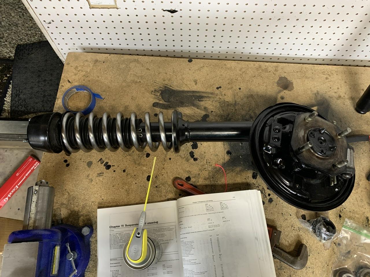

Making process getting everything back onto the car just before the end of the driving season here. Excited to get it all finished and put some miles on this year. Figured I would post a quick before and after of the suspension reassembly.
Before
After

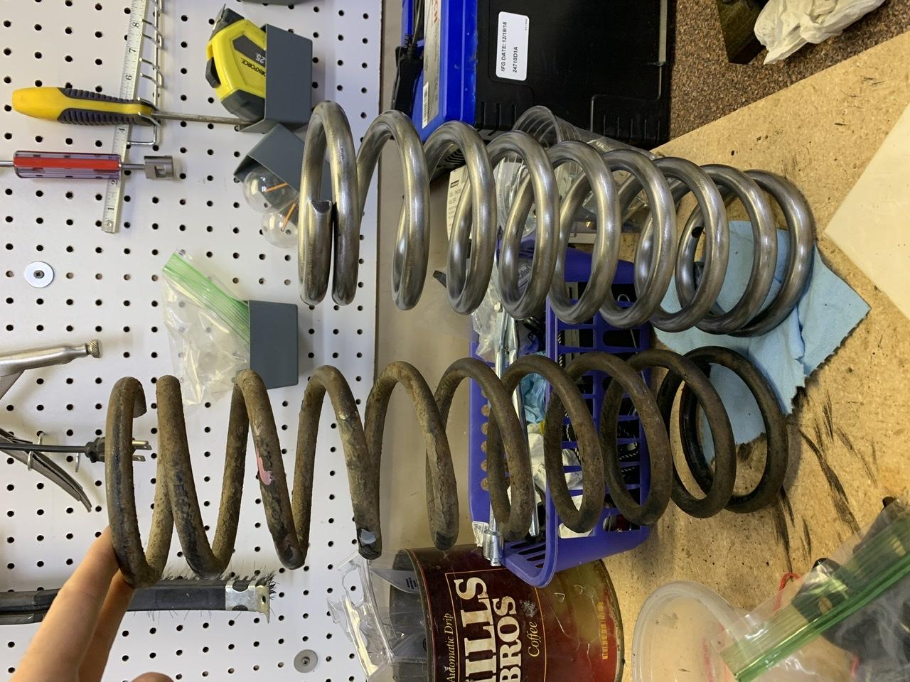

Newly refinished MSA linear springs vs old stock springsEA6768E0-3016-467B-81C3-D3CB4C543E69.jpeg

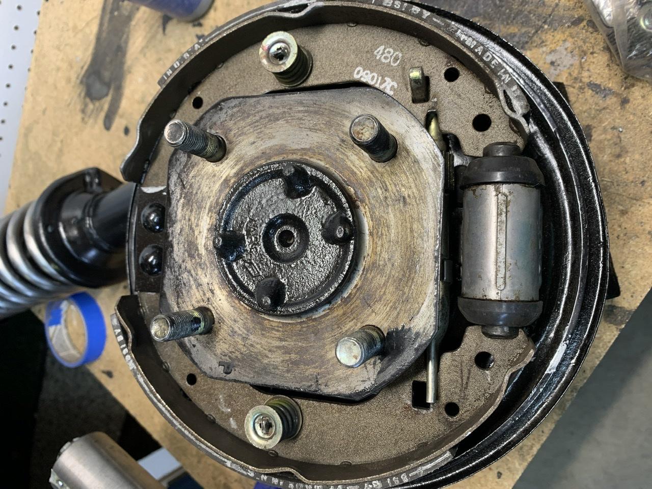

Reassembled Brake drums
