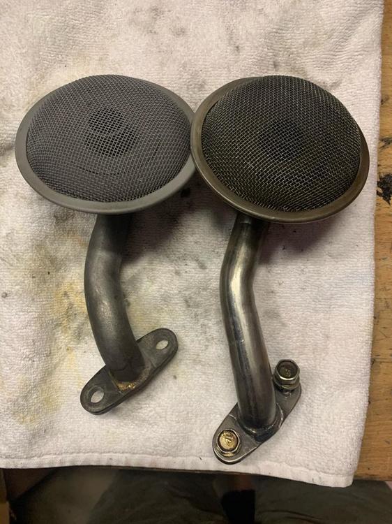

February 12, 20205 yr comment_592493 hmmm, you have gone this far, if it was me I would get the pickup that is designed for the pan being used if its different. Not saying it would not be fine, but why bother if you can get the right part. Edited February 12, 20205 yr by Dave WM Link to comment https://www.classiczcars.com/forums/topic/63127-l28-full-rebuild-assembly/?&page=13#findComment-592493 Share on other sites More sharing options...
February 12, 20205 yr comment_592495 The right combo is a lot farther away, a good 4 or 5 inches. I would want the magnet tipped plug in the "pool" but do what you want. Edited February 12, 20205 yr by siteunseen Link to comment https://www.classiczcars.com/forums/topic/63127-l28-full-rebuild-assembly/?&page=13#findComment-592495 Share on other sites More sharing options...
February 12, 20205 yr comment_592496 And I just realized that there is an indentation in the pan for the pickup's base. Learned something new today now I can go to sleep. Link to comment https://www.classiczcars.com/forums/topic/63127-l28-full-rebuild-assembly/?&page=13#findComment-592496 Share on other sites More sharing options...
February 12, 20205 yr Author comment_592497 hmmm, you have gone this far, if it was me I would get the pickup that is designed for the pan being used if its different. Not saying it would not be fine, but why bother if you can get the right part.Dave, I tend to agree with you. Now I need to find one because they appear out of stock at all the typical Z retailers. If anyone wants to sell an extra or knows where one is available for sale let me know. I’ll start digging. All stop....for now. Sent from my iPhone using Tapatalk Link to comment https://www.classiczcars.com/forums/topic/63127-l28-full-rebuild-assembly/?&page=13#findComment-592497 Share on other sites More sharing options...
February 12, 20205 yr Author comment_592499 The right combo is a lot farther away, a good 4 or 5 inches. I would want the magnet tipped plug in the "pool" but do what you want. Thanks Cliff..great point. Sent from my iPhone using Tapatalk Link to comment https://www.classiczcars.com/forums/topic/63127-l28-full-rebuild-assembly/?&page=13#findComment-592499 Share on other sites More sharing options...
February 13, 20205 yr Author comment_592568 Got a replacement on its way from Ebay $39. Sent from my iPhone using Tapatalk Link to comment https://www.classiczcars.com/forums/topic/63127-l28-full-rebuild-assembly/?&page=13#findComment-592568 Share on other sites More sharing options...
February 24, 20205 yr Author comment_593077 So for future reference here’s what a ZX and Z oil pick-up tube look like side by side. Approximately 1.5” longer on the ZX one. Oil pan going on today. Sent from my iPhone using Tapatalk Link to comment https://www.classiczcars.com/forums/topic/63127-l28-full-rebuild-assembly/?&page=13#findComment-593077 Share on other sites More sharing options...
