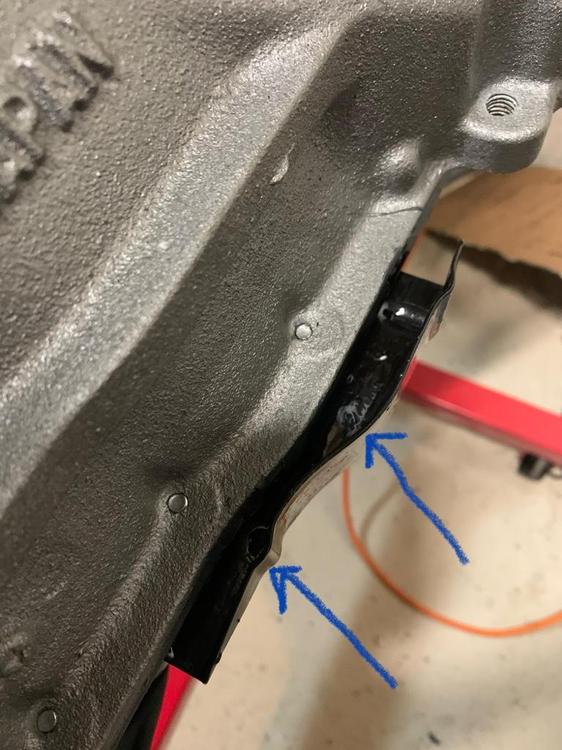

March 5, 20205 yr Author comment_593731 Does anyone know what this flange is for? It’s part of those reinforcing metal bands that attach to the oil pan bolts. Am asking because I’m looking at headers and I’m seeing that it may interfere with the MSA 3-2 headers. I don’t know which headers I’m going to buy 6-1 vs 3-2.....ugh! I realized there are many options. If you have any insights on header choices I’d appreciate opinions as well. In this video this guy had to remove this thing on the oil pan, which is fine but I’d prefer to know what is was intended for before I do it or if I could find a better option. Sent from my iPhone using Tapatalk Link to comment https://www.classiczcars.com/forums/topic/63127-l28-full-rebuild-assembly/?&page=17#findComment-593731 Share on other sites More sharing options...
March 5, 20205 yr comment_593733 I thought it was a heat shield. Link to comment https://www.classiczcars.com/forums/topic/63127-l28-full-rebuild-assembly/?&page=17#findComment-593733 Share on other sites More sharing options...
March 5, 20205 yr comment_593743 I've read that too. Keeps the heat from the exhaust manifold from burning up your oil pan gasket or hardening from constant heat would be more like it. Link to comment https://www.classiczcars.com/forums/topic/63127-l28-full-rebuild-assembly/?&page=17#findComment-593743 Share on other sites More sharing options...
March 5, 20205 yr comment_593744 On 3/5/2020 at 4:01 PM, Av8ferg said: Does anyone know what this flange is for? It’s part of those reinforcing metal bands that attach to the oil pan bolts. Am asking because I’m looking at headers and I’m seeing that it may interfere with the MSA 3-2 headers. I don’t know which headers I’m going to buy 6-1 vs 3-2.....ugh! I realized there are many options. If you have any insights on header choices I’d appreciate opinions as well. In this video this guy had to remove this thing on the oil pan, which is fine but I’d prefer to know what is was intended for before I do it or if I could find a better option. Sent from my iPhone using Tapatalk My 6 to 1 MSA header barely hit my 5 speed transmission. Had to grind some aluminium off the transmission so be aware of that. Link to comment https://www.classiczcars.com/forums/topic/63127-l28-full-rebuild-assembly/?&page=17#findComment-593744 Share on other sites More sharing options...
March 5, 20205 yr comment_593757 My 6-3-2 MSA header worked beautifully on both the mainly stock L26 (just ported) and highly modified L28. Never connected with anything other than high speed humps - as it does hang a bit low at the front, particularly if your car is lowered. That I also understood to be a heat-shield to protect your gasket. I did have to “adjust” it for the ZStory Race/Sport header and it’s a VERY solid bit of metal!! The lump hammer was out. Link to comment https://www.classiczcars.com/forums/topic/63127-l28-full-rebuild-assembly/?&page=17#findComment-593757 Share on other sites More sharing options...
March 6, 20205 yr Author comment_593763 On 3/5/2020 at 7:35 PM, siteunseen said: My 6 to 1 MSA header barely hit my 5 speed transmission. Had to grind some aluminium off the transmission so be aware of that. Well, that kind of sucks. I have a Z 5speed and not a ZX tranny. Seems like it might not have that clearance issue but good to know there will be some challenges putting in a header. I read mostly good feedback on that 6-1 header. Probably the route I’m going. Sent from my iPhone using Tapatalk Link to comment https://www.classiczcars.com/forums/topic/63127-l28-full-rebuild-assembly/?&page=17#findComment-593763 Share on other sites More sharing options...

March 6, 20205 yr comment_593774 Mine is the regular wide B that touched. Came from the factory in my '77. 240 fit fine, no issues with that 5 speed. Link to comment https://www.classiczcars.com/forums/topic/63127-l28-full-rebuild-assembly/?&page=17#findComment-593774 Share on other sites More sharing options...
March 7, 20205 yr Author comment_593870 On 3/6/2020 at 10:10 AM, siteunseen said: Mine is the regular wide B that touched. Came from the factory in my '77. 240 fit fine, no issues with that 5 speed.So Cliff are you saying I should not have a transmission clearance problem with the MSA 6-1 header (2.5” flange)? Two other concerns with this header I’ve read is that it may interfere with the oil pan heat shield. The other was it hangs really low on the car. I will slightly lower my car but I’m not one of those people that have those car dragging sparks down the road like I’m 19 with stereo blasting rap music rattling my rear hatch. I have what seems like 20 speed bumps in my neighborhood (hate them). I don’t feel like having my header hitting all the time. Sent from my iPhone using Tapatalk Link to comment https://www.classiczcars.com/forums/topic/63127-l28-full-rebuild-assembly/?&page=17#findComment-593870 Share on other sites More sharing options...
