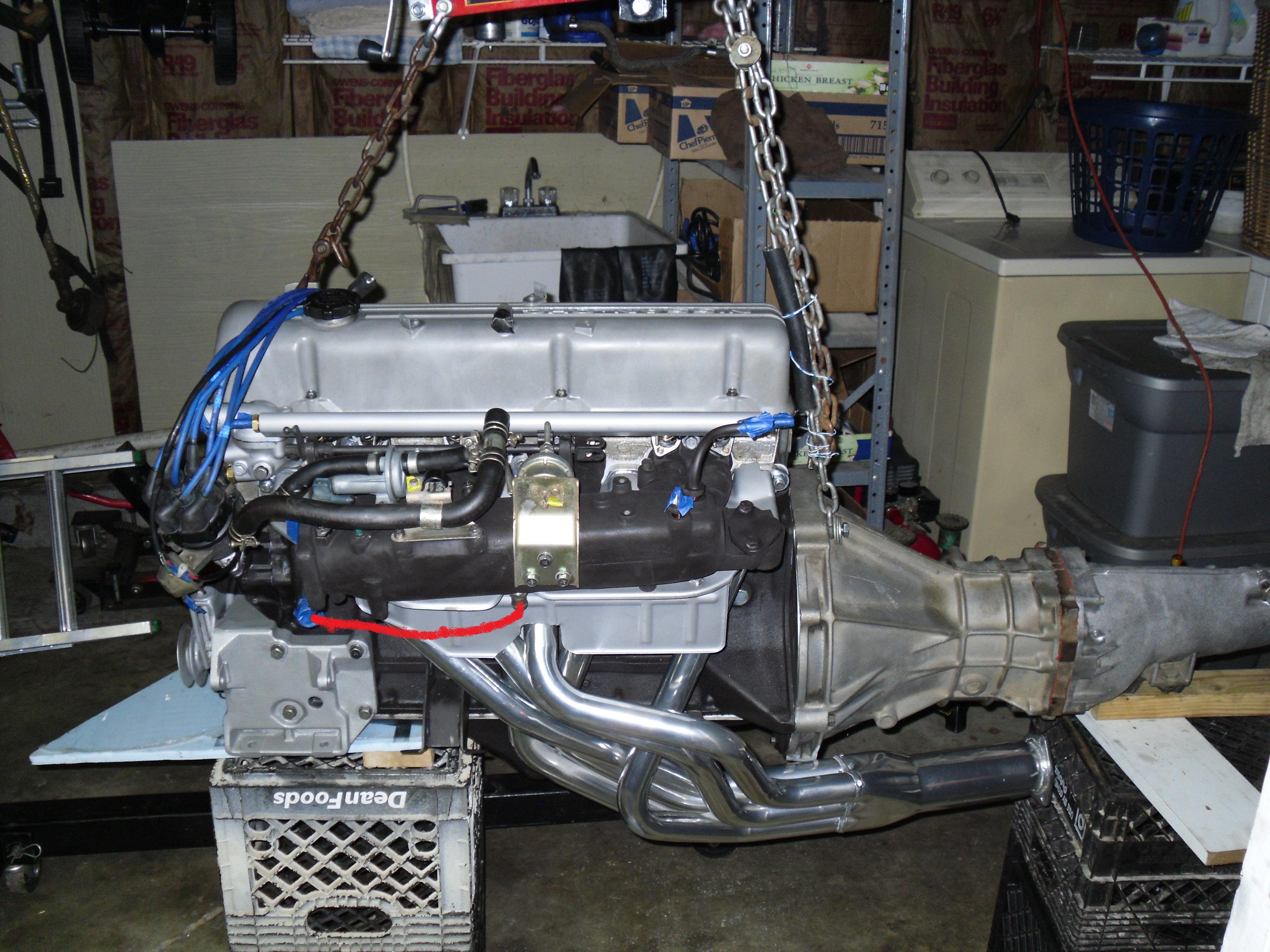

You will really like the header at least I do.  I put them on both my Zs and the heat reduction in the engine bay is incredible.  With that header your fuel rail will feel cool to the touch after running the car.
Here's my 280's motor before I put it in.
Go to Harbor freight and get an load leveler.  With one of those you can do it by yourself.  I needed a little push to do it though, it's intimidating having that big of a thing hanging over your car.  Thanks to Jeff G 78 and RossiZ again for the "push".
Looks good Cliff! So I noticed you made a custom cutout for one of the heat shields? With the coated headers has it mitigated the L28 hot start problems these cars have. My ZX engine came with that odd over the valve cover blower which I have no intention of putting back on. I was considering putting an adhesive heat shield tape under the metal stock heat shield to slow the heat transfer a bit but if these coated headers really reduce the heat maybe its not required. I’m going without the bung on the headers. Does everyone agree they should fit in the P79 just like the N47 head?
Yes, the header for a '77 N47 is what you need with that P79.  I've never had a hot restart problem that I can remember, even back in the '80s when I first had a Z.  Soooo with these headers you definitely will not especially with your aluminum fuel rail. :beer:

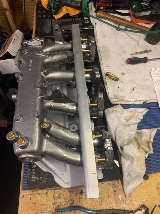

I still need to make a few adjustments to my custom rail (copy of yours). The Rail came 24” which is too long. I need to cut it down to about 21” and retap the ends.
