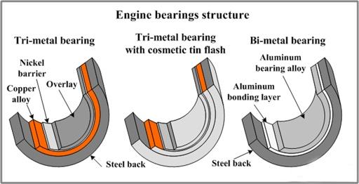

November 16, 20195 yr comment_587703 3 hours ago, Av8ferg said: Rod bearings arrived too. I purchased tri-metal standard bearings made by Taiho $38. Tried to buy the Clevite 77 P- series but they are no longer available anywhere in STD sizes for Rods. Sent from my iPhone using Tapatalk Are the "P" series harder than the "A" series? https://whiteheadperformance.com/product/clevite-77-trimetal-rod-bearings-cb-966p-l24-l26-l28-l28et-datsun-240z-260z-280z-280zx/ Link to comment https://www.classiczcars.com/forums/topic/63127-l28-full-rebuild-assembly/?&page=3#findComment-587703 Share on other sites More sharing options...
November 16, 20195 yr Author comment_587705 Are the "P" series harder than the "A" series? https://whiteheadperformance.com/product/clevite-77-trimetal-rod-bearings-cb-966p-l24-l26-l28-l28et-datsun-240z-260z-280z-280zx/ P-series are Tri-metal bearings. They have a steel backing, copper middle and aluminum surface. They are capable of handling a higher RPM than the A-series and are better on performance engines I’ve read. The A series are all aluminum. Sent from my iPhone using Tapatalk Link to comment https://www.classiczcars.com/forums/topic/63127-l28-full-rebuild-assembly/?&page=3#findComment-587705 Share on other sites More sharing options...
November 16, 20195 yr comment_587723 Did you ever get the crankshaft end play worked out? Link to comment https://www.classiczcars.com/forums/topic/63127-l28-full-rebuild-assembly/?&page=3#findComment-587723 Share on other sites More sharing options...
November 16, 20195 yr comment_587727 P-series are Tri-metal bearings. They have a steel backing, copper middle and aluminum surface. They are capable of handling a higher RPM than the A-series and are better on performance engines I’ve read. The A series are all aluminum. Sent from my iPhone using Tapatalk I think top layer in tri metal is lead or a lead alloy, not aluminium. Link to comment https://www.classiczcars.com/forums/topic/63127-l28-full-rebuild-assembly/?&page=3#findComment-587727 Share on other sites More sharing options...
