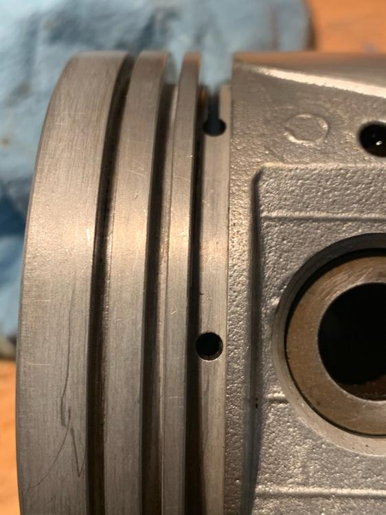

December 10, 20195 yr Author comment_589033 My rings grooves are looking good now. Needed a light brush up with a brass brush to get the hardened stuff totally out. Sent from my iPhone using Tapatalk Link to comment https://www.classiczcars.com/forums/topic/63127-l28-full-rebuild-assembly/?&page=7#findComment-589033 Share on other sites More sharing options...

December 13, 20195 yr Author comment_589186 So, I measured my ring gaps yesterday and they are a little bigger than the FSM published. Book recommends .0098 to .0157 with a wear limit of .0394. The How to Rebuild books recommends .012 to .017. These are for the compression ring. See pics of pages in pubs. My ring gap at the top, 3/4” down the bore was .019 on two rings and .018 on the rest. I the grabbed my old rings to see where they were. .021 to .022. So my ring gap is bigger than the FSM and rebuild book. Is this a concern? I think no, but I thought I get a consensus. Questions: 1. Is my Ring gap okay?2. the rebuild book says to look for a “pip” or dot marking on the ring and make sure it’s facing up. I don’t have a dot but have and “S” on mine. I’m assuming this is a “pip” Mark. Even the instruction that came with the stock Nissan standard rings mention a dot mark but it’s not on the rings. See pics. 3. Back to crankshaft bearings. When reading the FSM last night about ring install I saw this paragraph about crank bearings. It says bearing #4 is different (plainly obvious, it’s flanged) and all the rest are the same and then the next sentence says 1 and 7 are the same. Are they same as 2,3,5,6 too? I did notice that when I installed my bearings #1 seemed a more little narrow compared to the flange it lays in. I’m wondering if I mixed up #1 with another 2,3,5 or 6 bearing. Sent from my iPhone using Tapatalk Link to comment https://www.classiczcars.com/forums/topic/63127-l28-full-rebuild-assembly/?&page=7#findComment-589186 Share on other sites More sharing options...
