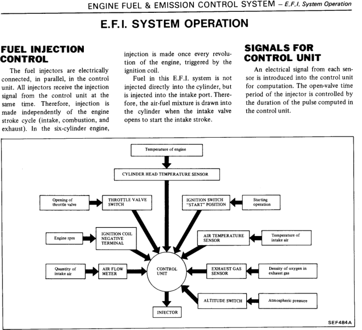

A 280zx has a analog computer, it computes an output signal from many different signals it gets from de sensors to run the engine.. but it does not have a actual ECU.. (I'm glad it has not!)  this system was and can be still reliable.  (an ECU has a clock signal and a processor, this can not be found in any 280zx..)

Well this EFI guy can tell you that by 1983, the ECU's WERE computer controlled.
6801 microcontroller running at 4MHz
I don't know when the transition officially occurred, but by 83, they were programmed devices.
Are we mixing the ECCS system with the EFI sysstem?  The ECCS system was used on the turbo engines.  Nissan went full ECCS on all engines in 1984, from my understanding, at least for the Z cars.
Google found me an old article about it.  https://trid.trb.org/view/183990
