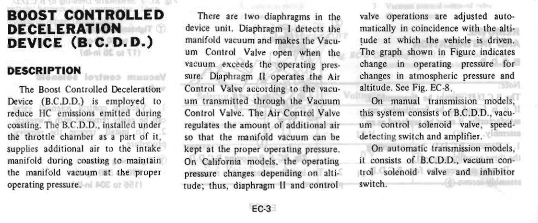

November 13, 20195 yr comment_587607 On 11/13/2019 at 6:21 PM, AutocraftCollision said: When the engine warms up, the idle rises to 2100rpm. It stays there until coming to a nearly complete stop(~3mph), where it suddenly drops to 900. Is it a 5 speed or automatic? Your description doesn't quite fit. You're blending driving and idling together. Why would you be "at idle" going over 3 mph? Maybe add some details to what's happening? Hanging idle speed is pretty common but has several possible causes. Her's a service manual link. Link to comment https://www.classiczcars.com/forums/topic/63151-79-280zx-high-idle-when-warm/#findComment-587607 Share on other sites More sharing options...

November 15, 20195 yr comment_587649 The guys were right, sounds like the BCDD. But the symptoms are odd. Usually they just stay at high idle, they don't correct on their own. Seems like yours might just be gummed up. It's the weird thing hanging under the throttle body. Later ZX's had them on the manifold. Link to comment https://www.classiczcars.com/forums/topic/63151-79-280zx-high-idle-when-warm/#findComment-587649 Share on other sites More sharing options...
November 15, 20195 yr comment_587682 I tried to find that image Zed Head but couldn't, thank you. When I lifted off the clutch pedal to coast up to a stop mine would stick around 1,500 to 2,000 rpm for about 15 seconds then drop down to normal. I adjusted the BCDD in just a quick ride through my neighborhood. When you get that locking clip thing off leave it at home and find some stop signs. Leave the hood loose too. Turn it one way and see if it gets better or worse. It's really easy. Mine also had a sticky gas pedal feel that would hang up or down. I cleaned the throttle body bottom under the throttle blade with a toothbrush and lacquer thinner. Link to comment https://www.classiczcars.com/forums/topic/63151-79-280zx-high-idle-when-warm/#findComment-587682 Share on other sites More sharing options...
