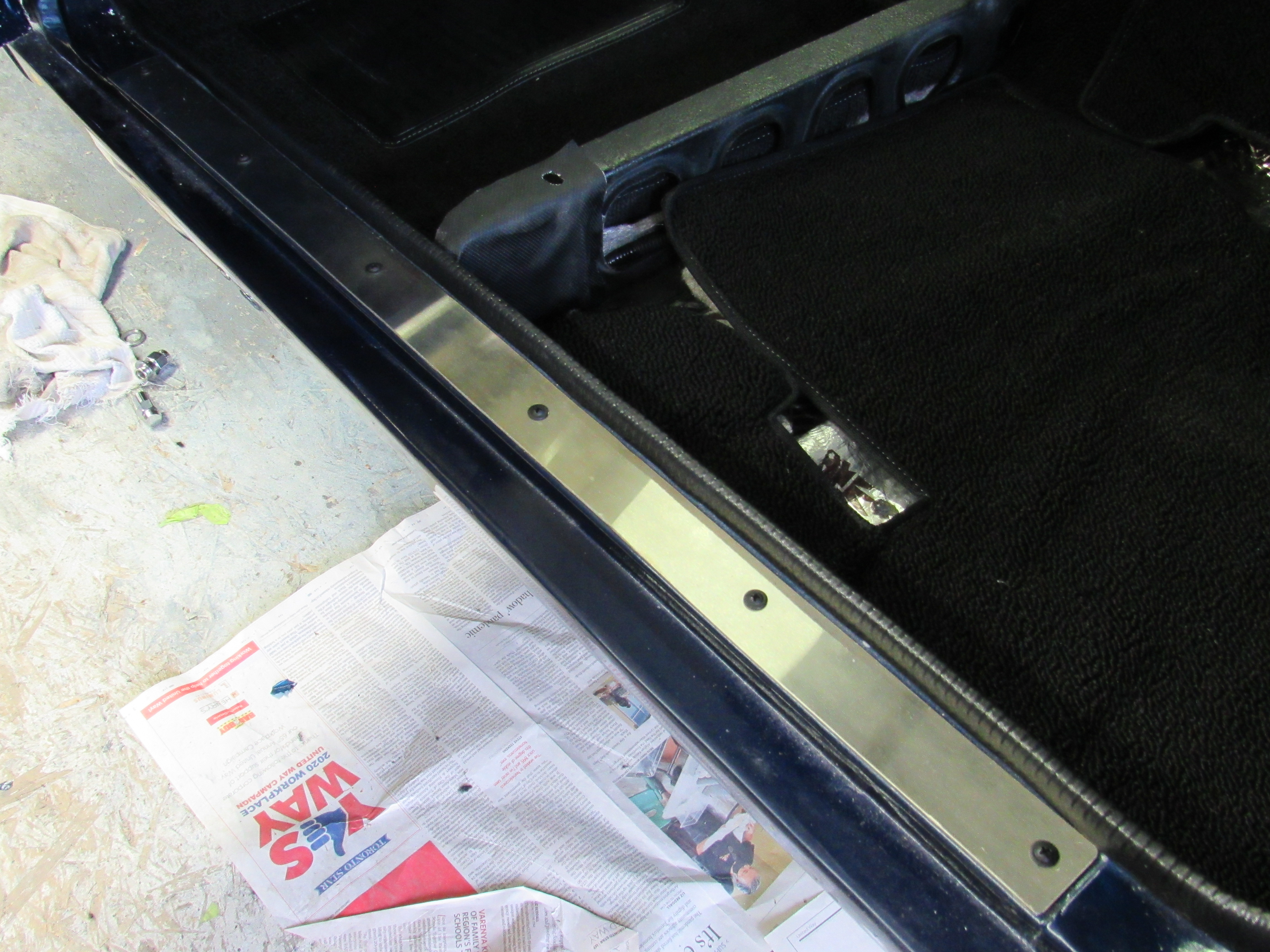

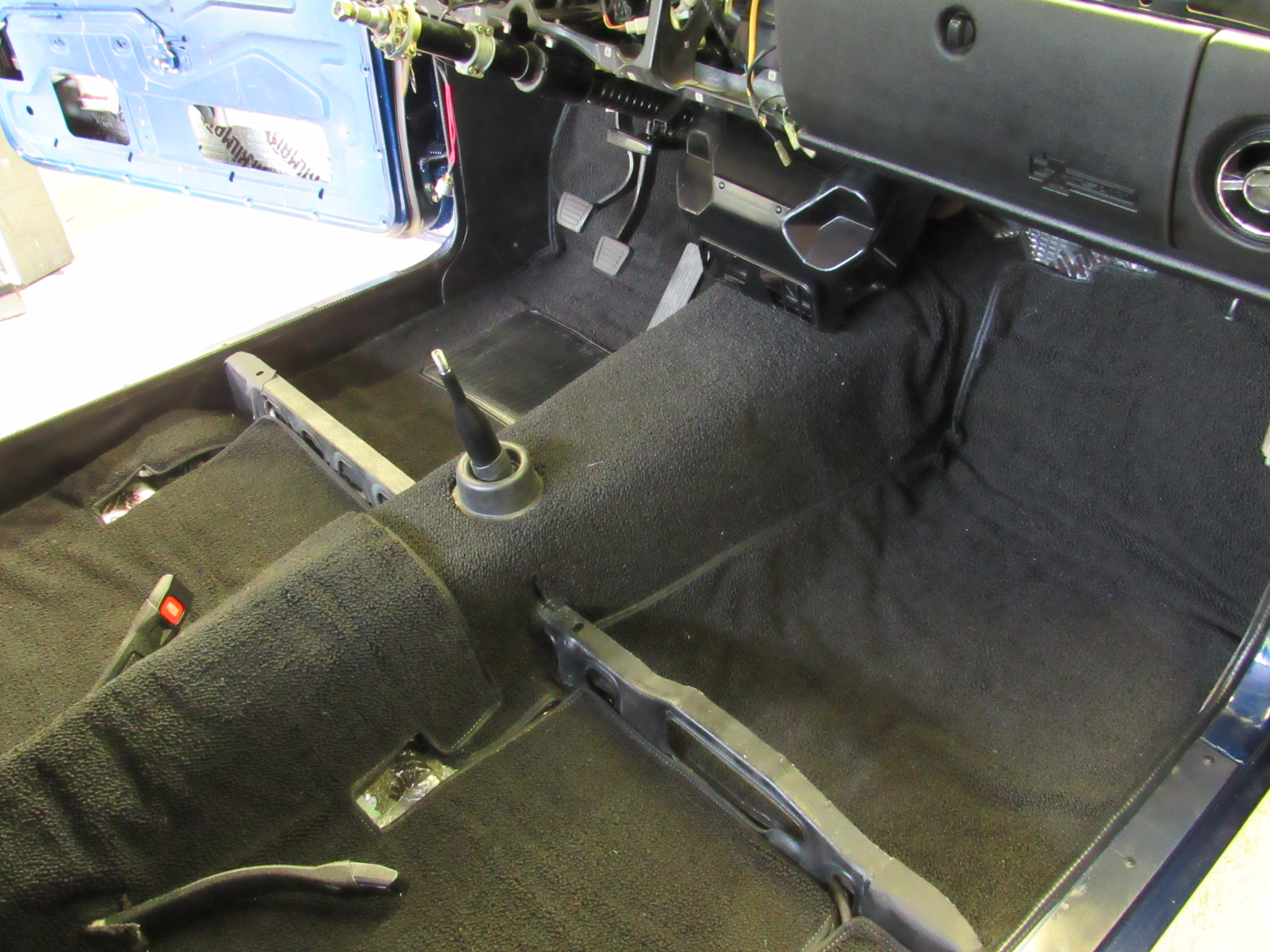

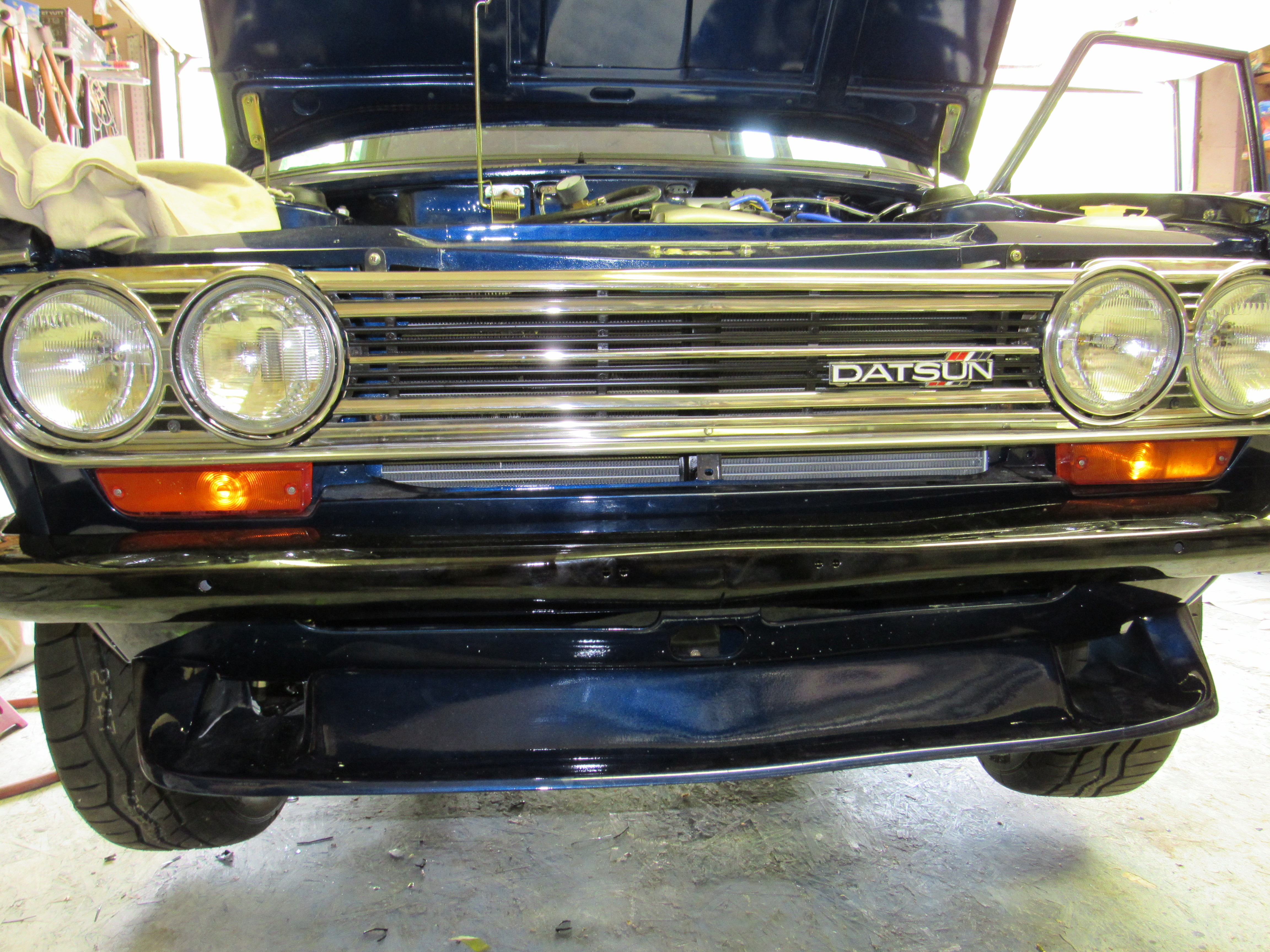

Have solved some problems and acquired others, fuel pump died on me so waiting a new to arrive soon, in the mean time  trying to finish the rest of the car. I had a set of 240z sunvisors on the self so tried them in the 510, they fit!  And fit perfectly, as if they might have been an possible option for Nissan.  Spoiler and front bumper are on, brakes and clutch are bled, the rear window is done, carpet kit is in (those wrinkles are not in the finished job).
Finished the SS threshold plates and installed the seats today, just need a fuel pump now.
