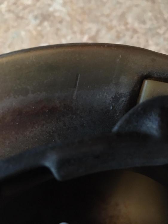

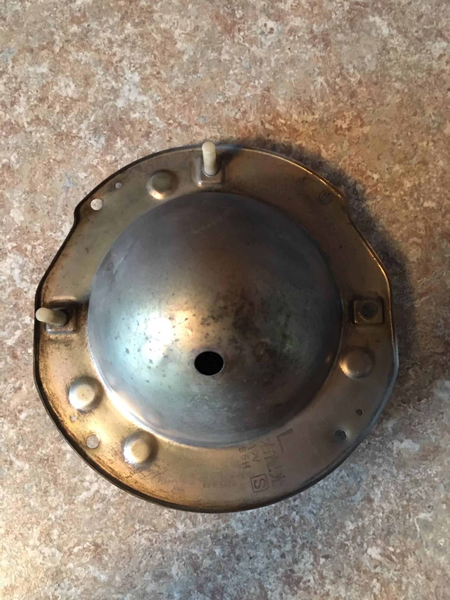

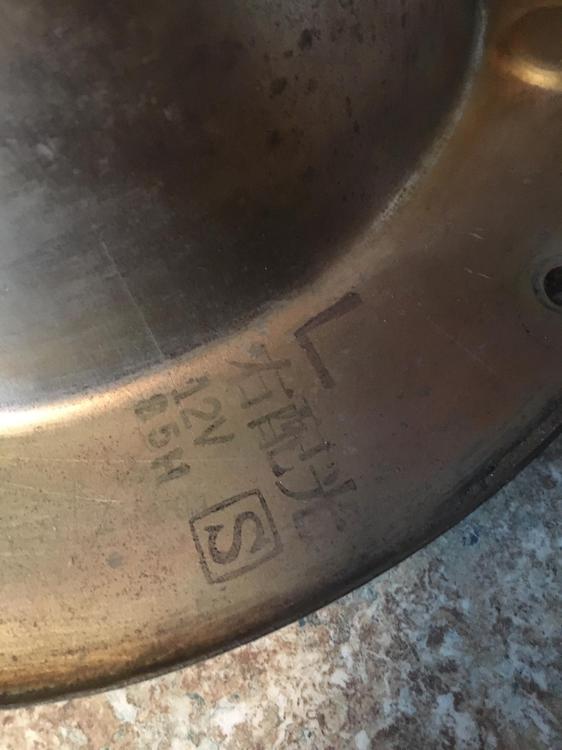

November 21, 20195 yr comment_588039 Mine have a stamp near the top R or L and this set has an ink stamp which would probably not be there after powder coating. With the two indents in the outer circle the one adjuster is at 12 o'clock. From this rear view the left will have the other adjuster on the left at 9 o'clock, the right will be at   3 o'clock. The one in the pic is the left. (drivers side) I hope that helps Link to comment https://www.classiczcars.com/forums/topic/63182-headlight-buckets-left-or-right/#findComment-588039 Share on other sites More sharing options...
November 21, 20195 yr Author comment_588041 Terp...Thanks...! EXACTLY what I needed...! Link to comment https://www.classiczcars.com/forums/topic/63182-headlight-buckets-left-or-right/#findComment-588041 Share on other sites More sharing options...

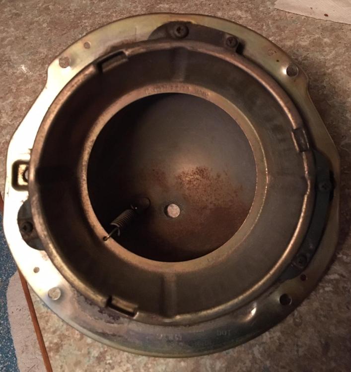

November 22, 20195 yr Author comment_588047 T...Could you take a pic of that same bucket from the front...? (do you call these "buckets...? I do...) Thanks...Ryals  Link to comment https://www.classiczcars.com/forums/topic/63182-headlight-buckets-left-or-right/#findComment-588047 Share on other sites More sharing options...
November 22, 20195 yr comment_588048 I call these buckets too. I call the outer part a "scoop" but there are many other names for either of these parts. Same part from the front. Same orientation - top of pic is up. Link to comment https://www.classiczcars.com/forums/topic/63182-headlight-buckets-left-or-right/#findComment-588048 Share on other sites More sharing options...
November 22, 20195 yr Author comment_588050 Thanks again, Terp...! Â Link to comment https://www.classiczcars.com/forums/topic/63182-headlight-buckets-left-or-right/#findComment-588050 Share on other sites More sharing options...

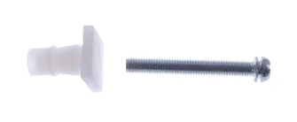

November 22, 20195 yr comment_588078 Off topic but relevant... Does anyone have a source for the adjustment screws and nylon backs? Link to comment https://www.classiczcars.com/forums/topic/63182-headlight-buckets-left-or-right/#findComment-588078 Share on other sites More sharing options...
November 22, 20195 yr comment_588086 1 hour ago, wheee! said: Off topic but relevant... Does anyone have a source for the adjustment screws and nylon backs? here you go, I got some last week and they fit perfectly. https://zcardepot.com/products/headlight-adjuster-screw-240z-260z-280z?_pos=1&_sid=e6342a0d3&_ss=r Link to comment https://www.classiczcars.com/forums/topic/63182-headlight-buckets-left-or-right/#findComment-588086 Share on other sites More sharing options...
