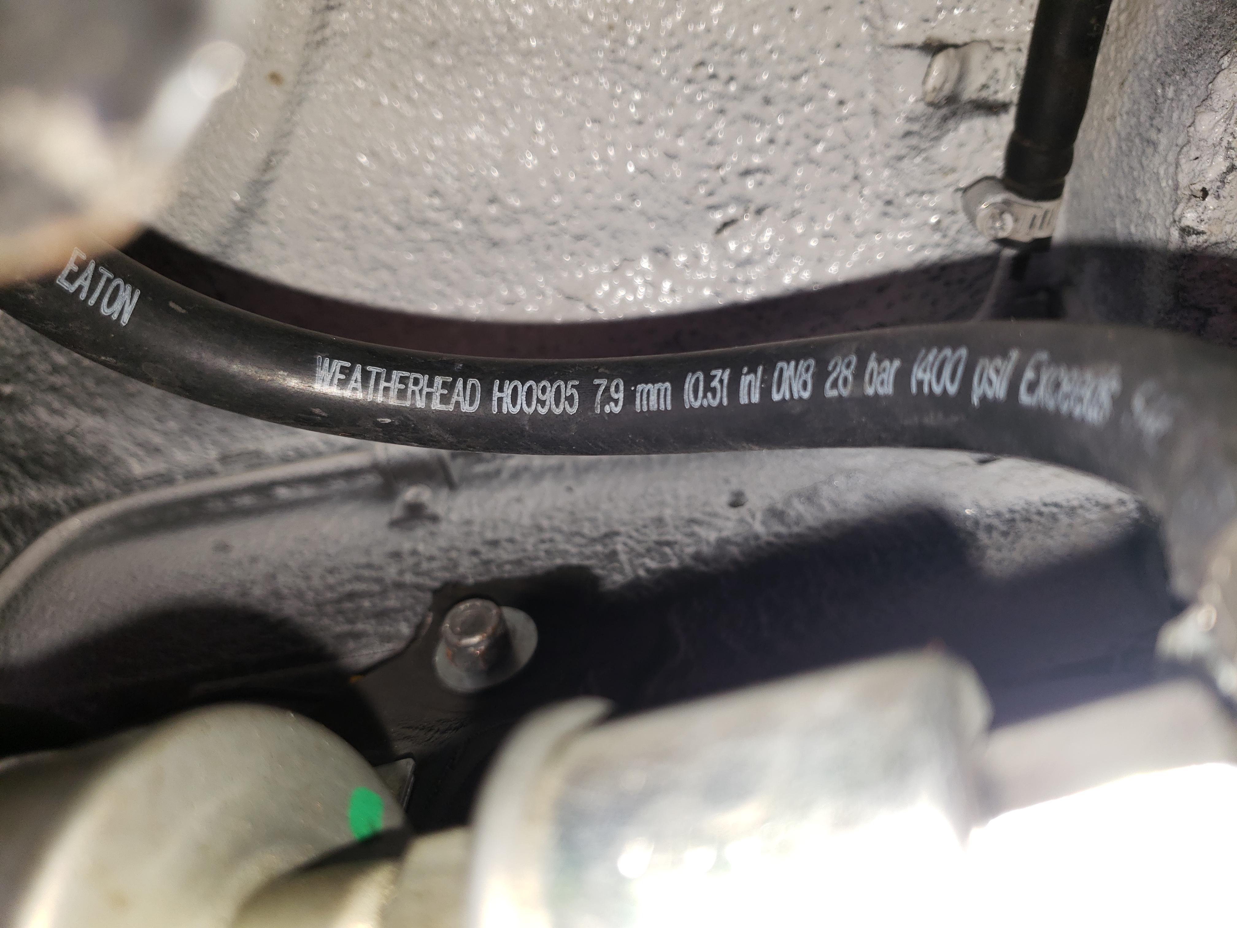

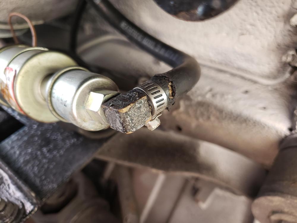

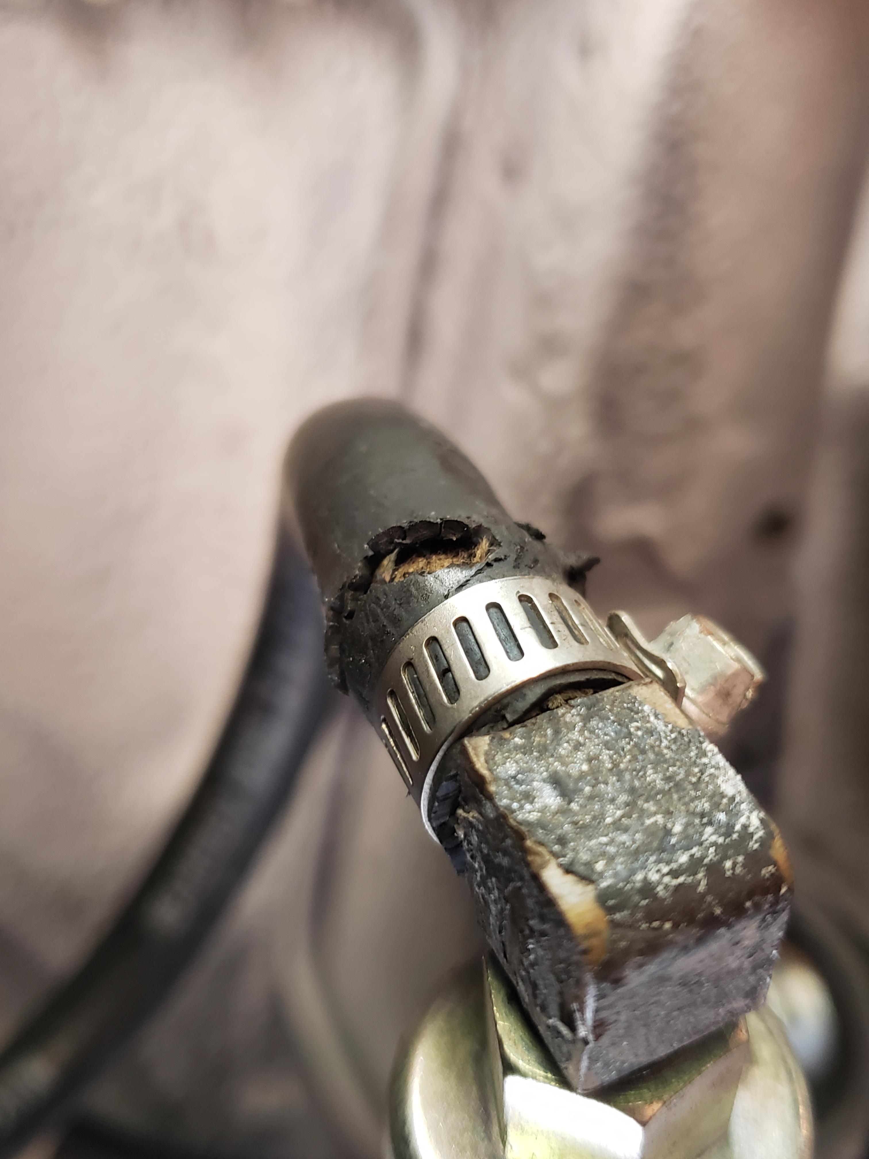

I recently noticed the gas hose that goes from the tank to the fuel pump rated 0.31 inch is beginning to crack. Should i consider replacing the hose and using other type of clamps to avoid this happening again?

That's hydraulic hose. Not fuel hose.
Replace all of it, with 1400 psi on it, asap.

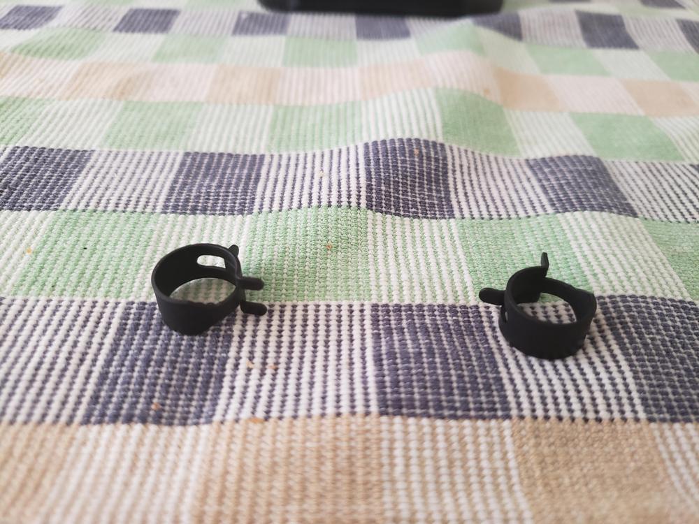

I have a spare hose and two clamps. Will this suffice?

Which  type of clamps? Any pictures?
  On 11/25/2019 at 1:03 PM, jalexquijano said:
I have a spare hose
No good , not fuel resistant.. buy a piece of tubing that is fuel-resistant.
Clamps with double ring, you see them on every Z engine!

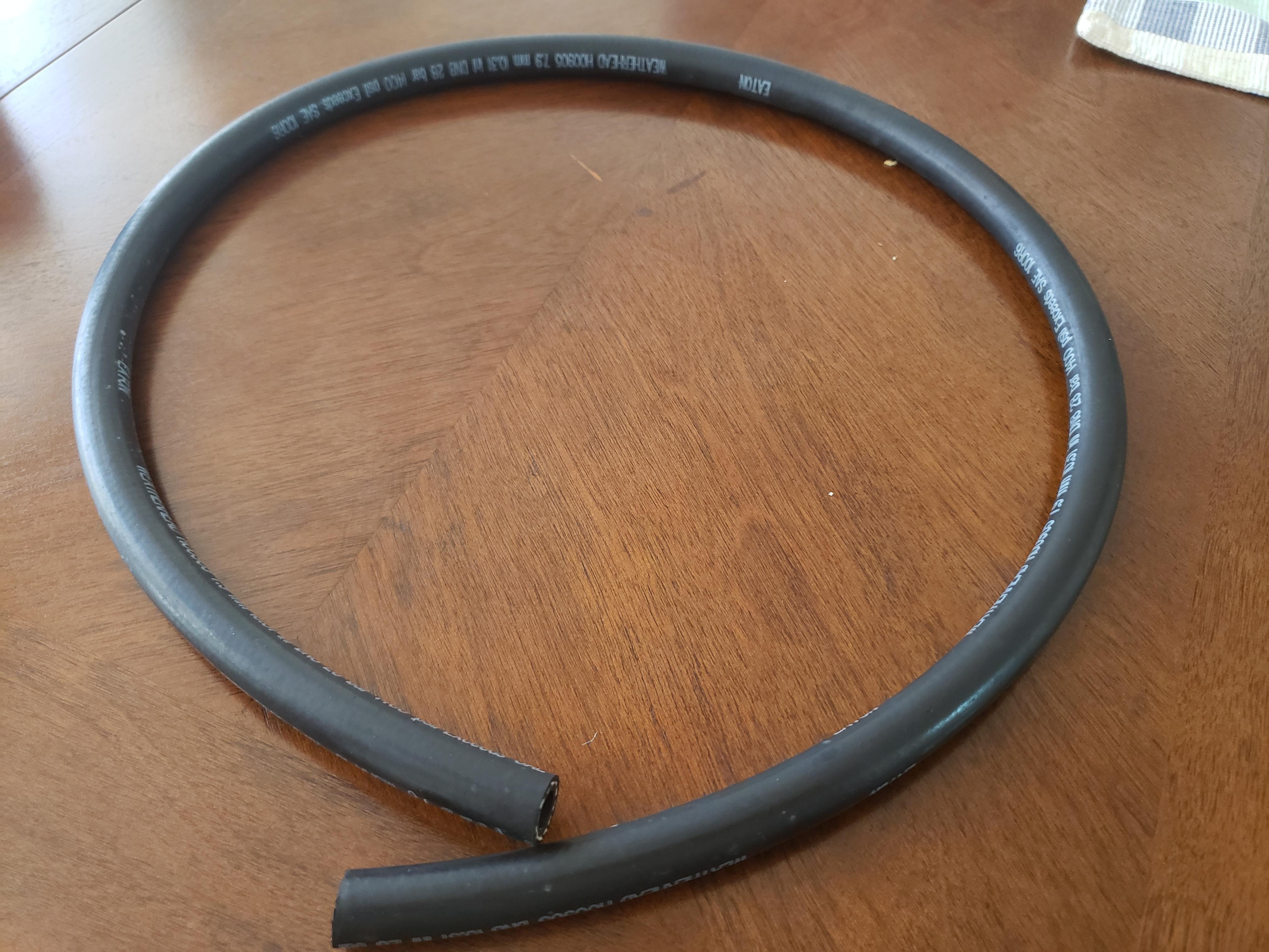

I replaced all my fuel hose with this stuff back in 2017, no cracks or leaks yet. I will mention that since I cleaned and lined my tank, converted to electric fuel pump and replaced all my rubber fuel lines with the Gates E85 rated hose back in 2017 I've run nothing but ethanol free gas in my 240z. I went with the E85 rated hose just in case I have no choice in the future on running gas with ethanol. I also contacted ZTherapy regarding their carb rebuilding and E85, Bruce said they ran soak tests a number of years ago and saw no ill effects. Steve did jump in and say that if you run alcohol you will likely have to richen your mixture.
