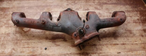

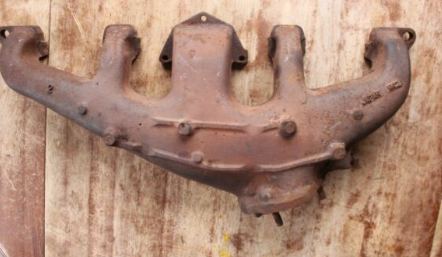

November 26, 20195 yr comment_588256 Should be very easy. How about some pictures of the reman engine? We love to see other people's cool stuff. Is it in a box? Who reman'ed it? Nissan or someone else? Here are some images I stole from eBay. The ZX manifold is "shorter" and has a different angle to the flange. After 80 or 81, I think, they also had O2 sensors.  https://www.ebay.com/i/383271658929?chn=ps&norover=1&mkevt=1&mkrid=711-117182-37290-0&mkcid=2&itemid=383271658929&targetid=541454198852&device=c&mktype=pla&googleloc=9033356&poi=&campaignid=6470549460&mkgroupid=81274343007&rlsatarget=pla-541454198852&abcId=1139336&merchantid=113625313&gclid=CjwKCAiAlO7uBRANEiwA_vXQ-1Ut8e94uWjLqn051V6ppSf1lEVw4fN47-rL18plbyR1TgFpPfq1RhoC-6gQAvD_BwE https://www.ebay.com/i/113846585162?chn=ps&norover=1&mkevt=1&mkrid=711-117182-37290-0&mkcid=2&itemid=113846585162&targetid=596465995348&device=c&mktype=pla&googleloc=9033356&poi=&campaignid=6470719577&mkgroupid=81597521270&rlsatarget=pla-596465995348&abcId=1140476&merchantid=113625313&gclid=CjwKCAiAlO7uBRANEiwA_vXQ-8FYIoFu21zAR6UlYdW4Q46ciHF9HVExnLM_lsVSp0AMijOc2agcsRoCBycQAvD_BwE Link to comment https://www.classiczcars.com/forums/topic/63196-240z-enginetransmission-swap/#findComment-588256 Share on other sites More sharing options...

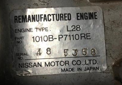

November 26, 20195 yr Author comment_588266 2 hours ago, Zed Head said: Should be very easy. How about some pictures of the reman engine? We love to see other people's cool stuff. Is it in a box? Who reman'ed it? Nissan or someone else? Here are some images I stole from eBay. The ZX manifold is "shorter" and has a different angle to the flange. After 80 or 81, I think, they also had O2 sensors.  https://www.ebay.com/i/383271658929?chn=ps&norover=1&mkevt=1&mkrid=711-117182-37290-0&mkcid=2&itemid=383271658929&targetid=541454198852&device=c&mktype=pla&googleloc=9033356&poi=&campaignid=6470549460&mkgroupid=81274343007&rlsatarget=pla-541454198852&abcId=1139336&merchantid=113625313&gclid=CjwKCAiAlO7uBRANEiwA_vXQ-1Ut8e94uWjLqn051V6ppSf1lEVw4fN47-rL18plbyR1TgFpPfq1RhoC-6gQAvD_BwE https://www.ebay.com/i/113846585162?chn=ps&norover=1&mkevt=1&mkrid=711-117182-37290-0&mkcid=2&itemid=113846585162&targetid=596465995348&device=c&mktype=pla&googleloc=9033356&poi=&campaignid=6470719577&mkgroupid=81597521270&rlsatarget=pla-596465995348&abcId=1140476&merchantid=113625313&gclid=CjwKCAiAlO7uBRANEiwA_vXQ-8FYIoFu21zAR6UlYdW4Q46ciHF9HVExnLM_lsVSp0AMijOc2agcsRoCBycQAvD_BwE Im not to sure who remaned it. I'm the third owner of this engine and the previous two owners never installed it but here is the plaque on the engine and the webers  1 hour ago, siteunseen said: What webers did you get? You might read some and get the easier SU carbs. I had some triples and sold them. Too much tuning for me, never installed them. The SUs are so much simpler and pull good enough for me. Everybody says the webers sound good. What the hell does that add?  And as of now I have someone to do all the tunning but just looking to install it myself. And I do have some su carbs that are on the current engine but as I was trying to tune them I found more and more parts to replace so I just said why not replace everything. Edited November 26, 20195 yr by Gizmohawk Link to comment https://www.classiczcars.com/forums/topic/63196-240z-enginetransmission-swap/#findComment-588266 Share on other sites More sharing options...
November 26, 20195 yr comment_588269 Looks like a Nissan reman. Rebuilt to Nissan specs. Should get 200,000 + miles from it. Do you know where it's been stored, and how? Does it have oil in it or is it empty? I would assume that Nissan coats the internals for rust prevention in preparation for shipping and storage, but who knows how long that lasts. Might be worthwhile to inspect rust prone surfaces before starting it. I don't know when Nissan stopped supplying reman engines but I'll bet it was over 20 years ago, at least. That engine has been floating around for that long. Fixed your picture - Edited November 26, 20195 yr by Zed Head Link to comment https://www.classiczcars.com/forums/topic/63196-240z-enginetransmission-swap/#findComment-588269 Share on other sites More sharing options...
November 26, 20195 yr Author comment_588292 10 hours ago, Zed Head said: Looks like a Nissan reman. Rebuilt to Nissan specs. Should get 200,000 + miles from it. Do you know where it's been stored, and how? Does it have oil in it or is it empty? I would assume that Nissan coats the internals for rust prevention in preparation for shipping and storage, but who knows how long that lasts. Might be worthwhile to inspect rust prone surfaces before starting it. I don't know when Nissan stopped supplying reman engines but I'll bet it was over 20 years ago, at least. That engine has been floating around for that long. Fixed your picture - No I'm not sure on how it's been stored, here is a picture of the engine. You think it should be torn apart and inspected? Edited November 26, 20195 yr by Gizmohawk Link to comment https://www.classiczcars.com/forums/topic/63196-240z-enginetransmission-swap/#findComment-588292 Share on other sites More sharing options...
