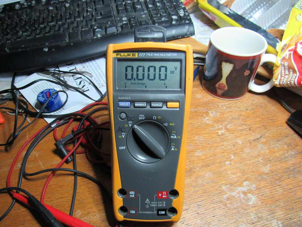

November 30, 20195 yr comment_588440 What? Did you lose my phone number? Fluke meters tend to be very solid meters that hold up a long time. Mine is close to 20 years old, and it doesn't miss a beat. Of course, you could get a Simpson meter, and your grandsons could be fighting over who gets it. My brother grabbed my dad's Simpson when my dad passed away. That meter is probably about 60 years old and just periodically needs batteries. https://www.amazon.com/dp/B002R6MWL0/ What do you want to measure? AC Voltage DC Voltage AC Current DC Current Resistance Temperature (via a thermocouple) Capacitance (nice if you need to test the start capacitor on an AC unit for your house) Inductance (Are you curious about whether or not that coil is good?) RPM (nice for tuning and setting idle speed) The catch is that you can't get all of these features in one meters. The Fluke 115 and 117 are good choices if you don't want temperature measurement. The 116 is the one to get if you want temperature measurement more than current. (Frankly, an inexpensive loop meter for current isn't a bad idea. It can be tricky to use leads to measure current and easy to blow the fuse in the meter if you don't do it right. https://www.amazon.com/Mastech-MS2108A-Current-Multimeter-Frequency/dp/B00KXC8GEW) For RPM, I bought this cheap meter: https://www.amazon.com/gp/product/B0002LZU7K Link to comment https://www.classiczcars.com/forums/topic/63210-dmm/#findComment-588440 Share on other sites More sharing options...

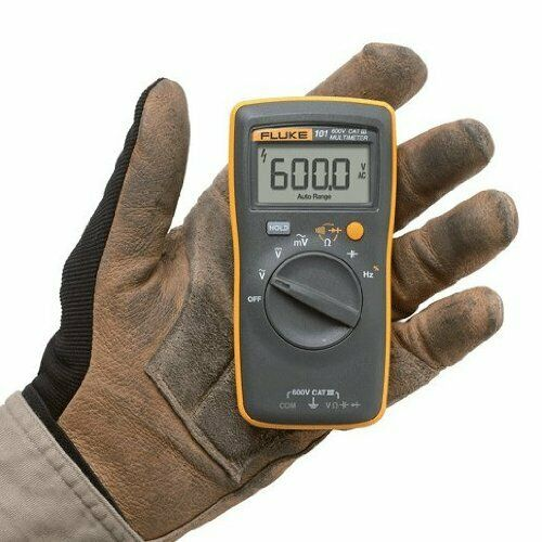

November 30, 20195 yr comment_588450 My first meter was a BECKMAN back in the 80's... very reliable. I gave it to my father a long time ago and he still uses it. I now have a monster Fluke in the garage that is too much meter.... so I agree with SteveJ's list... they are just right. Fluke make a tiny one that seems useful and inexpensive called the 101. It would be great for your son or anyone that is a young'n ? https://www.fluke.com/en-in/product/electrical-testing/digital-multimeters/fluke-101 ~ $70-$100 new Edited November 30, 20195 yr by 240260280 Link to comment https://www.classiczcars.com/forums/topic/63210-dmm/#findComment-588450 Share on other sites More sharing options...

November 30, 20195 yr comment_588482 If you are really interested in doing AC current measurements, use a loop tester. Chances are the inexpensive type like what I linked will work fine. Just remember to isolate the wires and only put the current loop around 1 wire, otherwise the fields will cancel out. The 117 offers non-contact detection. The low impedance features are nice but not must-have. If I was getting a new Fluke, I would be happy with either one. Link to comment https://www.classiczcars.com/forums/topic/63210-dmm/#findComment-588482 Share on other sites More sharing options...
