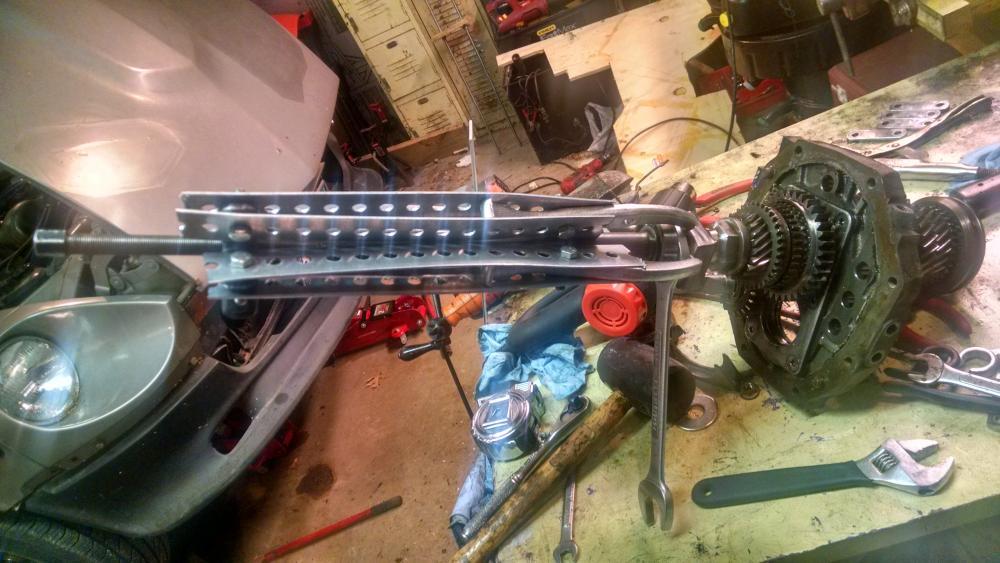

6 hours ago, Captain Obvious said:
I hoooovered this from the interwebs. Probably from somewhere here on the forum:
When all you have is a three jaw puller, the whole mother of invention thing kicks right in.  I'd be proud to have built that.
