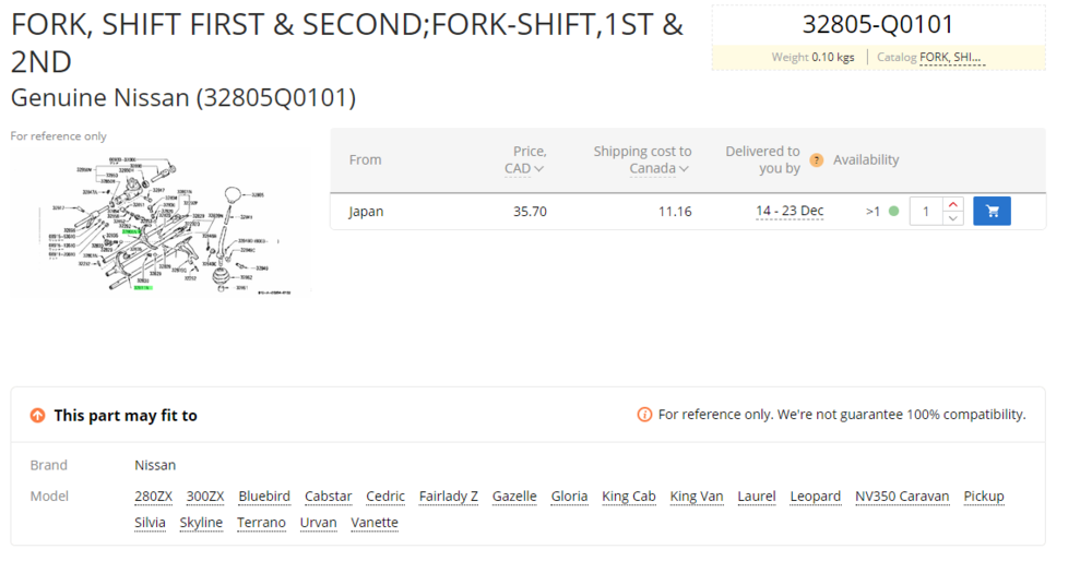

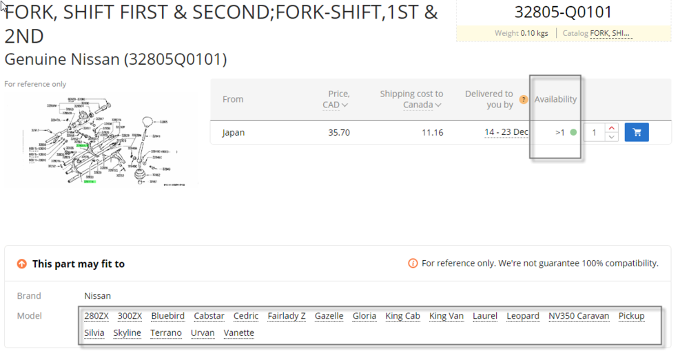

November 30, 20195 yr Author comment_588474 Quick word on parts availability, in this case my badly needed 1-2 shift fork Note the list of other Nissan vehicles at the bottom that have a 32805-Q0101 Also encouraging is the Availability column. Apparently they have more than 1, the other site wasn't quite as encouraging. Link to comment https://www.classiczcars.com/forums/topic/63211-fs5w71b-rebuild-thread-tips-tricks-and-discoveries/?&page=2#findComment-588474 Share on other sites More sharing options...

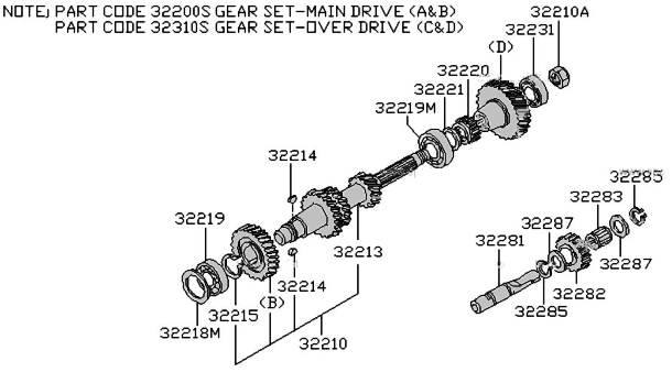

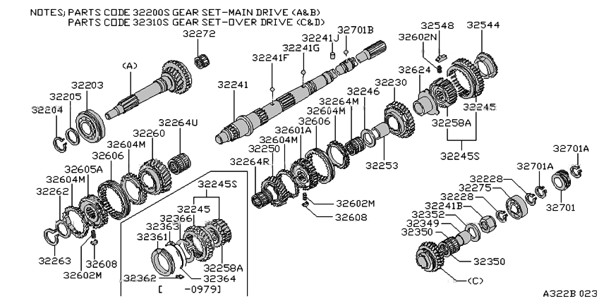

November 30, 20195 yr Author comment_588476 Decent quality parts blow up diagrams for the FS5W71B with the included source URL's where you can go to get detailed part numbers for every little itty bitty piece, as well as a merged in part number listing from EuroDat. trans gear and shift drawing_Land.pdf Edited November 30, 20195 yr by zKars Link to comment https://www.classiczcars.com/forums/topic/63211-fs5w71b-rebuild-thread-tips-tricks-and-discoveries/?&page=2#findComment-588476 Share on other sites More sharing options...

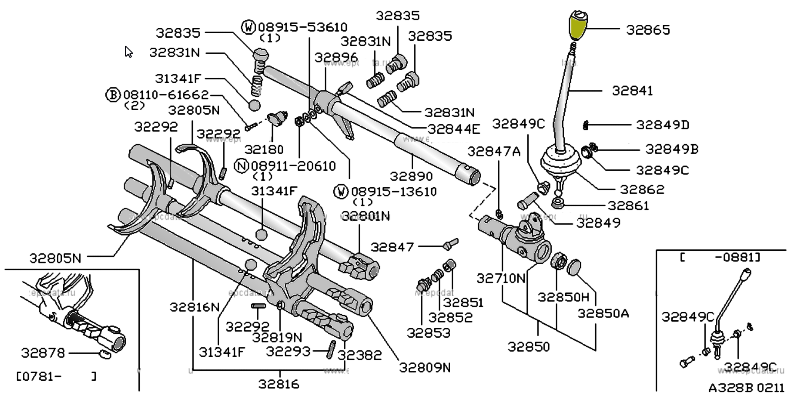

December 1, 20195 yr Author comment_588535 Okay, got a 4 speed opened up. Short answer about the fork interchange 4 vs 5 sp. No. However, the forks are the right "size" for the selector sleeve, and the rods fit through the fork holes correctly, BUT the roll pins are in different locations, both rotational and longitudinally. So you "could" interchange them IF you re-drill the rods for the pins in the right place. Simple right? They aren't hardened or anything, right? BTW the roll pins are smaller OD on the 4 speed. And since the 4 speed forks are steel, you "could" cut the rod part off and "move" it to the right place for the roll pin on the 5sp rod then weld it back on! Short answer no, but in a pinch, you know race day, car broke, final race of the season, if we could just finish the race, we get first overall, then yes, you can make it work..... You know the "C" type trans are more or less the same inside too.... Maybe their forks are backward compatible. You're going to make me take a C type apart, aren't you? Link to comment https://www.classiczcars.com/forums/topic/63211-fs5w71b-rebuild-thread-tips-tricks-and-discoveries/?&page=2#findComment-588535 Share on other sites More sharing options...

December 2, 20195 yr comment_588564 6 hours ago, zKars said: 4 speed Looks there are two different 4 speeds, and two different 5 speeds. Parts 5 and 6 respectively. There's overlap. Looks like you got mismatched years, maybe. http://www.carpartsmanual.com/datsun/Z-1969-1978/power-train/transmission-control/4-speed/from-sep-71 http://www.carpartsmanual.com/datsun/Z-1969-1978/power-train/transmission-control/5-speed Link to comment https://www.classiczcars.com/forums/topic/63211-fs5w71b-rebuild-thread-tips-tricks-and-discoveries/?&page=2#findComment-588564 Share on other sites More sharing options...

December 2, 20195 yr comment_588591 On 11/30/2019 at 8:22 AM, zKars said: Can't imagine that the shifter is the cause of not being able to get to 5th. They all work the same way. Would be a hoot if that was the actual problem. if the geometry of the shifter below the pin were a bit short and couldn't quite push it all the way in..... I won't be able to diagnose that particular 5sp until spring when I yard it out and exchange it for one of freshly rebuilt ones. I could give the guy a few different shifter styles to try and see if one of them magically works. I can attest that on my 1978 5 speed transmission you have to have the correct shifter or 5th is a no go. I chased my tail trying to find out my issue. I was using my 4 speed shifter. There is a difference between the two. Completely solve the issue. Link to comment https://www.classiczcars.com/forums/topic/63211-fs5w71b-rebuild-thread-tips-tricks-and-discoveries/?&page=2#findComment-588591 Share on other sites More sharing options...
December 2, 20195 yr comment_588593 1 hour ago, gundee said: correct shifter Apparently there are three 4 speed shifters also. I used my 1976 4 speed shifter on a 78, 81, and 83 5 speed and never had any problems. http://www.carpartsmanual.com/datsun/Z-1969-1978/power-train/transmission-control/4-speed/from-sep-71/27 Link to comment https://www.classiczcars.com/forums/topic/63211-fs5w71b-rebuild-thread-tips-tricks-and-discoveries/?&page=2#findComment-588593 Share on other sites More sharing options...
December 2, 20195 yr Author comment_588599 2 hours ago, gundee said: I can attest that on my 1978 5 speed transmission you have to have the correct shifter or 5th is a no go. I chased my tail trying to find out my issue. I was using my 4 speed shifter. There is a difference between the two. Completely solve the issue. Well there's definitive proof. I will grab my collection of shifters and go try some and see if we can get that sucker in 5th! I have some of those ZX shifters that have the plastic center section with the springs where the pin goes through. There certainly are differences in the pin to end of shifter ball/nylon bushing that sits in the shifter selector rod hole. Link to comment https://www.classiczcars.com/forums/topic/63211-fs5w71b-rebuild-thread-tips-tricks-and-discoveries/?&page=2#findComment-588599 Share on other sites More sharing options...
December 2, 20195 yr comment_588600 I think it is that distance that makes it work/not work. Moving the hole higher in the shorter spans may help fix the problem. Edited December 2, 20195 yr by 240260280 Link to comment https://www.classiczcars.com/forums/topic/63211-fs5w71b-rebuild-thread-tips-tricks-and-discoveries/?&page=2#findComment-588600 Share on other sites More sharing options...
December 2, 20195 yr Author comment_588601 Yup, that tip has to get deep enough into the hole and then the tip has to move far enough back to get the rod back far enough. Needs the right length tip for sure. Out of all the 5 speed swaps I've done, to have never run across this before is down right astounding. Just another example of something new to learn every day. Edited December 2, 20195 yr by zKars Link to comment https://www.classiczcars.com/forums/topic/63211-fs5w71b-rebuild-thread-tips-tricks-and-discoveries/?&page=2#findComment-588601 Share on other sites More sharing options...
