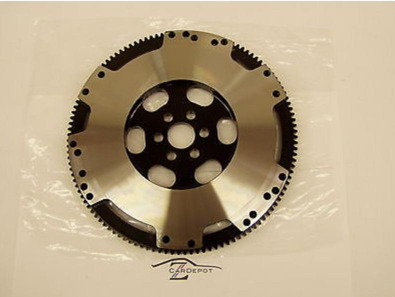

December 1, 20195 yr comment_588516 If you want throttle response, you won't get much by doing that, if any at all. These old efi systems don't like alterations much at all. It unbalances the components and the ecu can not compensate. It doesn't "learn and adjust" like newer sysrems can. Changing to a sport air filter or a larger exhaust system can help a bit because they are outside the components and could be restricting the flow, but extractors can change the scavenge of exhaust gases and that could have a negative effect. The easiest why to improve throttle response on these ols efi systems (without changing ecu, cam, head etc) is a lightened flywheel. The standard flywheel is 23lbs. If you get one that has been lightened to 16-18lbs or lighten the one you have, it will repond a lot more the the throttle. Or an aluminiun, but they are around 11lbs and that will reduce drivability a lot. Some people don't have any problem with the touchy throttle. You could match that to a 240mm clutch out of a 280Z(X) 2+2 or a 280ZX turbo clutch. That would gain a little weight over the standard clutch and would give you a heavy duty clucth with a light peddle. https://www.summitracing.com/search/brand/fidanza/year/1978/make/nissan/model/280z/part-type/flywheels?SortBy=Default&SortOrder=Default Not trying to be negative, but a lot of changes often make the engine sound better and we think that makes it faster, but it's often our mind playing tricks on us. That sounds fat cool, so it must be faster. If I change anything to my car, I go to a quiet road near home and do a simple test. I drive at at a certain speed, say 20 mph and give full throttle till it reaches 70 mph. Don't change gears during the test.. Have a friend (or my wife, if she is in the mood to waste time helping me on this thing) video the speedo and tacho and compare that with the results after you do the mods. If the time reduces, than you made an improvement. You can plot the speed versus time in excel and get a kind of power curve. Plot both before and after and you can see if it improved in certain areas of the rev curve. Link to comment https://www.classiczcars.com/forums/topic/63216-afm-upgrade-questions/#findComment-588516 Share on other sites More sharing options...

December 1, 20195 yr comment_588532 The aftermarket throttle bodies are made for after market ecu like megasquirt etc. Then you have the ability to tune for performance and the extra capacity the throttle body can give. If you don't want to use your flywheel, you could buy one that is already lightened. There are still companies out there thaf lighten them. Zcardepot sell one variant. https://www.ebay.com/itm/Datsun-1970-83-240Z-260Z-280Z-280ZX-Competition-Clutch-Lightweight-Flywheel-161/323799190475?fits=Model:280Z|Make:Datsun&epid=1545121518&hash=item4b63ef8bcb:g:UscAAOxy039TKLJl&redirect=mobile They are all around thd $350 - $400 mark. I don'tknow if buying a new flywheel and having it lightened would be any cheaper. You would need to find someone with experience in these flywheels. Plenty of suppliers with kits including the flywheel. https://www.ebay.com/itm/TR1-STAGE2-CLUTCH-KIT-FLYWHEEL-For-1975-1983-DATSUN-280Z-280ZX-2-2-TURBO-L28ET/333165142490?fits=Model:280Z|Make:Datsun&hash=item4d9230a1da:g:qBIAAOSwXNdcXLKm&redirect=mobile Be carefull when buying a flywheel. You don'twant the one for the nissan trucks (D21) etc. The flywheel is heavier at around 28lbs. Not what you want. Link to comment https://www.classiczcars.com/forums/topic/63216-afm-upgrade-questions/#findComment-588532 Share on other sites More sharing options...
