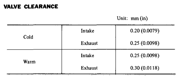

I agree the 4 and 3 are not dirty at all and Cylinders have the most wear on the cam, barely had any valve lash, it was 0.002in and 0.001in barely fit.
Lash gets tighter when the engine warms up.  Might be that the PO ran it hard because it was running poorly and "burnt" some valves.  That just means warped from uneven heating cause they weren't seating all the way.  Not good!
Looks like lash gets about .002" tighter after warmup.  So, you'd have valves hanging open by your numbers.  Might be too late.
