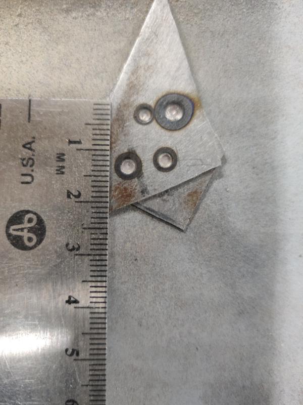

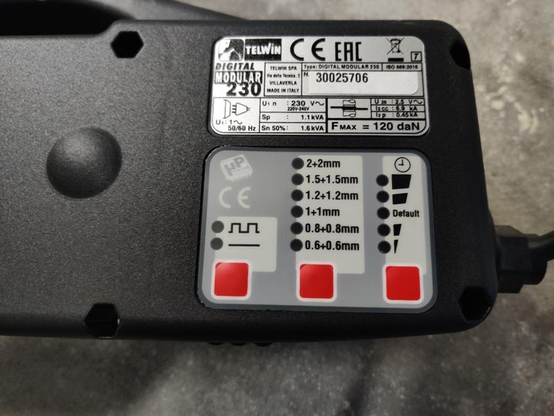

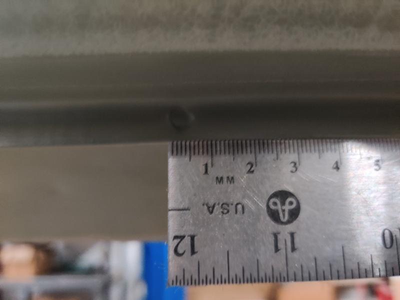

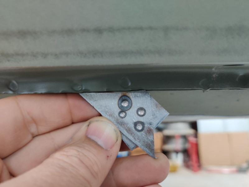

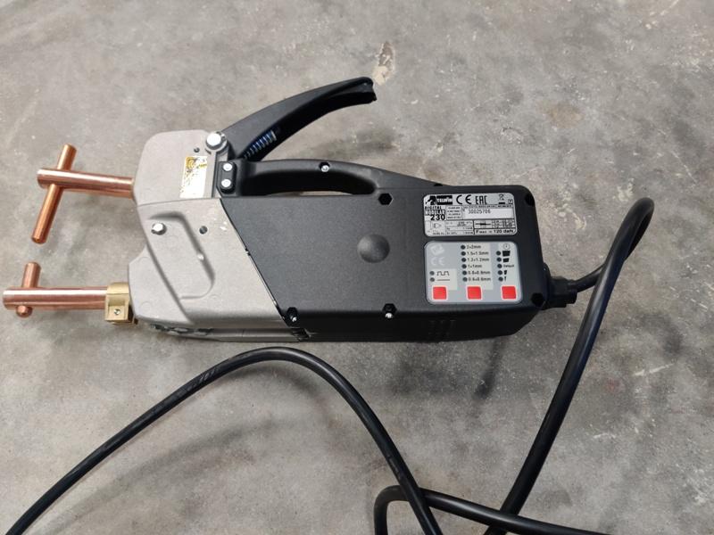

Posted December 21, 20195 yr comment_589708 Hi, I bought a spot welder: a HTP Quick Spot II spot welder (along with a Tig welder) over the Black Friday time period (sale still going on now fyi) and was asked by someone reading my "bringatrailer" 240z build thread to share some information about it after I got it up and running. Well, here goes: Here is the spot welder. The special offer is currently $300 off on qualifying products when you buy the Tig welder. This spot welder counted as a qualifying product, so that is nice... It comes with the copper arms and tips you see in the pic. These are good to get you started with making spot welds in basic configurations. USAWeld sells other tip configurations if you need to spot weld different areas that these tips won't reach. There is a control panel which allows you to choose parameters for different welding situations. The settings from left to right in the picture below are basically "on/off pulse power" vs. "continuous" power, selection of thickness of metal being welded, and fine tuning of the duration of weld operation. There is also a pressure setting, which adjusts the amount of pressure the two contacts close upon the sheet metal with. The pulse operation can be used for high strength low alloy, galvanized, or weld thru primer coated metals according to the manual. It uses time between heat pulses to burn away contaminants for a better weld. Continuous can be used for clean metal. You follow the guidance in the manual and set the second setting based on the total thickness of the panels being welded. In the next pic (I only did one sample piece) the welds correspond to the following settings: Weld order from top left to right to bottom left to bottom right is: 1, 4, 3, 2: Weld 1: (top left): 175 lbs, continuous, 1 mm + 1 mm, and default duration Weld 2: (bottom right): 265 lbs, continuous, 1 mm + 1 mm, and default duration Weld 3: (bottom left): 265 lbs, continuous, 1 mm + 1 mm, and 1 step up from default duration Weld 4: (top right): 265 lbs, pulse welding, 1 mm + 1 mm, and maximum duration If it isn't apparent, you should notice that the size of the spot welds is quite small. That is, the diameter of the "divot" is much smaller than that of the factory spot welds on our Datsuns. Here is a reference image: The factory spot weld on the lower edge of this rocker of my 240z (apologies if it is hard to see) is about 5 mm in diameter. The largest of the example welds done above on the test piece is about 4 mm. Here is another reference photo: So, a ready made observation is that the HTP Quick Spot II isn't going to replicate the 240z's factory spot welds. However, it's kind of close... and if the performance is as good as shown in the video below, then maybe getting factory "performing" spot welds is a box that can be checked with this welder. And perhaps making them look factory is pretty easily done with a bit of creativity? I'll be exploring that coming up in the new year in my 240z build thread, if your interested in checking that out. Hope this helps someone. Garrett Edited December 21, 20195 yr by inline6 Link to comment https://www.classiczcars.com/forums/topic/63311-htp-quick-spot-ii-spot-welder-quick-review/ Share on other sites More sharing options...

December 26, 20195 yr Author comment_589955 Thanks for this info. Very informative. Here are the specs of the Quick Spot II for reference. I am not familiar with kVA. Can you tell me how you arrive at 1.6 kVA? I assume an equation of some sort and some of the following as parameters? Quick Spot II Specs Maximum Welding Current: 6000 Amps Welding Voltage: 2.5 Volts Max Electrode Pressure: 265 Lbs. Input Voltage: 220 Volts Input Amperage: 30 Amps Maximum Absorbed Power: 13 Kw Rated Power: 2.3 Kw @ 50% Spots/Hr: 180 (continuous mode, 20 gauge panels) Maximum Double-Sided Spot Welding Thickness: 14 gauge (.075") + 14 gauge (.075") Dimensions: 17" L x 4" W x 7" H Weight: 30 Lbs. Warranty: 1-Year Link to comment https://www.classiczcars.com/forums/topic/63311-htp-quick-spot-ii-spot-welder-quick-review/#findComment-589955 Share on other sites More sharing options...

February 5, 20205 yr comment_592201 Actually, 1.6kVA is the rating on the welder itself. The max rating for clamping is 269 lbs, per the label. With 220VAC and 30A input, I doubt the output could be 15kVA. The max input kVA is 6.6. Link to comment https://www.classiczcars.com/forums/topic/63311-htp-quick-spot-ii-spot-welder-quick-review/#findComment-592201 Share on other sites More sharing options...
February 5, 20205 yr comment_592210 It seems the specs have errors? I just multiplied welding Voltage X welding current. It looks like the 6000A may be incorrect. Some possibilities below. Quick Spot II SpecsMaximum Welding Current: 6000 Amps < 600A or Max Weld Pwr= 6kW Welding Voltage: 2.5 Volts Max Electrode Pressure: 265 Lbs. Input Voltage: 220 Volts Input Amperage: 30 Amps Maximum Absorbed Power: 13 Kw Rated Power: 2.3 Kw @ 50% Spots/Hr: 180 (continuous mode, 20 gauge panels) Maximum Double-Sided Spot Welding Thickness: 14 gauge (.075") + 14 gauge (.075") Dimensions: 17" L x 4" W x 7" H Weight: 30 Lbs. Warranty: 1-Year Edited February 5, 20205 yr by 240260280 Link to comment https://www.classiczcars.com/forums/topic/63311-htp-quick-spot-ii-spot-welder-quick-review/#findComment-592210 Share on other sites More sharing options...

February 5, 20205 yr comment_592216 12 hours ago, inline6 said: I think I missed the difference here the first time I read your comment, Hoover. So, my spot welder is actually putting out 15kVA not 1.5kVA (or 1.6kVA)... That is what your math shows. Namerow, you agree with this math? I lifted the '1.6kVA' rating from your photo, which I took to be the unit your are using. There are two things in play with these welder ratings: When an electrical device relies on power bursts to do its job, the basic electrical power formula of 'P = V x A' is too simplistic and doesn't (directly) apply. That formula is most appropriately used for continuous conditions, such as calculating the power delivered by an electrical transmission line. And even in that case, there are correction factors that need to be used. The power rating for a welder only makes practical sense if it's measured and stated specific to a particular duty cycle (50% in this case). You`ll see a similar approach used for MIG welder ratings. Back in my days as a mechanical engineering undergrad, electrical engineering ratings and calculations always gave me a headache. They still do. Link to comment https://www.classiczcars.com/forums/topic/63311-htp-quick-spot-ii-spot-welder-quick-review/#findComment-592216 Share on other sites More sharing options...
