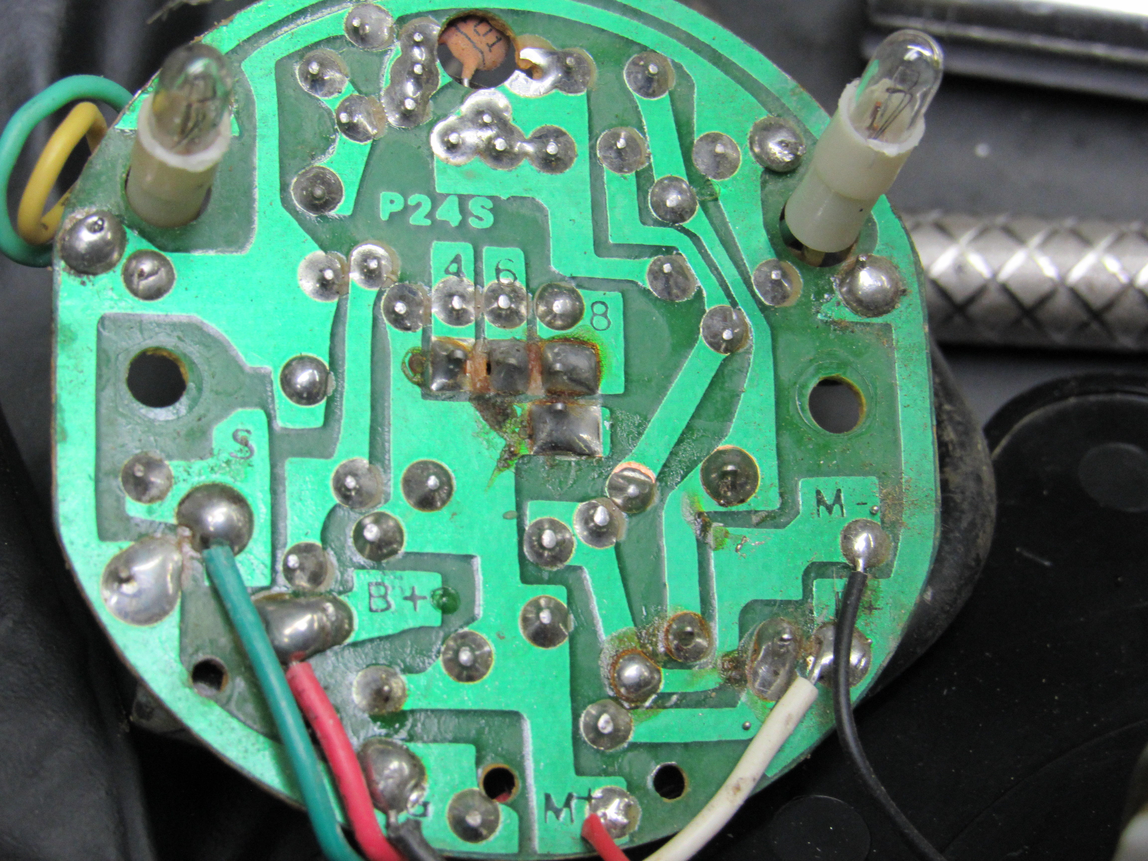

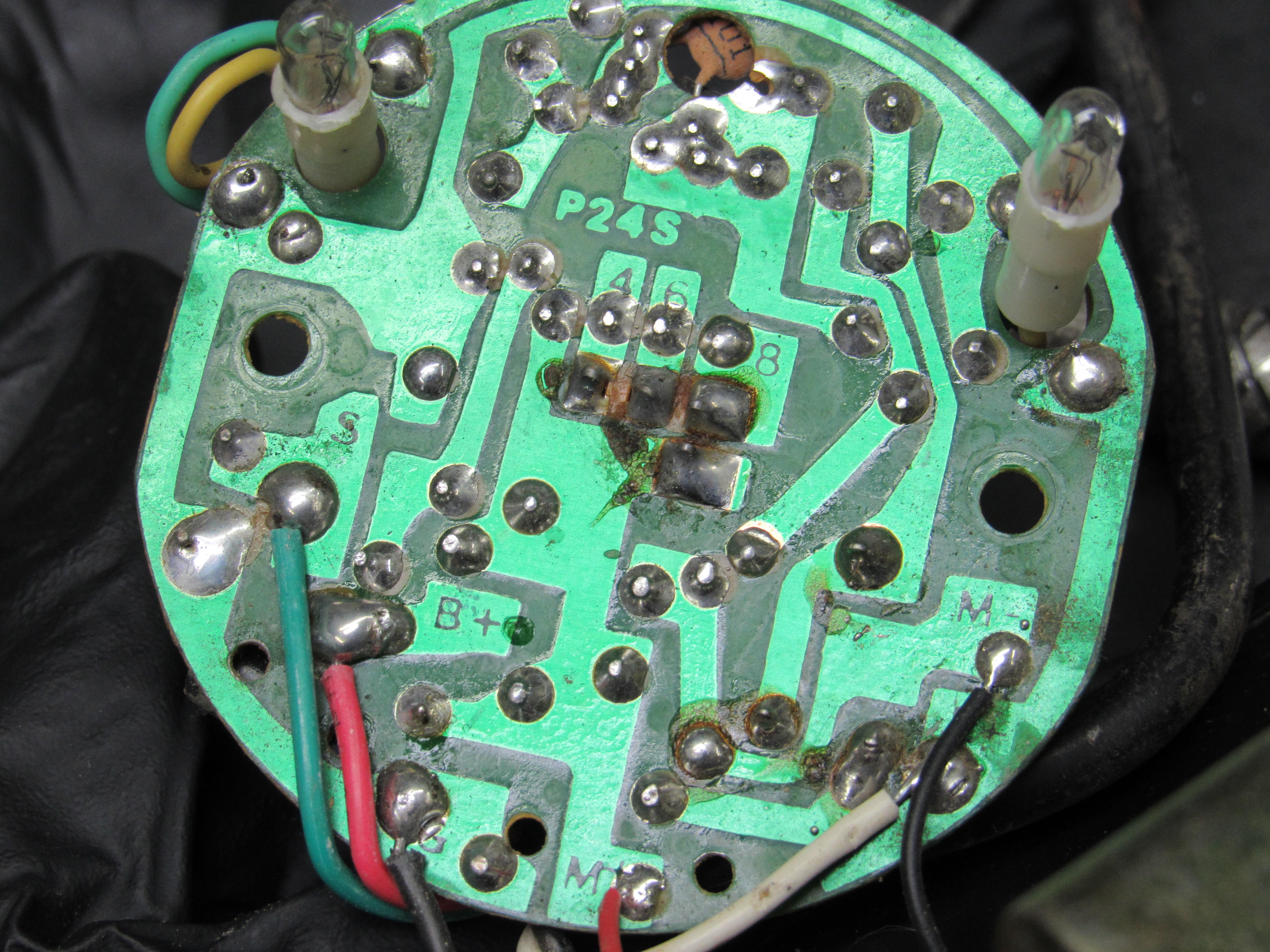

December 23, 20195 yr Author comment_589823 8 hours ago, Zed Head said: A service manual would have the diagram. It is an after market tach from I think 15-20 yrs ago and 510's didn't come with a tach unless it was special ordered. 9 hours ago, Captain Obvious said: Maybe. Can you post a pic of the other side of that tach board? I can probably tell you which ones are power and ground. Here you go, Link to comment https://www.classiczcars.com/forums/topic/63314-repairing-a-circuit-board/?&page=2#findComment-589823 Share on other sites More sharing options...
December 23, 20195 yr comment_589827 From those pics, I believe the black wire is ground side for power. Can you take the brass hex standoffs off and get a shot of the back side of the board? Is there enough slack in the tether wires connecting the board to the mechanical portion to spin the board over and get a straight on shot? Link to comment https://www.classiczcars.com/forums/topic/63314-repairing-a-circuit-board/?&page=2#findComment-589827 Share on other sites More sharing options...

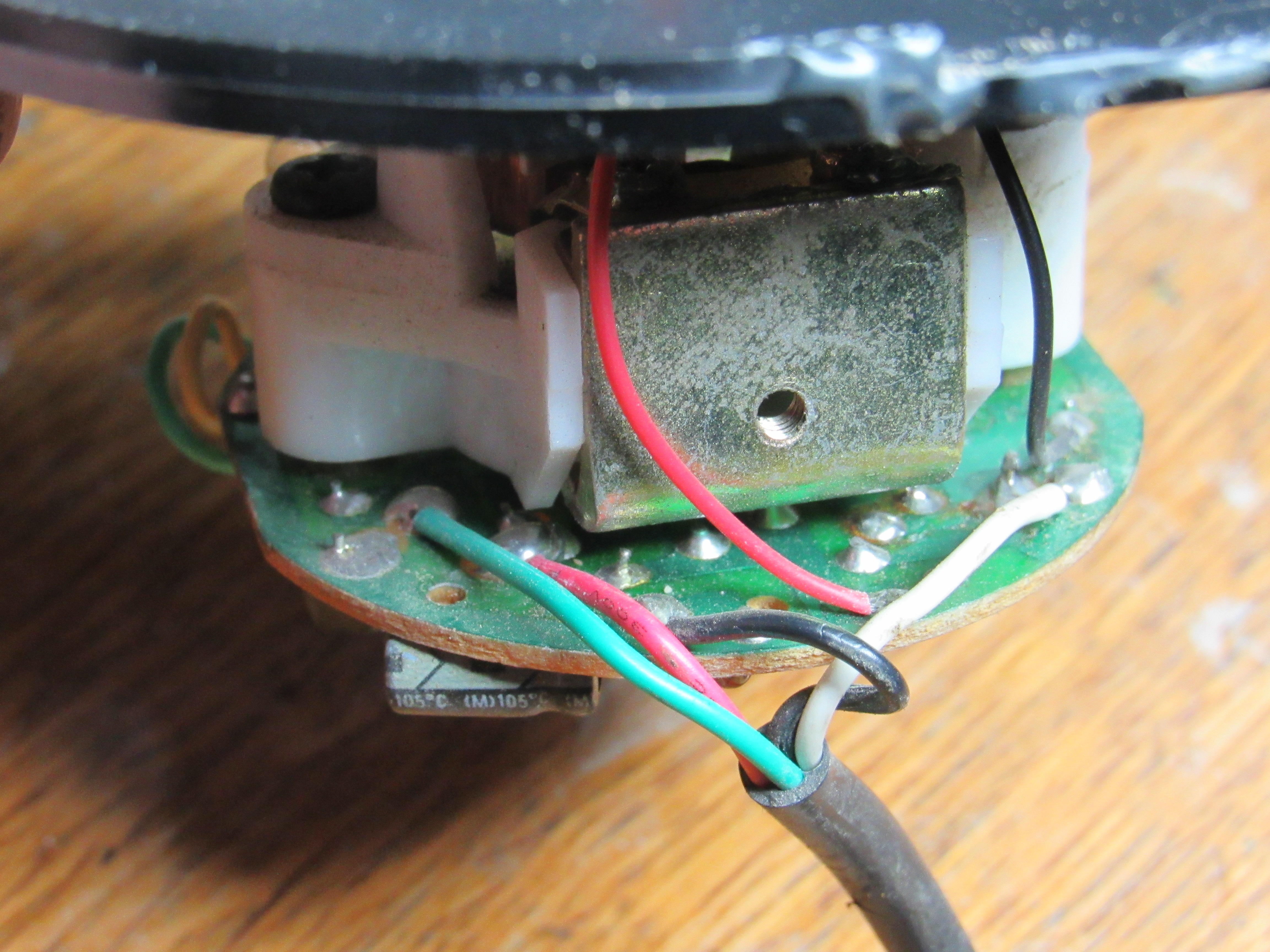

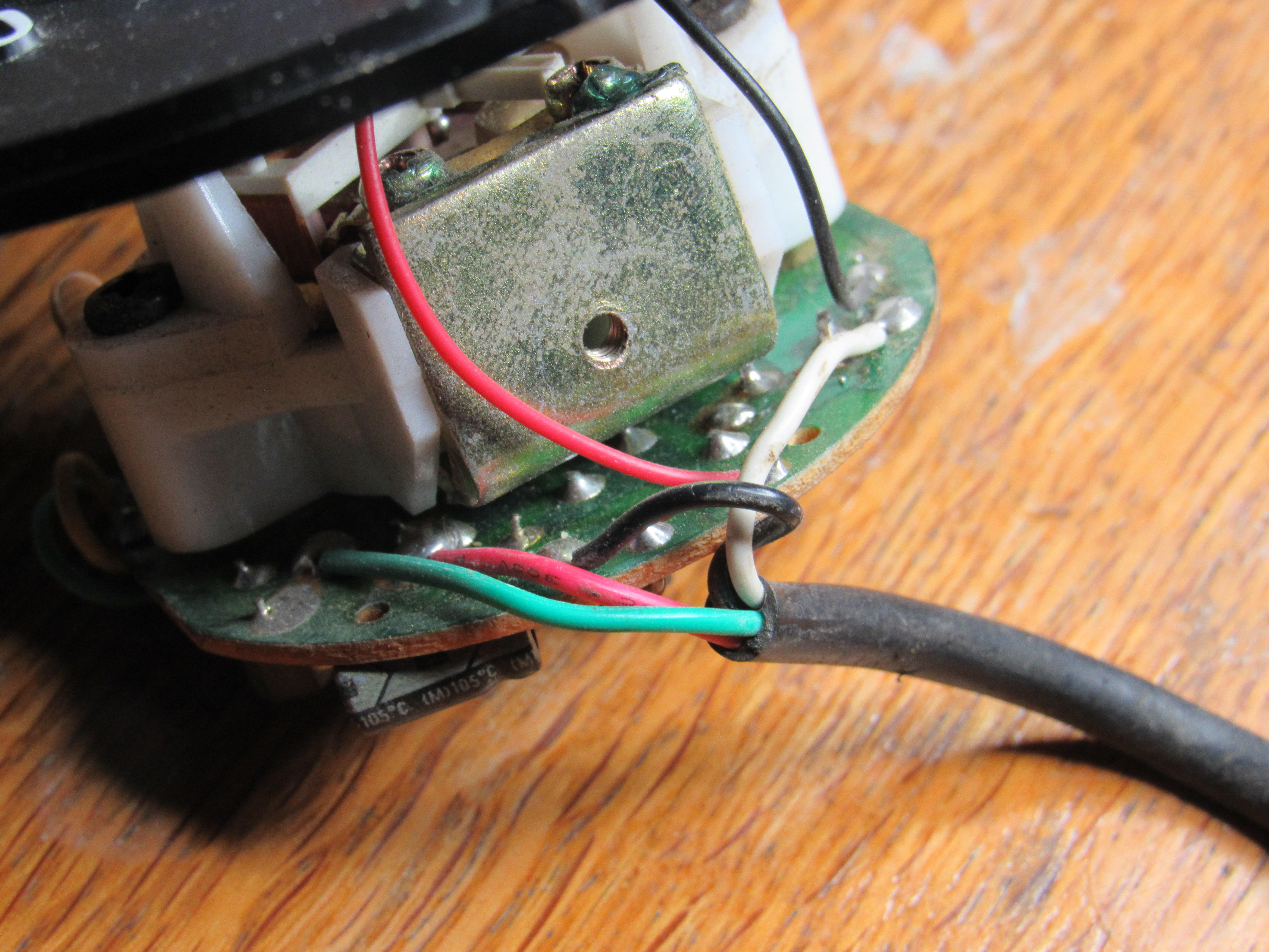

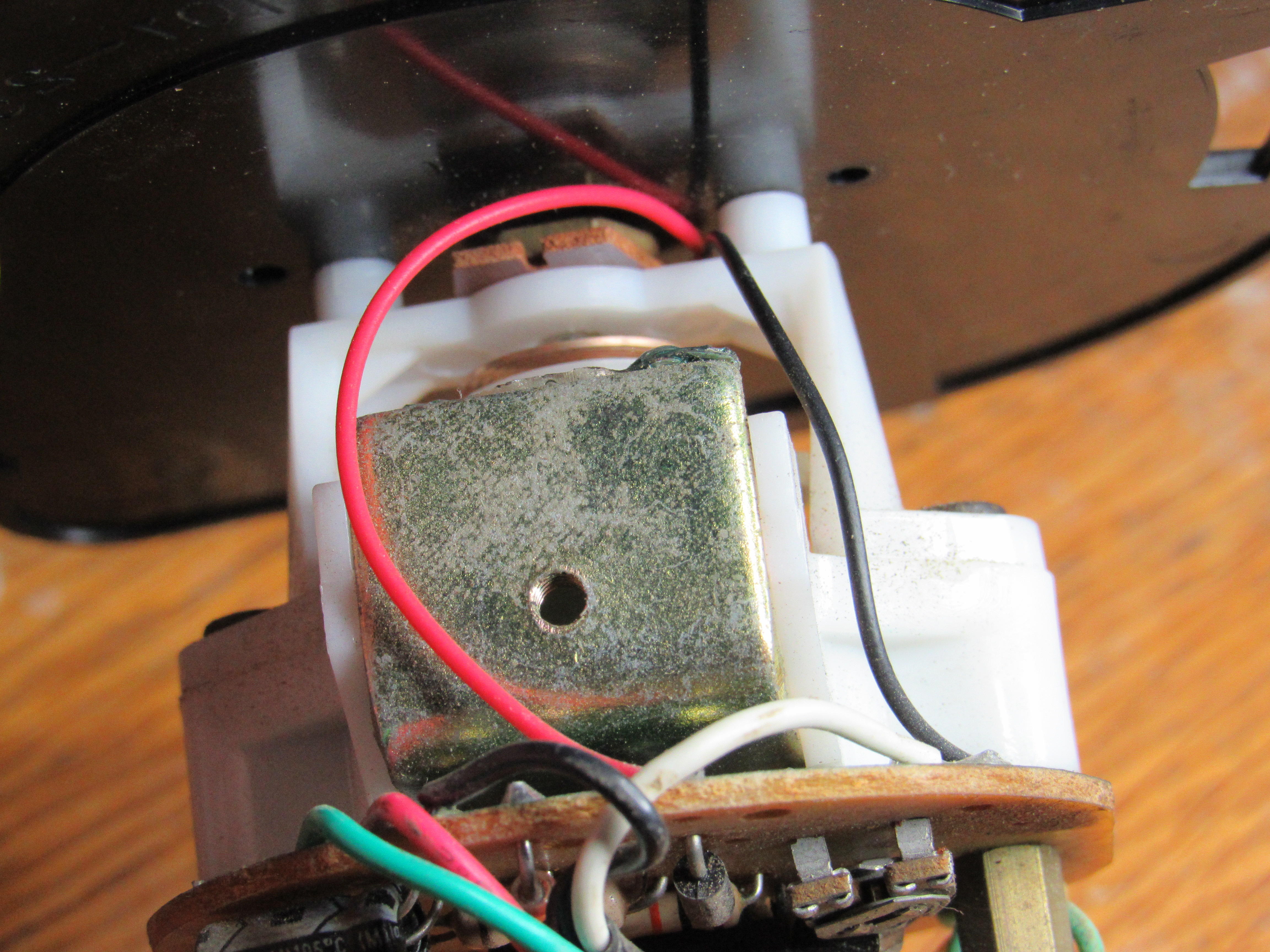

December 24, 20195 yr comment_589869 Red is +12. Black is ground. Green is speed input.* White is gauge illumination lamps. *Note that I don't know what kind of signal the tach is expecting, but the green wire is where it should occur. Link to comment https://www.classiczcars.com/forums/topic/63314-repairing-a-circuit-board/?&page=2#findComment-589869 Share on other sites More sharing options...

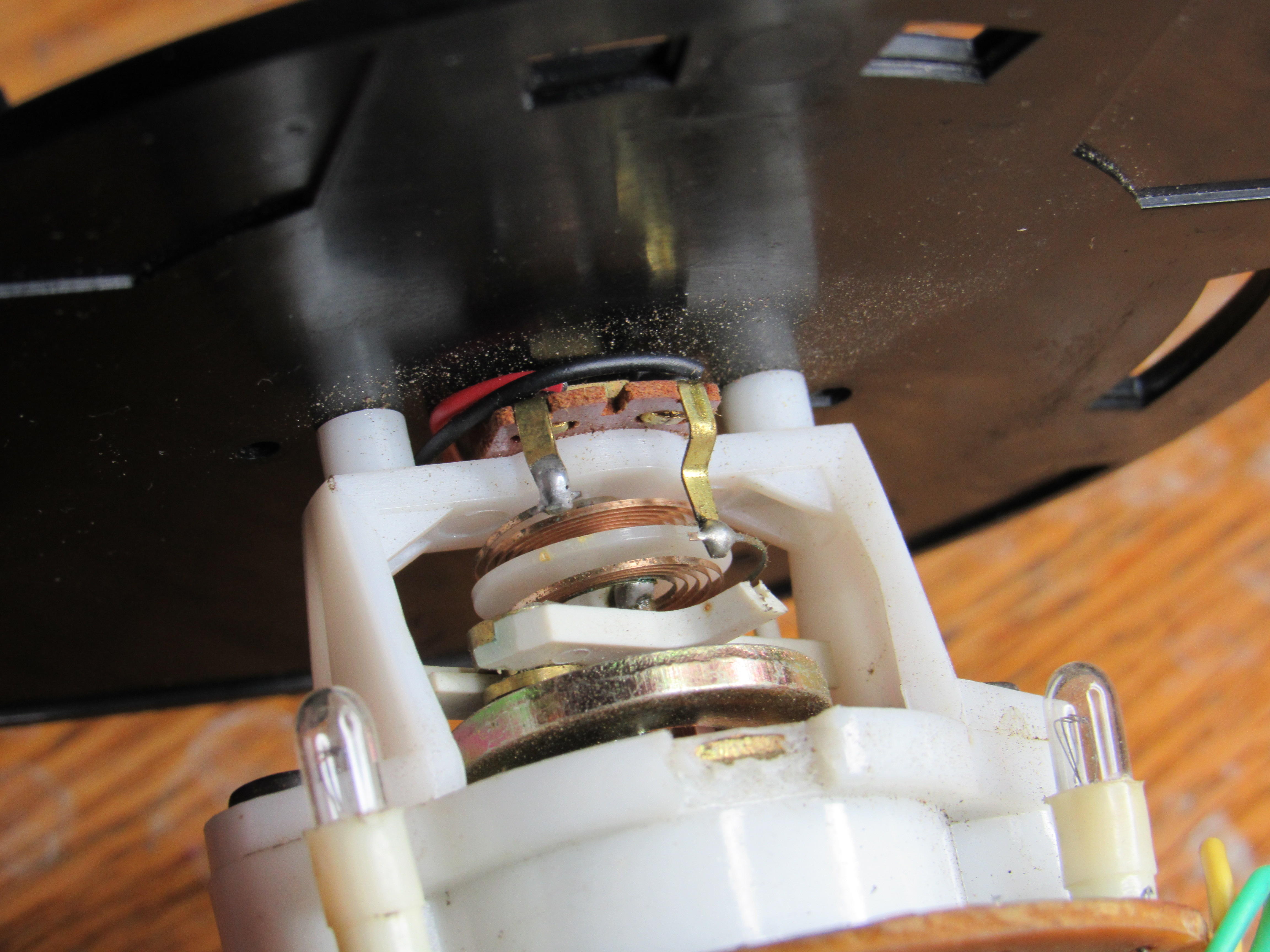

December 24, 20195 yr comment_589870 And... The smaller red and black wires leading deeper into the tach are what makes the gauge needle move. I can tell you more about that if there are problems, but I'm hoping it just works and we don't have to. Edited December 24, 20195 yr by Captain Obvious better choice of words. Reduce the obfuscation. Link to comment https://www.classiczcars.com/forums/topic/63314-repairing-a-circuit-board/?&page=2#findComment-589870 Share on other sites More sharing options...
