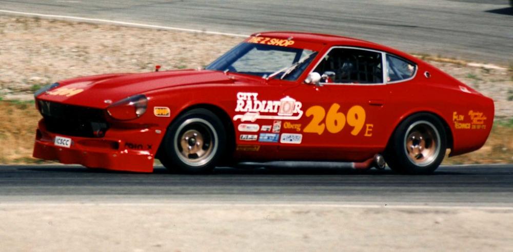

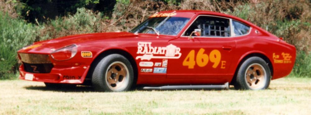

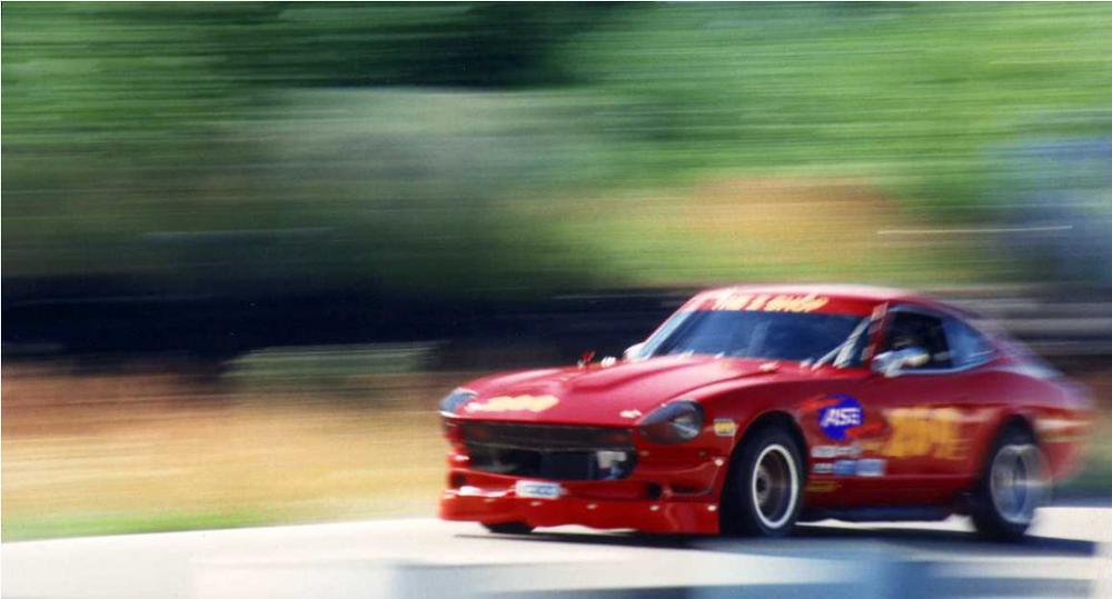

October 14, 20204 yr comment_607927 Here (a poor scan of a photograph, I need to find the negatives and do a proper job of digitizing them) is the first pipe I built. The baffle on the end is on a slight turnout. I scraped the bottom of the cone off and about an inch of the baffles in one race weekend. Summer 1990 by Racer, on Flickr Before the next time out I added some more elbow work and got it up off the ground a bit. Still the whole thing rode pretty low, and my cylinder head guy suggested the shorter pipe with the Lowback. The first is exiting the hairpin and heading for the esses and front straight at Westwood, in Canada. Westwood Hairpin by Racer, on Flickr Then up through the esses, again, Westwood. A buddy of mine took this shot, and was going to throw it away. I managed to get an 8x10 from him first. Westwood by Racer, on Flickr The next one is the banked (15 degrees I think) second turn of Westwood. The car is as compressed as the suspension will allow, and even with the added elbows the bottom of the baffle cone would drag the track. I could go into that turn after only slightly tapping the brake, grab a gear, then mashing the accelerator hold on and the car took a set, it was on rails all the way to the exit. A short chute down hill then a flat left, around the clubhouse, another short chute and a downhill off camber double apex right hander that opened onto the downhill backstretch. I sure miss that track. Westwood Turn 2 by Racer, on Flickr Edited October 14, 20204 yr by Racer X Link to comment https://www.classiczcars.com/forums/topic/63330-2020-what-did-you-do-towith-your-z-today/?&page=14#findComment-607927 Share on other sites More sharing options...

October 14, 20204 yr comment_607947 Racer, that sounds like some immense fun!!! Absolutely love that 8x10 photo!!! And, that’s some serious effort into that side box. Without the wrap that must have been mega louuuud!!!!!We’re you running coil overs back on the day or some variation of the stock suspension? Link to comment https://www.classiczcars.com/forums/topic/63330-2020-what-did-you-do-towith-your-z-today/?&page=14#findComment-607947 Share on other sites More sharing options...
October 14, 20204 yr comment_607949 6 minutes ago, AK260 said: Racer, that sounds like some immense fun!!! Absolutely love that 8x10 photo!!! And, that’s some serious effort into that side box. Without the wrap that must have been mega louuuud!!!!! We’re you running coil overs back on the day or some variation of the stock suspension? The exhaust was actually pretty quiet, at least from a distance. The club measures the sound, and I never went over about 85db at 50 feet. But. I borrowed a sound pressure meter once, strapped it in on the passenger side, and recorded 140db during a 30 minute race. That is quite loud. The suspension is basically stock. Tokico Illumina strut cartridges, aftermarket stabilizer bars front and rear (I forget the sizes at the moment, but they are big, and I had to reinforce the front frame rails as the mounts were tearing out) with urethane bushings, and those eccentric lower control arm bushings that enable camber adjustment. I forget what springs I used, but those were cut down a bit too. I also had those compression rod aluminum cup and delrin ball things. The delrin would get beat up pretty badly, so I milled replacements from aluminum, and lined them with teflon. No more galling, or need to grease, just replace the teflon once a season. Link to comment https://www.classiczcars.com/forums/topic/63330-2020-what-did-you-do-towith-your-z-today/?&page=14#findComment-607949 Share on other sites More sharing options...

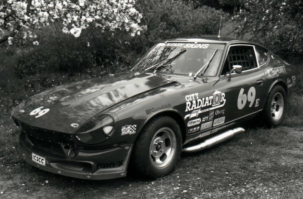

October 18, 20204 yr comment_608404 Didn't do much with any Z cars this weekend (I know, I should be ashamed), as the used oil furnace in my shop consumed my time. I guess if you ignore them for 15 years then one autumn you flip the switch, and they refuse to fire up. Who would have thought, eh? Still, I prefer a warm shop to work in, and the days won't be getting any warmer for the next few months. But beauty can be found in most surroundings, such as this springtime shot of my race car from many years ago. Black & White Z Spring 1991 by Racer, on Flickr Beauty, eh? Edited October 18, 20204 yr by Racer X Link to comment https://www.classiczcars.com/forums/topic/63330-2020-what-did-you-do-towith-your-z-today/?&page=14#findComment-608404 Share on other sites More sharing options...
