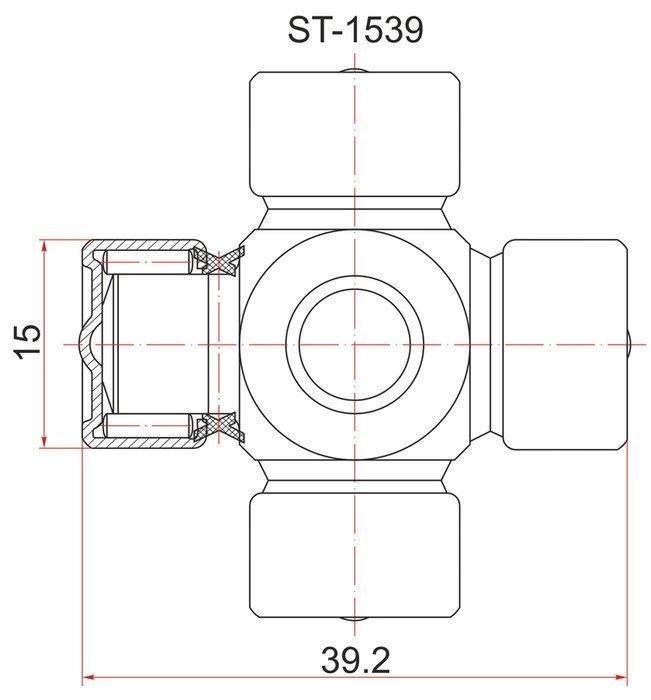

I know this one is old... but for us "staked" guys...
https://www.driveshaftparts.com/index.php?route=product/product&product_id=1100
15mm x 39mm staked u-joint

I was searching around and found a 15mm x 39mm U-Joint on Amazon supposedly for a Land Rover. In the images they list the part number as AST-1539, and a quick google search makes it look like this is, in fact, a real thing.
AST-1539 is actually the manufacturer’s part number, the manufacturer being FEBEST. I think the Land Rover PN is QMN500230 (or LR071147 QMN500250 QMN500230).
