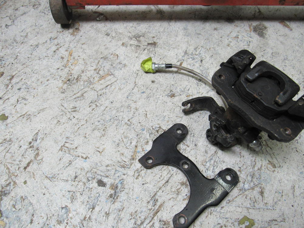

When the car was delivered from the service provider, began to experience a clunking in the rear of the car (drivers side first, then pass). Upon inspection for loose gland nut / strut or suspension issues,  discovered (when the car was on the ground and the suspension was fully loaded) the SS hard brake line mount (L bracket mounted on the sub frame) is making contact with the emergency brake line mount on the Maxima caliper. See photos attached.
This is the same on both sides very tight space to coexist with an active suspension. The SS hard line mount (on frame) is sitting slightly above the emergency brake line bracket at idle. Upon compression clunk, clunk, as it passes below and return to idle.
Please respond if you've preformed this specific rear brake conversion. Not only is this annoying but very dangerous as the flex brake line is also making contact and could be pinched/cut.
Do you have to re-position the frame mount slightly forward? Are there other emergency brake line brackets? or other to gain clearance necessary so the mounts can pass each other without contact. .
Thank you.

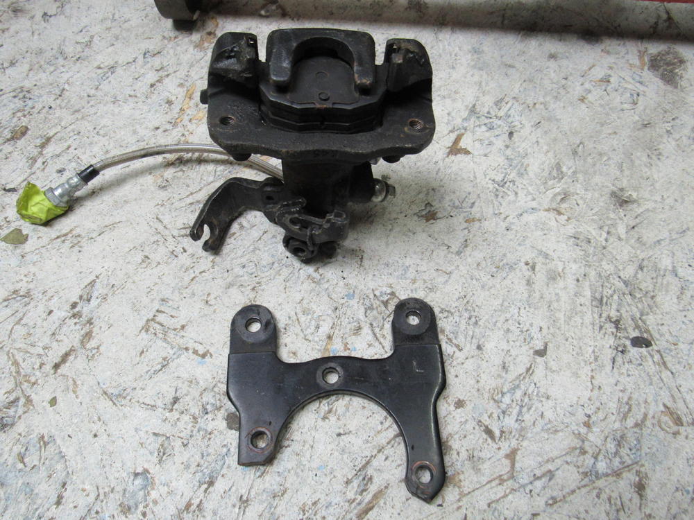

I just removed my Maxima calipers a couple of days ago, so it looks like your adapter plate is clocked too far to the left or CCW on the D/S, lets call it 10:00 at the moment but if you remove the plate and move it CW by one bolt hole to make it sit at 1:00 then there will be no interference and the parking brake cable will have a straighter line.  It also means you can't use the stock rubber flex line anymore and will have to go with the longer SS flex lines.
If you don't want to go that route you could start shaving both the brake line mount and the parking brake mount on the caliper.
