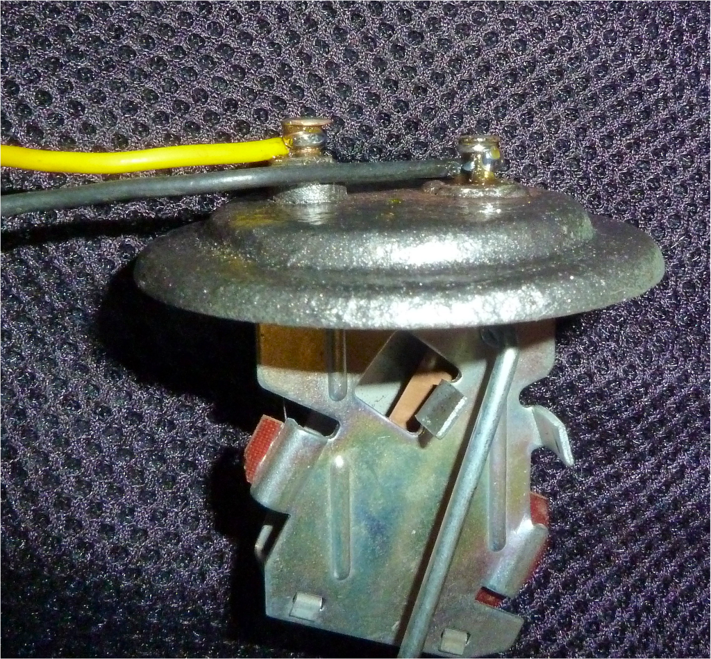

Only issue now is that the terminal boots are hard as rocks.  Going to try a hair dryer tomorrow and see if I can soften them.  Since they're interchangeable, does it matter which wire goes to which terminal on the sender end plate?
Wintergreen will revive rubber.
Resistance is resistance, it has no direction... so from an electronics point of view the connections don't matter... but from a safety point of view, the higher voltage path may be optimized for safety (e.g. more distance from potential shorts/sparks, smaller connector lugs to prevent shorts/sparks, etc.). It is well worth the effort to get it correct.
Edit:  Ok I rechecked and +pos sender terminal is insulated so you need to ensure the voltage goes to the sender terminal.
Disconnect battery if working on this device near gas.
