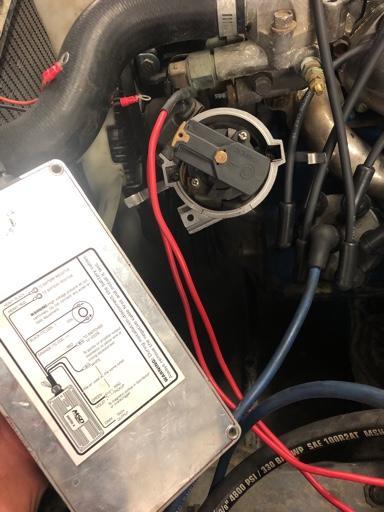

Posted January 30, 20205 yr comment_591780 I’d like to run this msd box how do I hookup the mag pickup. Sent from my iPhone using Tapatalk Link to comment https://www.classiczcars.com/forums/topic/63501-msd-box/ Share on other sites More sharing options...

October 2, 20213 yr comment_629374 https://documents.holley.com/6425.pdf page 4 has wiring information, looks like the violet/green wires are for mag pickup. Link to comment https://www.classiczcars.com/forums/topic/63501-msd-box/#findComment-629374 Share on other sites More sharing options...
