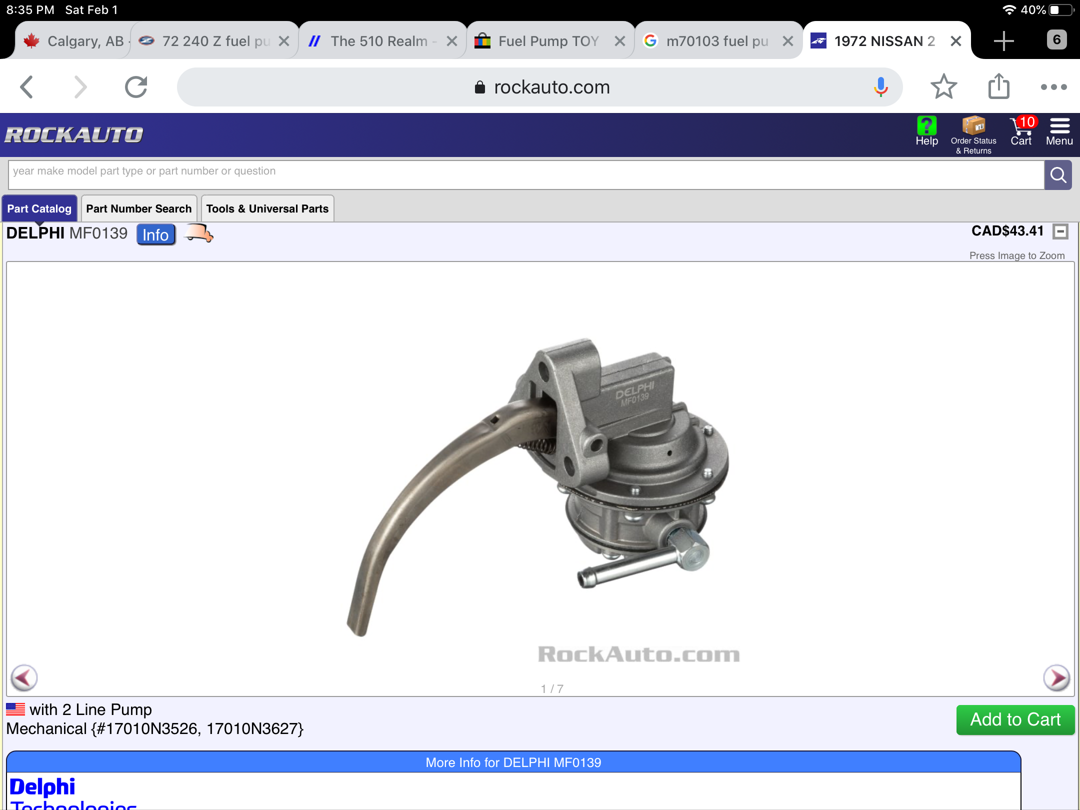

I also remember a post about using a certain Toyota pump that is still available through parts dealers, like RockAuto. Identical internals, just steal the diaphragm and valves and plunl them into yours. I ordered and used one once when that thread came up. At least 5 years ago I think. I wonder how far back my RockAuto order history goes....
Checking RockAuto for 72 240Z, there are a couple of pumps that look like stock ones, a GMB and a Delphi. I wonder if their diaphragms and valves are interchangable with the old stuff. For $43 CAD, might be worth a try.
I should cull through my old pumps, disassemble and get all the old diaphragms and valves out and see what looks usable still.

Thanks, zKars yeah I saw some GMB and Delphi items that might work as cannibalization options as well since i'm trying to keep my original unit. I my try that route if the new Datsun parts.com source doesn't work out.
Per a Carl Beck mention back in 2017 if you are replacing the whole pump the GMB 550-8040 is compatible with (and a Denki lookalike) the early Zs and runs about 30 to 35 bucks on ebay. in my case, i wanted to keep the unit and just replace the guts.
