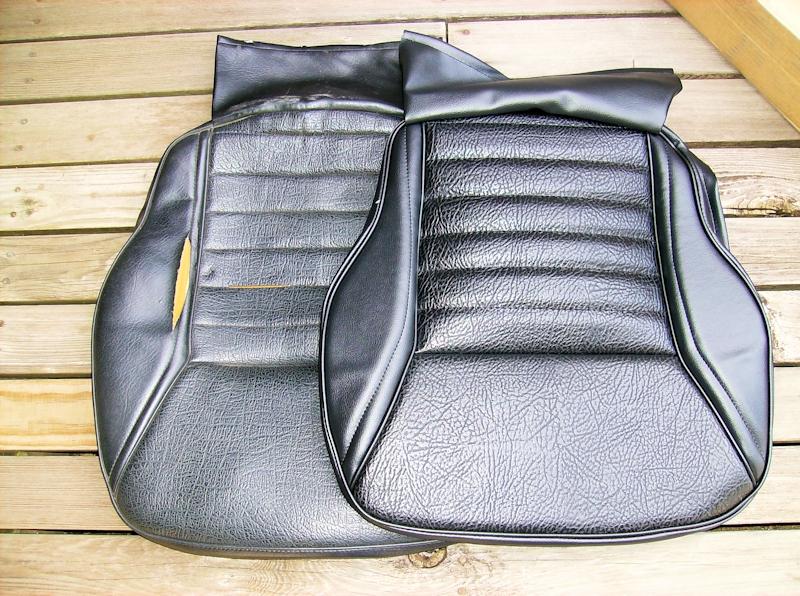

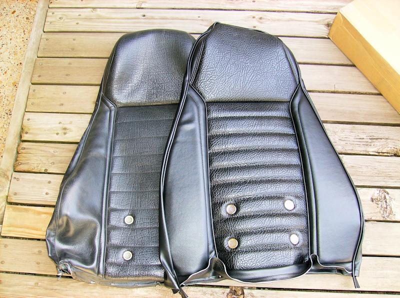

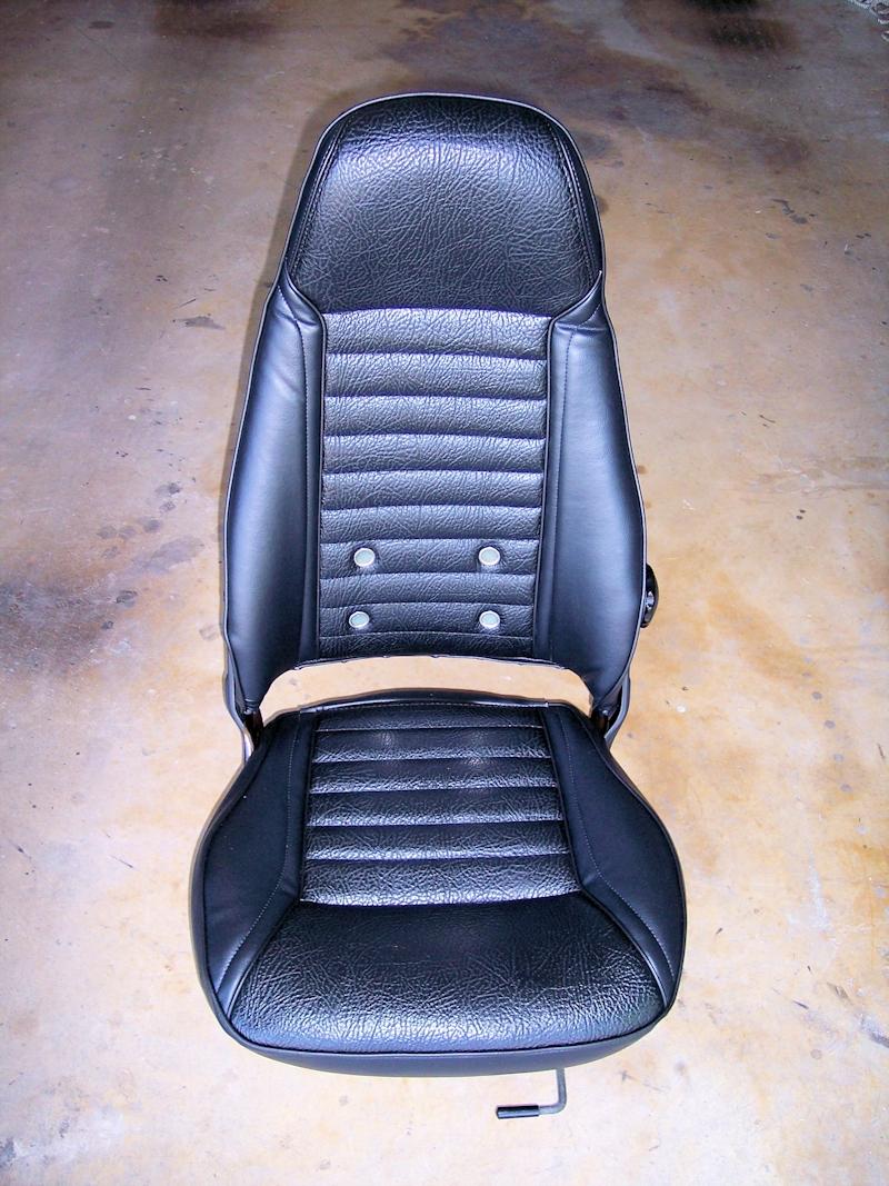

February 3, 20205 yr comment_592131 32 minutes ago, z8987 said: Will this work for my 1970 Series 1? Also, keeping the car original, should I try to use the original seat cover? Is there such thing as an original new cover? These are the replacement seat covers I purchased and installed about 10 years ago - pictured with the original covers for comparison. They came from Seatz, a company in CA, probably the most "original-like" covers available at that time. He does not sell retail. The last I heard he was selling thru MSA - a call to them would be in order to confirm. I used a hog-ring kit to install and similar to @240260280, added some sections of 1/2" thick upholstery foam to beef up various areas of the seats. Link to comment https://www.classiczcars.com/forums/topic/63528-seats-and-other-interior/#findComment-592131 Share on other sites More sharing options...
