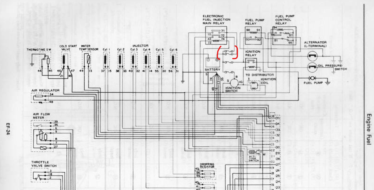

What I'm stumped on is when we did the checks on page 25 "Continuity check using Voltmeter" Check 2-(1) and 2-(2) were fine but every check under 2-(3) failed. So zero results on cylinder 1-6.
Any suggestions on what might be causing this?
A few forum threads have mentioned the wiring to the alternator could be an issue or possible the oil pressure sensor or wiring could be an issue. It sounds like the Fuel Pump Control relay relies on these.
I'd like to check both of those, but I'm struggling finding the proper test procedure for those in the FSM. (and to be honest, am not sure I need to because the fuel pump is running, but I'll try anything at this point.) Any suggestions where I can find those tests in the FSM?
I'm going to replace the oil pressure sensor just to make sure. I took the alternator in and it is charging, but maybe it isn’t communicating with things correctly even though it is charging?
I didn't check the fuel pump relay or fuel pump control relay because I can hear it running and we have pressure to the rail. That's next on my list tomorrow though because I can't tell from the wiring diagram on page 24 if where pin 73 on the EFI relay goes to the fuel pump control relay pins 95 & 97 could be keeping the EFI relay from sending a signal to the Drop Resistor and main harness to send power and signal to cylinders 1-6.

CO knows the 78 system better than most.  @Captain Obvious  But I would doublecheck both of the fusible links that supply the EFI relay.  That tachometer problem could be many things.  But with the key on you should definitely see battery voltage at the injector connectors.  The system works by grounding that power.  So, no power, no injection.
I like to work from wiring diagrams myself.  You can see that power to the ECU and power to the injectors each has their own fusible link.  They would be the green ones connected directly to the battery positive.  Not in the fusible link block, but separate, hanging, sort of, by the battery.  With a plastic connector that often gets connected backwardly to the negative connector which is identical.  Nissan faux pas...
Thanks for the thought on the Fuse Link.  I forgot to mention that I tested those. They are all new and I have power at both sides.
Something else I forgot to mention is that the plug going into the EFI Control relay are all hot across the top and when the ignition is on and/or the engine is turning over the 73 plug is hot, but the other two are not.
Looking at the diagram you can see that if there's power on both sides of the fusible link then there should be power on at least one side of the EFI relay.
You can also see that the ignition relay actuates the EFI relay.  Check that power source.
That's the basics of troubleshooting with a meter and a diagram.  Power here?...check...power here?...check...
