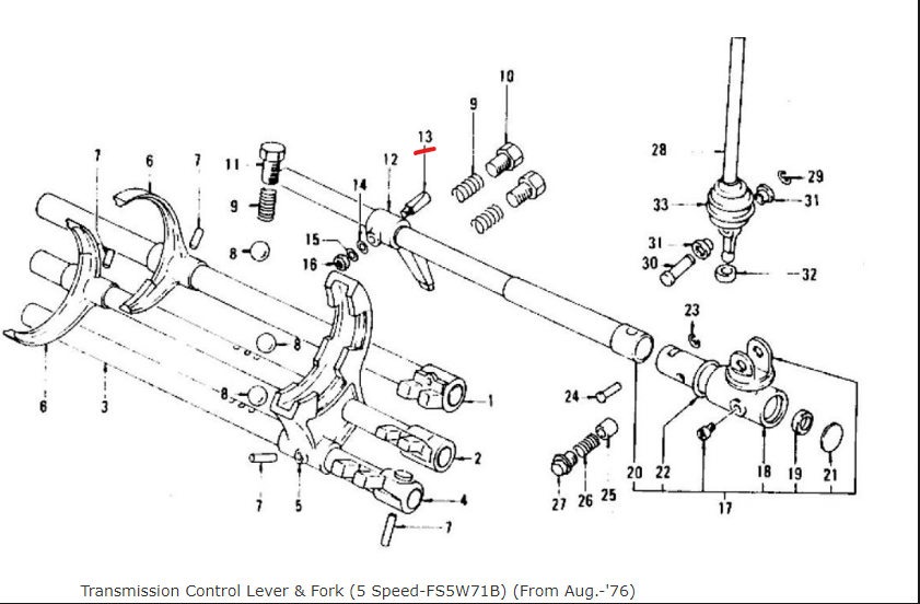

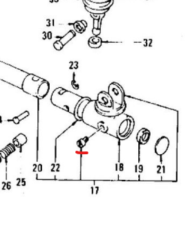

Actually that's a good find.  Maybe that's the one that leaks, not #22.  It would be #19 in the parts manual.  There's an o-ring, and an oil seal.
It looks like the end of the striker rod should come off, exposing that oil seal.  Maybe you can disassemble it without removing the rod.

Ya I was thinking that might be the culprit/would need to come out.
Anyone have any experience getting that out to change the seal?

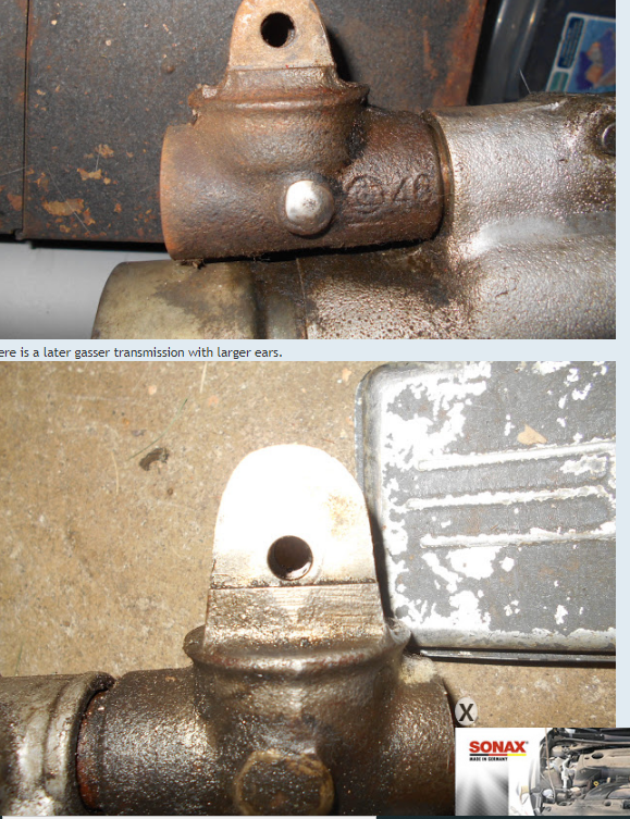

Looks like it might be a rivet.  I'll bet you could grind the head off of it and the end would come off.  Nissan never planned for this much disassembly, I'll bet,
Might be some good stuff in the thread I found when I was looking for the picture.
https://forums.nicoclub.com/transmission-stuck-in-first-gear-but-shifter-is-in-neutral-t602912.html
