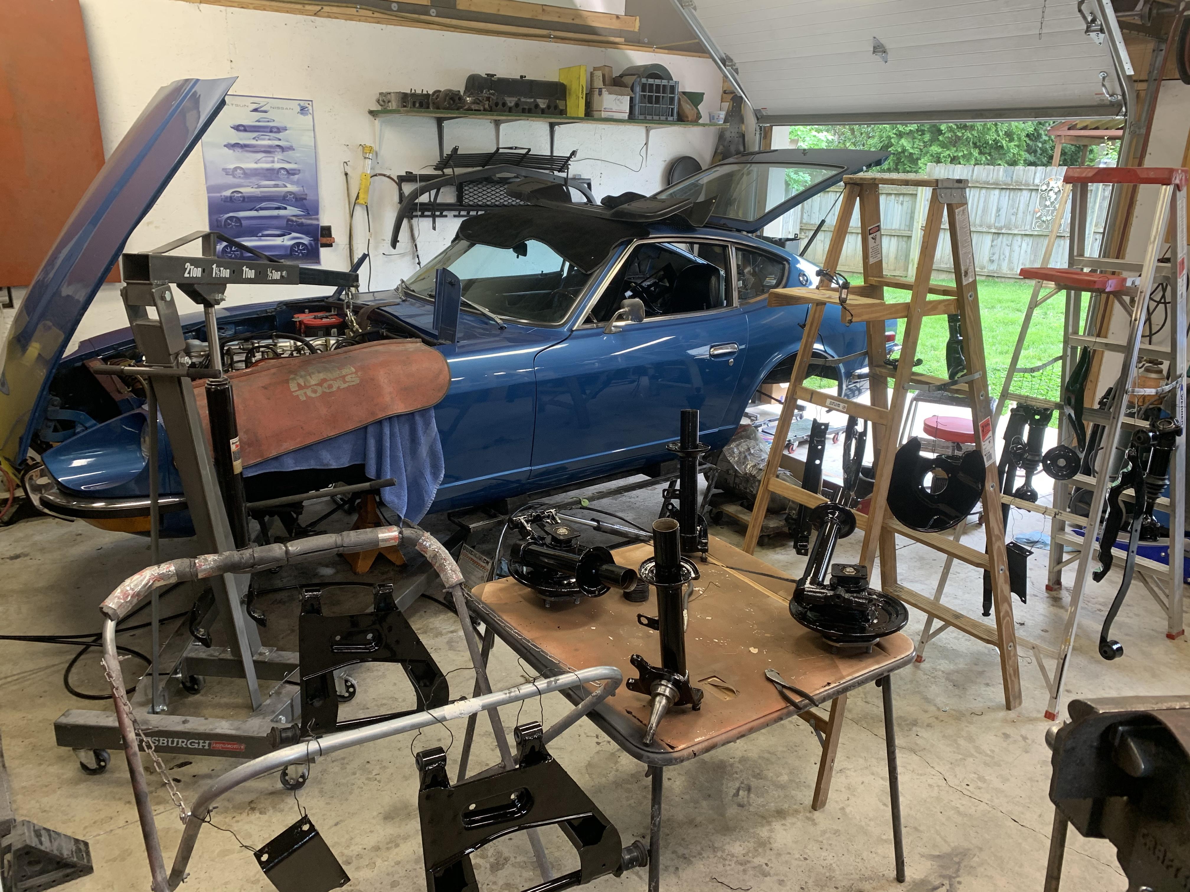

He knew the O-rings that it needed and I have them coming . I’m not sure I want to fight this battle or take it to the shop . After reading this thread I’m a little intimidated . Plus I have my hands full fixing many other things on this car .
Come to think of it - I think I have a spare 4 speed myself . But swapping out tailshafts could be a gamble not knowing condition of it .
