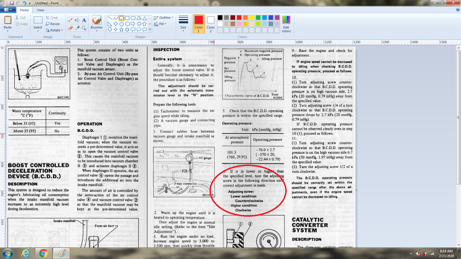

February 24, 20205 yr comment_593045 Link to comment https://www.classiczcars.com/forums/topic/63575-75-280z-6-cylinder-acting-weird/?&page=2#findComment-593045 Share on other sites More sharing options...
February 25, 20205 yr Author comment_593190 Finally reinstalled the exhaust heat shields last night after clutch install. Then I started fiddling with the BCDD and found the bolt on the bottom hanging down moves in and out freely about a 1/2 inch, kind of floppy. When pushing in, there is what could be described as soft resistance. However, the bolt can not be twisted with just my grasping fingers. Is this normal or has the bolt been completely backed out which I believe would render BCDD inop? When I get more time, i'm going to pull the TB and clean it up. Link to comment https://www.classiczcars.com/forums/topic/63575-75-280z-6-cylinder-acting-weird/?&page=2#findComment-593190 Share on other sites More sharing options...
