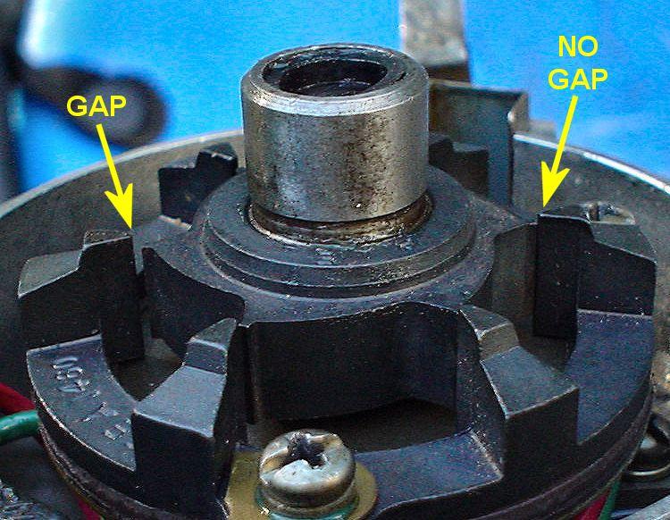

Here's my "go to" on everything 280.  This is a ZX dizzy but they're pretty much the same except for the matchbox ignition module.  You could read over it and maybe something will light that bulb in your head.  I know I've found loose ball bearings in mine when I first bought it.  It may be as simple as the reluctor being out of spec?
http://atlanticz.ca/zclub/techtips/distributorrebuild/index.html

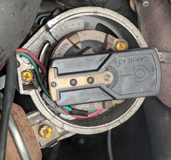

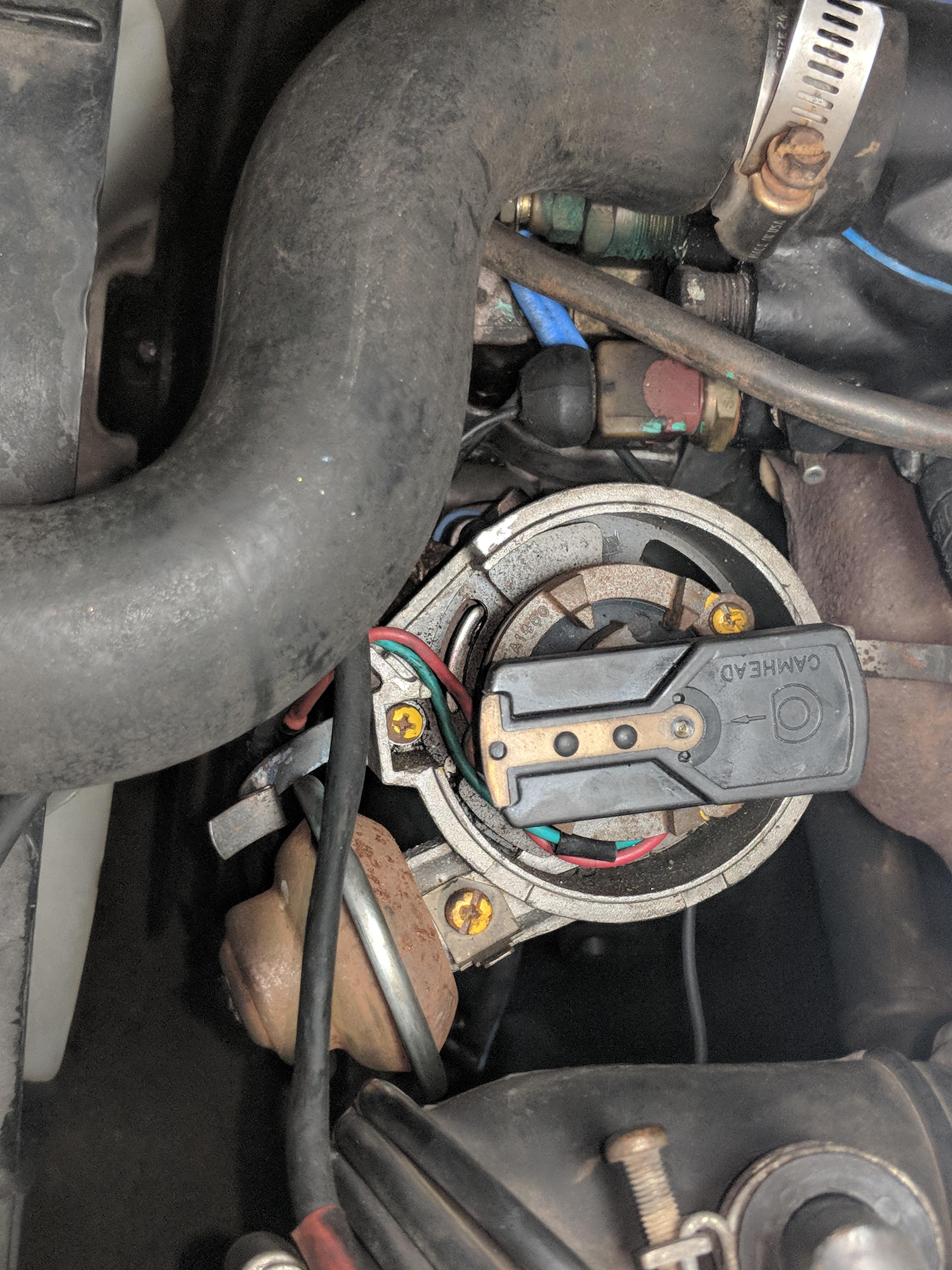

just started a new thread with the exact issue and photos.
I saw it.  But they are the wrong photos.  You need this one without the rotor.  Closeup.  to see if the shaft has play.
