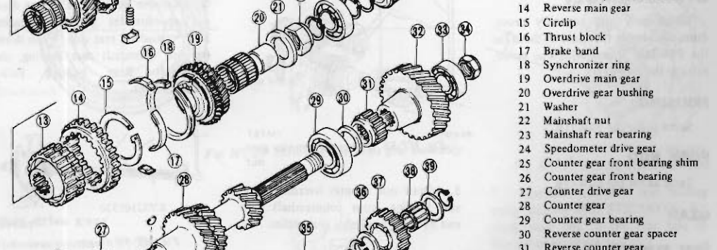

So what is it I'm looking at here? Is that the 5-R section of the trans, or is that an unsynchronized first gear? (Did they use an unsynchronized 1st gear version on the trucks of the same era?)

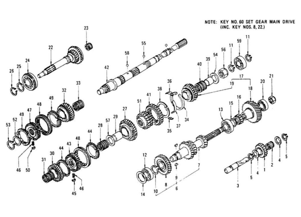

Funny, but the gear is the same part number for both, until later, with overlap from 76 - 78.  Interchangeable.  So it could be a truck gear in a 280Z if I read right.
https://www.carpartsmanual.com/datsun/pickup-1972-1979/power-train/transmission-gear/5-speed-(from-aug-76)/41
http://www.carpartsmanual.com/datsun/Z-1969-1978/power-train/transmission-gears/5-speed/40
Just realized that I didn't really absorb the full title of this thread, I just l saw 280Z and looked at the picture.  It says "1st gear" in the title but the picture is of overdrive (5th) and reverse.  Not sure where the mixup is happening, if gnozez posted the wrong picture or just got turned around mentally.  It happens.
