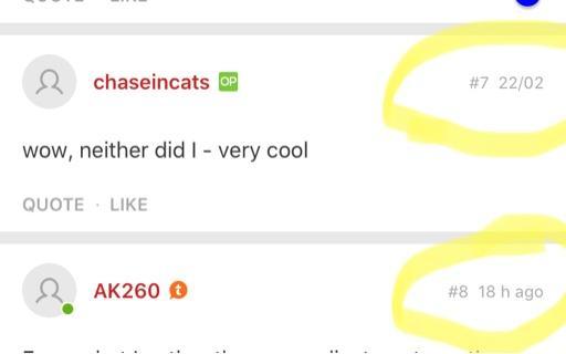

Slightly off topic - I still get post numbers using Tapatalk [emoji848]
