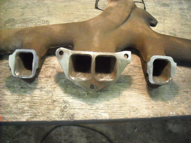

Plugging Air Rail holes in exhaust manifold
Jaymanbikes
3 hours ago, DatsunZGuy said:
I had a Z where the PO just sawed off the main rail of the air gallery and crimped the ends.  Another car I owned had it removed, plugs left in place and the holes plug welded.  The latter looked much better.
I did a hybrid of above.  I cut the tubes, pinched them closed and welded the pinch together.
