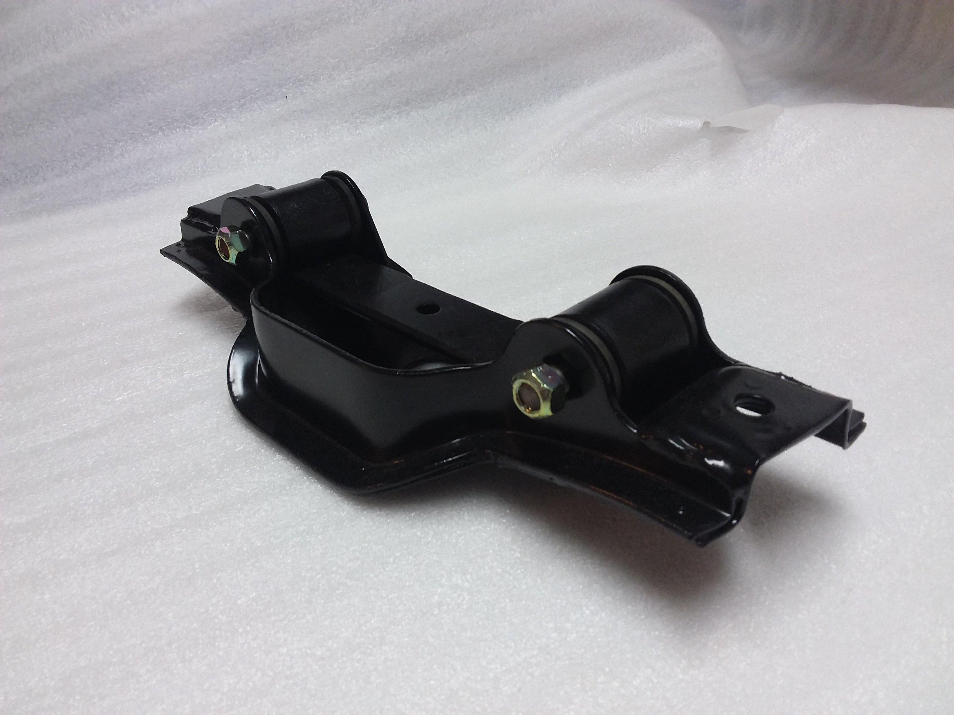

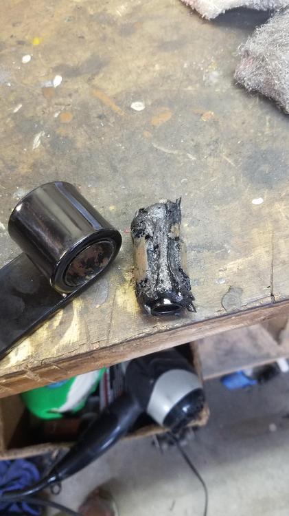

Posted February 25, 20205 yr comment_593196 I made a rookie mistake and had all the pieces of my transmission crossmember power coated including the inner piece that has the rubber bushings. Well the rubber bushings melted away- go figure. I turned to the poly bushings which apparently don't fit a 72 mount and now I'm at a bit of a loss. Anybody have any replacement ideas or even an old mount with good bushings laying around? The OEM replacement bushings have been NLA for years. Zeddsaver has a restored one for $200 plus shipping so that is always a (pricy) option. I'm trying to keep my restoration as correct as possible so I really want to stick with the original mount style. Picture of my mount style below for reference Link to comment https://www.classiczcars.com/forums/topic/63620-72-240-transmission-crossmember-rubber-bushings/ Share on other sites More sharing options...
February 26, 20205 yr comment_593203 Looks like you need part #18. It would have a metal sleeve around the rubber. Is the metal sleeve still in yours? Not really clear what went wrong with yours. The rubber does not melt. http://www.carpartsmanual.com/datsun/Z-1969-1978/engine-240z-260z/engine-mounting/manual-from-c-hls30-46001-rls30-grls30 Link to comment https://www.classiczcars.com/forums/topic/63620-72-240-transmission-crossmember-rubber-bushings/#findComment-593203 Share on other sites More sharing options...
February 26, 20205 yr Author comment_593204 #18 is what I need. It melted from the heat of the powder coating process. Link to comment https://www.classiczcars.com/forums/topic/63620-72-240-transmission-crossmember-rubber-bushings/#findComment-593204 Share on other sites More sharing options...
February 26, 20205 yr comment_593209 So the metal sleeve is still in there, I think I see it). I wonder if the urethane bushings are meant to have the sleeve removed? Might be an option if you can't find a replacement. Press the sleeve out with a vise or a press if the urethane that you have is too tight to fit. It's probably about like a front control arm bushing. Link to comment https://www.classiczcars.com/forums/topic/63620-72-240-transmission-crossmember-rubber-bushings/#findComment-593209 Share on other sites More sharing options...
February 26, 20205 yr Author comment_593223 The poly bushings they sell are still too big with the sleeve out. I actually turned one down to fit but then they are too long. Both the small diameter and the flange area are too long. Link to comment https://www.classiczcars.com/forums/topic/63620-72-240-transmission-crossmember-rubber-bushings/#findComment-593223 Share on other sites More sharing options...
