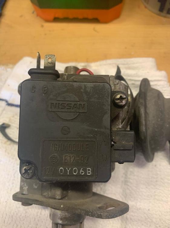

February 29, 20205 yr Author comment_593406 Alll great great info guys just what needed. Thank you. So I got one of mine apart and it’s not as complicated as I anticipated. I’m going to try and clean it all up, maybe get a new vac advance and see what happens. Also, I’m going to exchange the other one I got from the JR for another one they have sitting on a 79. Engine. They have a 30 day policy. The 79 will have a E12 80 module from what I have read. Both of mine here have the E12 92 and I’ve been reading that the side connector on that module will disrupt my timing by 8 deg if not connected. I think there is a work around on that but I haven’t gotten that far on my research. Does anyone know I need to look for when putting this back together. I read the the magnet can go bad. I didn’t know magnets went bad???Sent from my iPhone using Tapatalk Link to comment https://www.classiczcars.com/forums/topic/63629-hitachi-280zx-distributors/?&page=2#findComment-593406 Share on other sites More sharing options...

March 1, 20205 yr comment_593496 On 2/29/2020 at 4:47 AM, Av8ferg said: The 79 will have a E12 80 module from what I have read. Both of mine here have the E12 92 and I’ve been reading that the side connector on that module will disrupt my timing by 8 deg if not connected. I think there is a work around on that but I haven’t gotten that far on my research. The E12-92 will work exactly like the E12-80 if you only use the C & B connections. I've been running the E12-92 module for years this way. Link to comment https://www.classiczcars.com/forums/topic/63629-hitachi-280zx-distributors/?&page=2#findComment-593496 Share on other sites More sharing options...
March 1, 20205 yr Author comment_593503 The E12-92 will work exactly like the E12-80 if you only use the C & B connections. I've been running the E12-92 module for years this way. Can you clarify what you mean by the C & B connections? Sent from my iPhone using Tapatalk Link to comment https://www.classiczcars.com/forums/topic/63629-hitachi-280zx-distributors/?&page=2#findComment-593503 Share on other sites More sharing options...
March 1, 20205 yr comment_593505 In the picture you linked to the connections on the top of the matchbox are labeled C & B. The other 2 on the side are labeled I & W, leave those disconnected and the E12-92 will work just like the E12-80 which only has the C & B connections. Edited March 1, 20205 yr by w3wilkes Link to comment https://www.classiczcars.com/forums/topic/63629-hitachi-280zx-distributors/?&page=2#findComment-593505 Share on other sites More sharing options...
