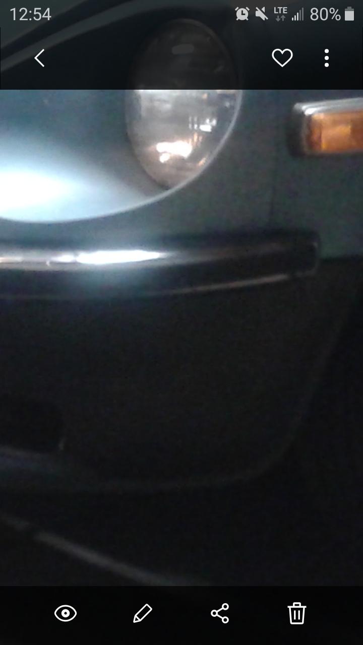

Posted February 29, 20205 yr comment_593426 I took my car apart to paint it and have it mostly back together. I have a couple of parts and can't for the life of me figure out where they go. I think it's somewhere near the front fenders but not entirely sure. Could someone point me in the right direction (see attached). Thanks! Link to comment https://www.classiczcars.com/forums/topic/63635-missing-parts/ Share on other sites More sharing options...
February 29, 20205 yr comment_593430 The kind of look like they go under the dash, inside the car. Don't know. Link to comment https://www.classiczcars.com/forums/topic/63635-missing-parts/#findComment-593430 Share on other sites More sharing options...
February 29, 20205 yr comment_593433 They look like the inner fenders under those scoop looking things I removed to put on my front air dam. In front of the tire I believe? Link to comment https://www.classiczcars.com/forums/topic/63635-missing-parts/#findComment-593433 Share on other sites More sharing options...
February 29, 20205 yr comment_593435 I scratched my head and finally at least have a clue why I can’t figure out what this. That fender badge says 280zx, so most here (including me) aren’t up on all the little hidden plastic body and fender bits and pieces. Does remind me of a mud flap like thingy Link to comment https://www.classiczcars.com/forums/topic/63635-missing-parts/#findComment-593435 Share on other sites More sharing options...
March 1, 20205 yr comment_593480 Kind of looks like they would go under the rear part of the headlight scoop. "Mudguard front - mask" 63872-P7100 & 63873-P7100 Any part numbers cast into them. http://nissan4u.com/parts/280zx/us_s130/1979_6/type_23/body_front_roof_and_floor/front_fender_and_fitting/ I have a screen shot for you but the site is telling me my pic's "can not be save contact us for assistance" @Mike ? Edited March 1, 20205 yr by Terrapin Z I can still put the link in though, just not a picture Link to comment https://www.classiczcars.com/forums/topic/63635-missing-parts/#findComment-593480 Share on other sites More sharing options...
March 1, 20205 yr comment_593498 Edit: Welp no upload for me. I'll try later. That's what I think too. My cars are all jammed up in the garage presently but here's a couple of pics that show those same holes but the point towards the front lip. Link to comment https://www.classiczcars.com/forums/topic/63635-missing-parts/#findComment-593498 Share on other sites More sharing options...
March 1, 20205 yr Author comment_593499 Thanks all. I think you are right. I may need to take the wheel off and see if I can attach it. I can see daylight up there when I look at the attached picture. Nevermind....I can't upload either! Link to comment https://www.classiczcars.com/forums/topic/63635-missing-parts/#findComment-593499 Share on other sites More sharing options...
