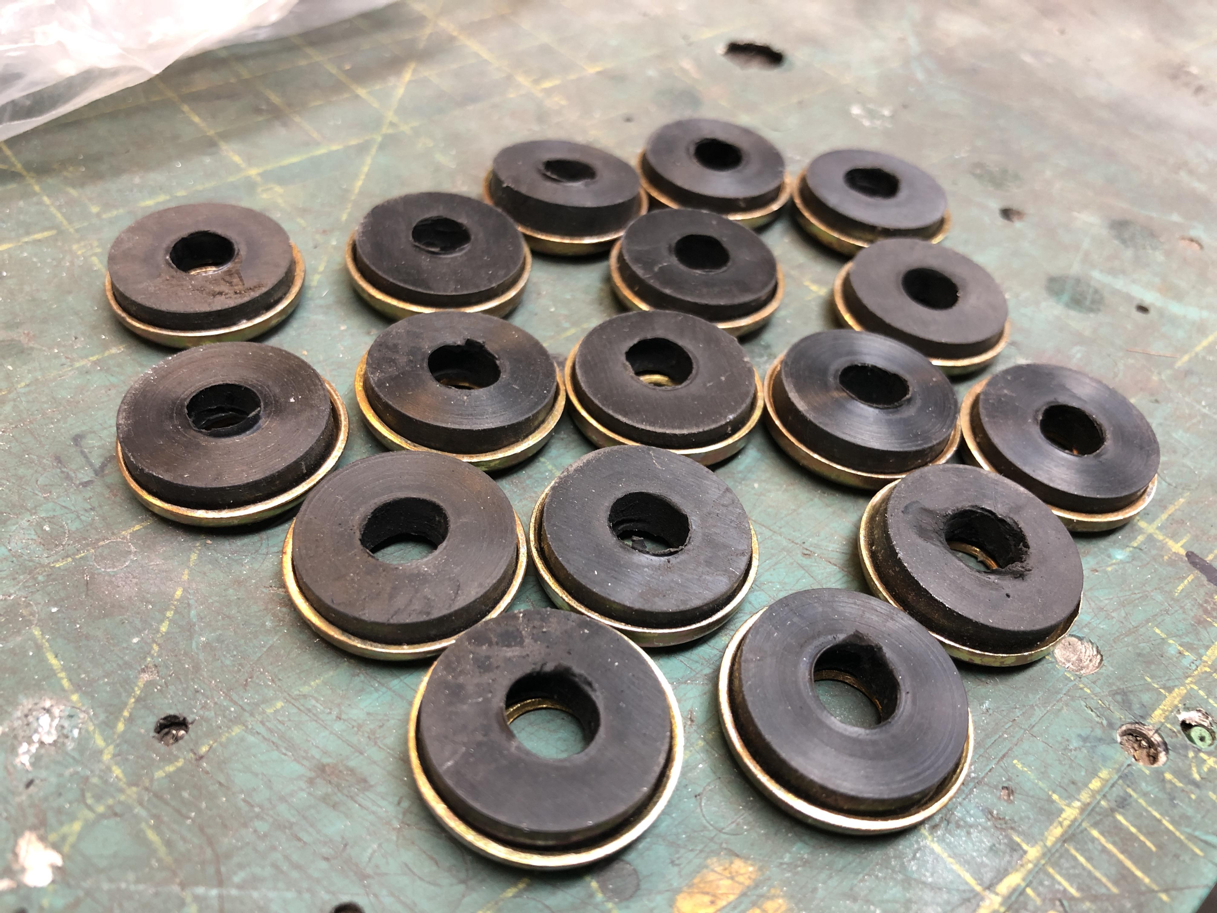

Got my plumbing washers in yesterday in the mail, got the centers drilled out to 5/16 and glued into the washers.
I think I have ~25 available now. I need about 12 to “Complete” the wing bolt sets I have, the rest are up for grabs.
Yes I cleanup the flash in the center.
I drill them out to 5/16, but they are still a bit small, so I heat a slightly larger bolt and heat melt to enlarge and smooth out up the insides. They are a nice snug fit on the wing bolts.
The washers are 11/16 OD with a 3/16 ID, so they have to drilled out. Can’t find 11/16 washers with a 5/16 hole.

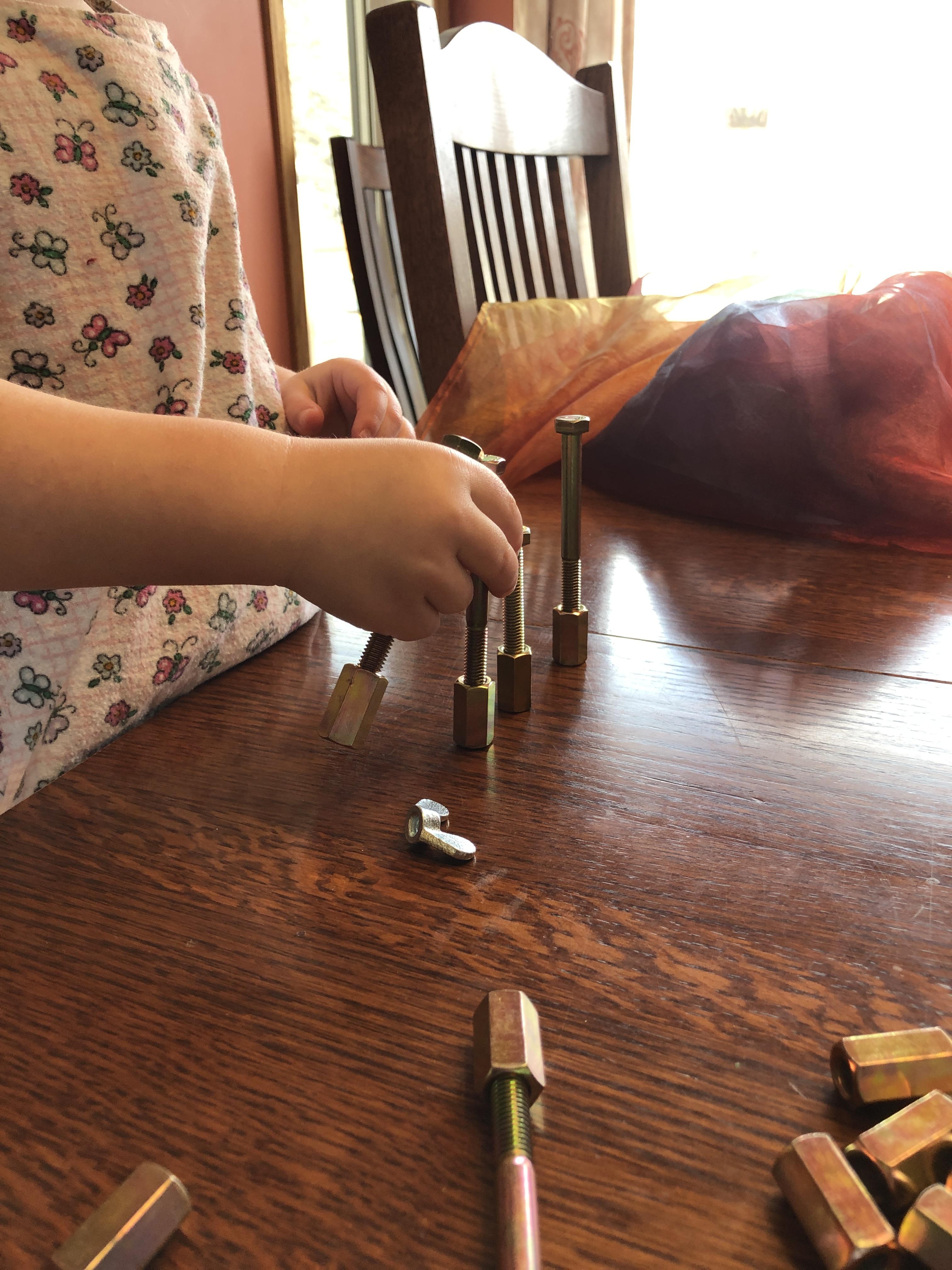

So what's up with the wing bolts and hex bass thingies? You got a pic? You can chuck hex up in the lathe easily... Just sayin'. And I can probably teach you how to cut metric threads. Probably. Old dog.

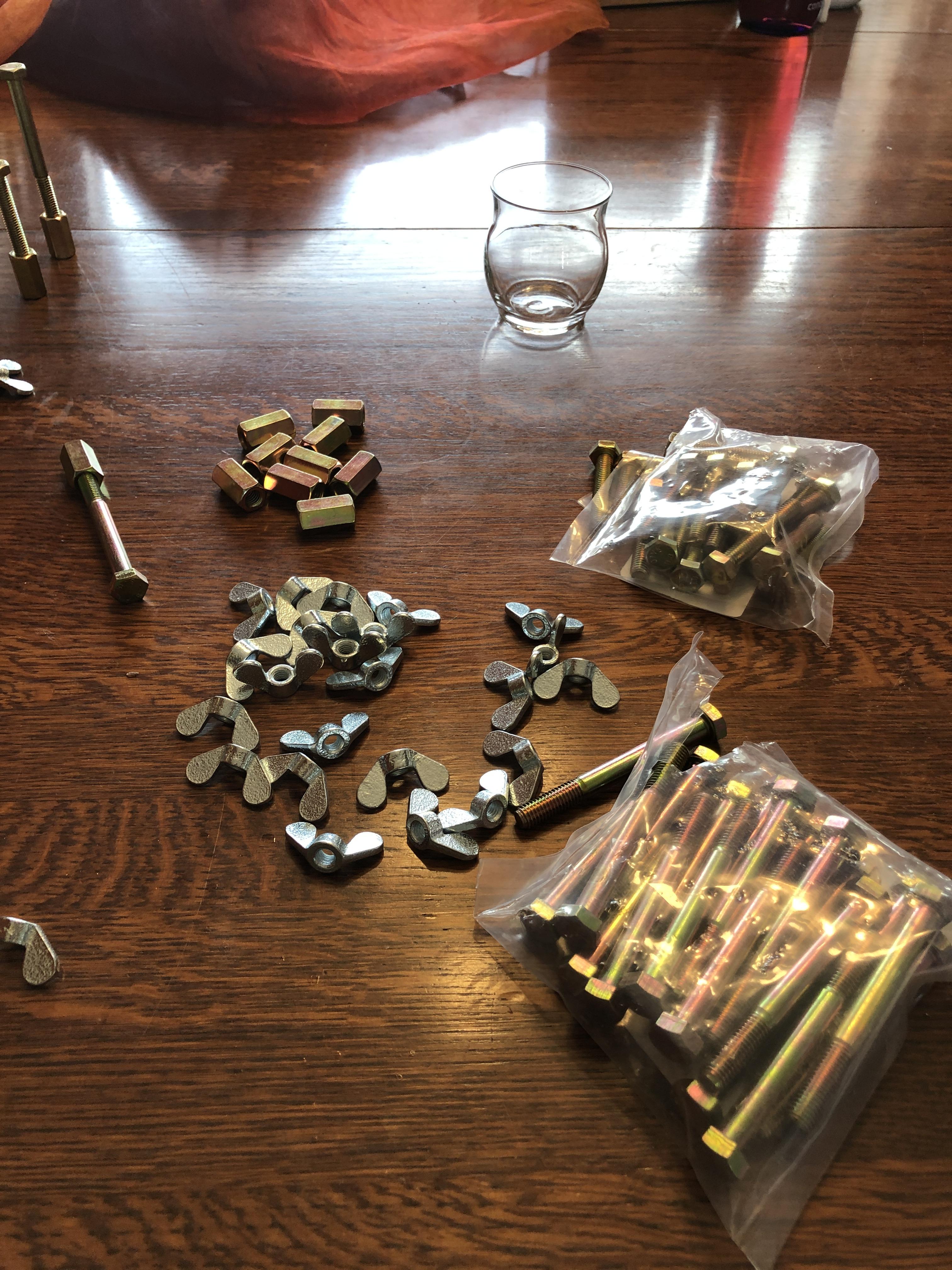

If my plan comes together I won’t have to machine much of anything, let alone threads. I’m not aiming at a perfect or even a Really close forgery of the originals, just something that looks pretty close and functions properly, and that is cheap to create.
My hardest machining task is to make a pointy ended bolt out of a regular one for the wing bolt, and cutting the head off of bolts to supply threaded stock. Raw parts costs will be in the $5 dollar range. I’m not even planning on getting the hardware plated, although that’s always an option.

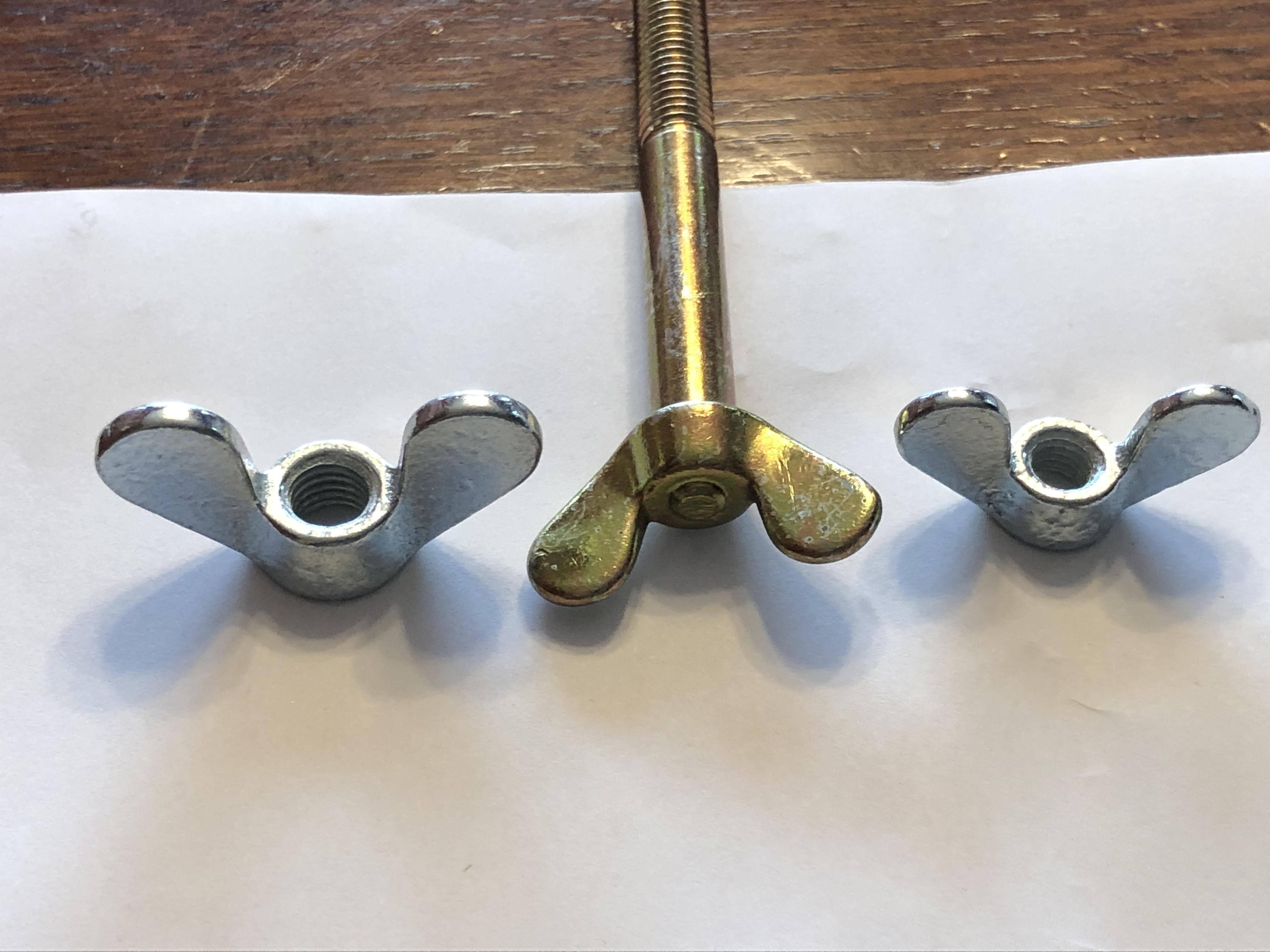

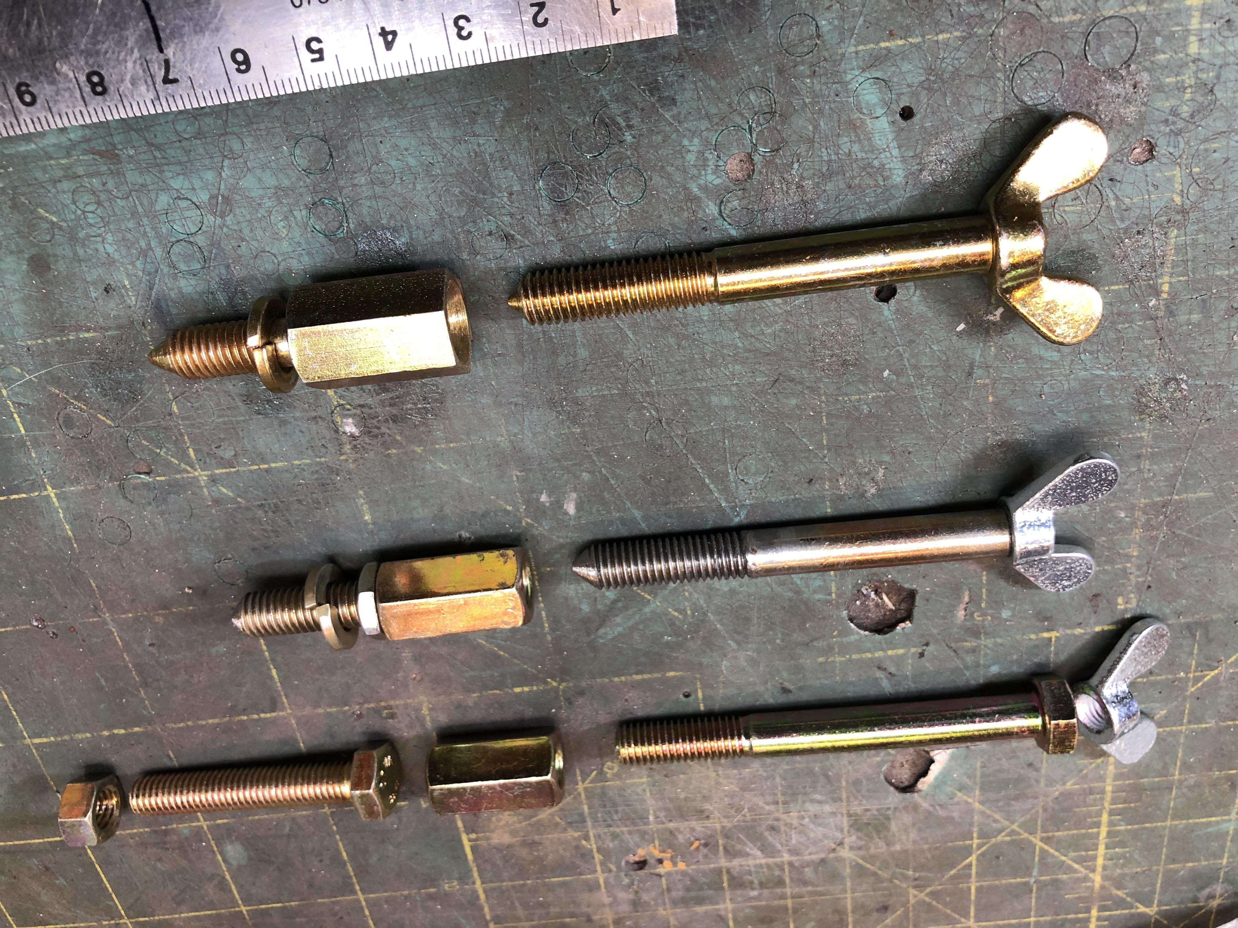

Proof of concept.

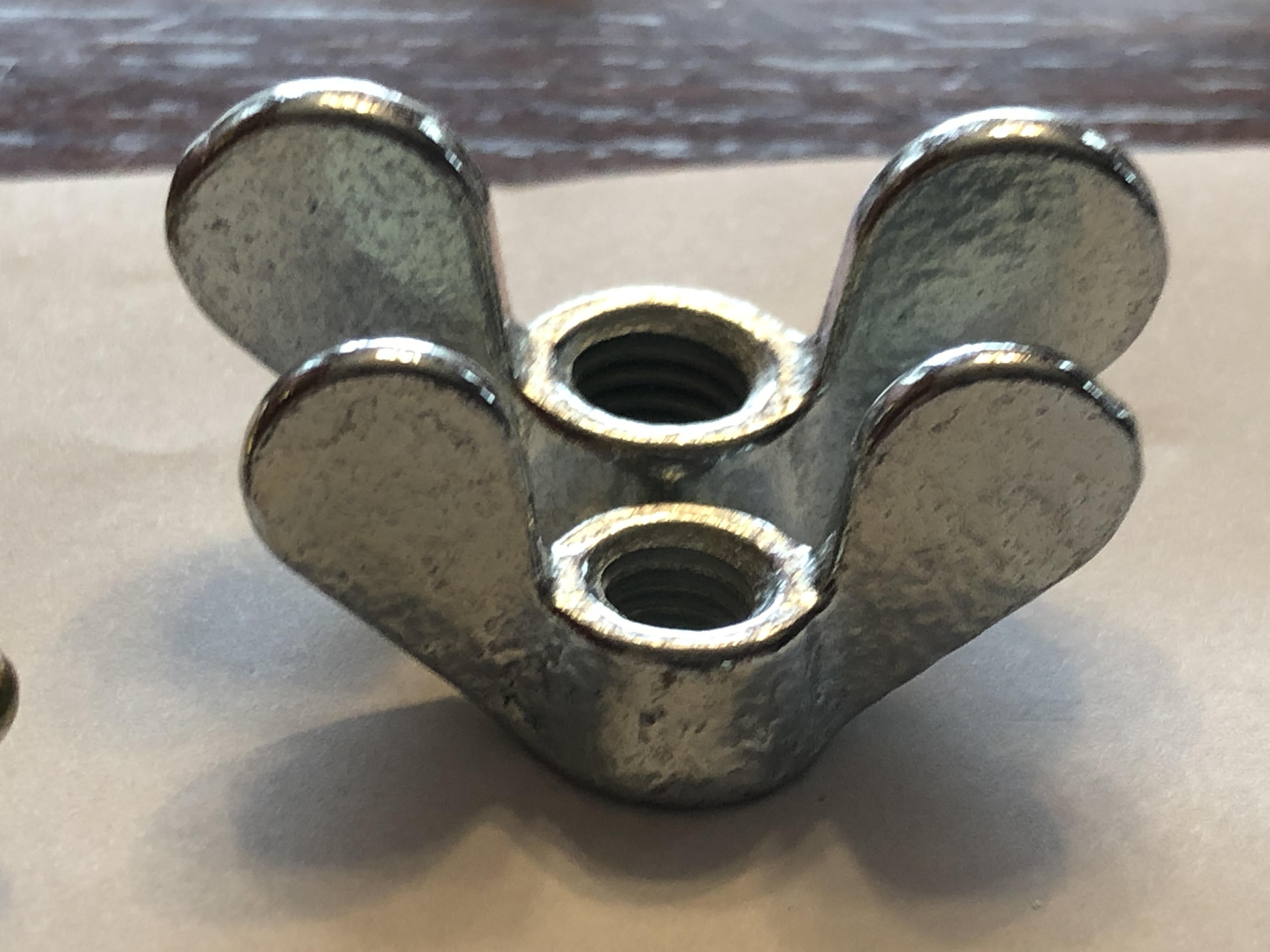

top is OEM, center is my forgery, bottom is the component parts that you start with.

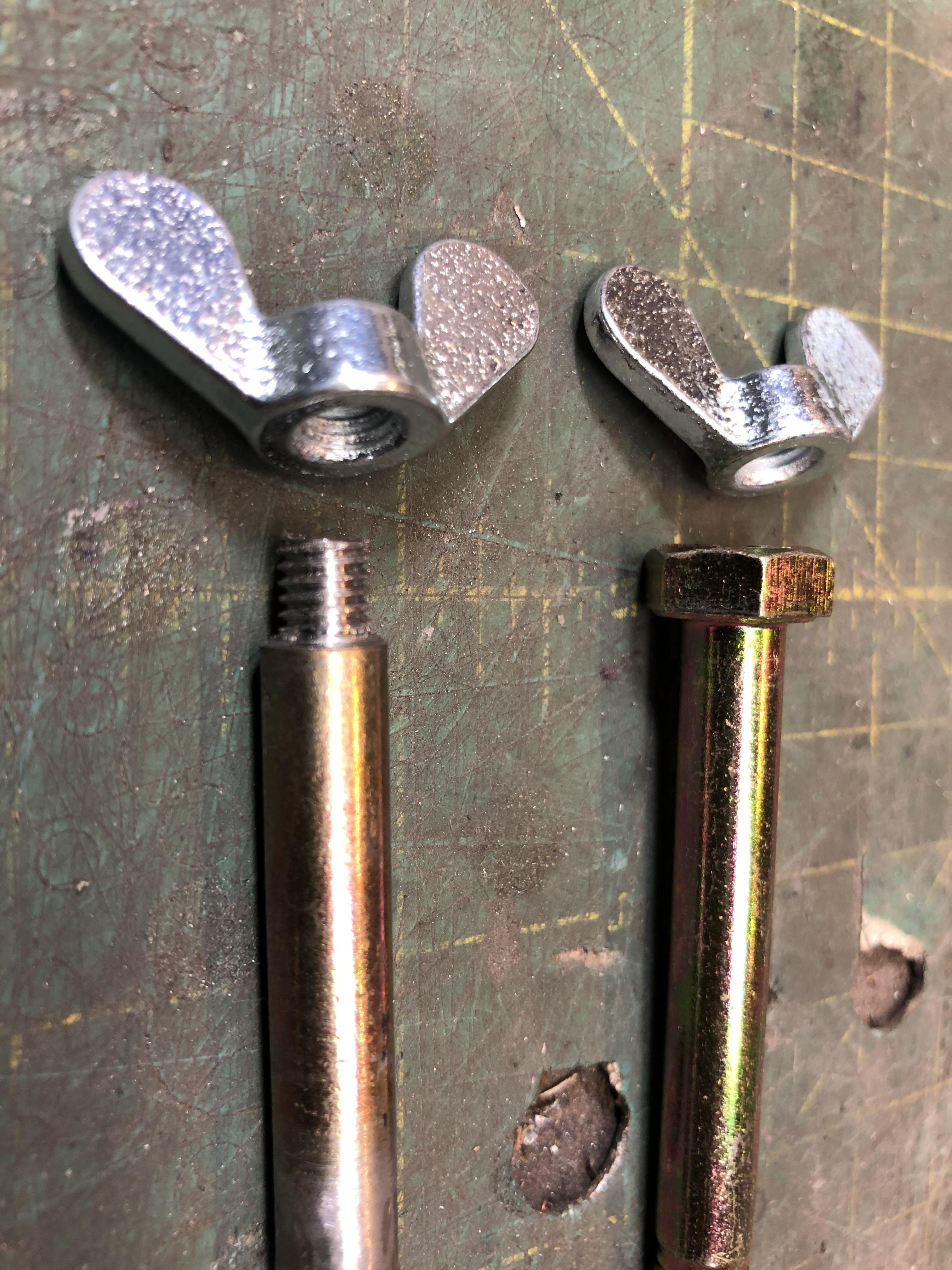

The wing nut is an M6 x 1.0 so I remove the hex head of a bolt, turn it down then run a die over it to thread.
Today I will experiment with ways to permanently affix the wing nut to the bolt. Red Locktite, welding, silver soldering  are all options.
Sort of the same issue about the lower bolt that forms the threaded leg of hex coupler. It is threaded in 3 threads, then presently a thin nut is used to lock it in place. I would prefer to weld that in. I will likely TIG it on, then turn it smooth over the weld area.
I initially bought M8 wing nuts, but they are quite a bit bigger than the M6 which are pretty much identical to the OEM wings (other than the silver zinc finish).
I can these as an option however, as they would be much easier to tighten and loosen than the stock size wing nuts.
