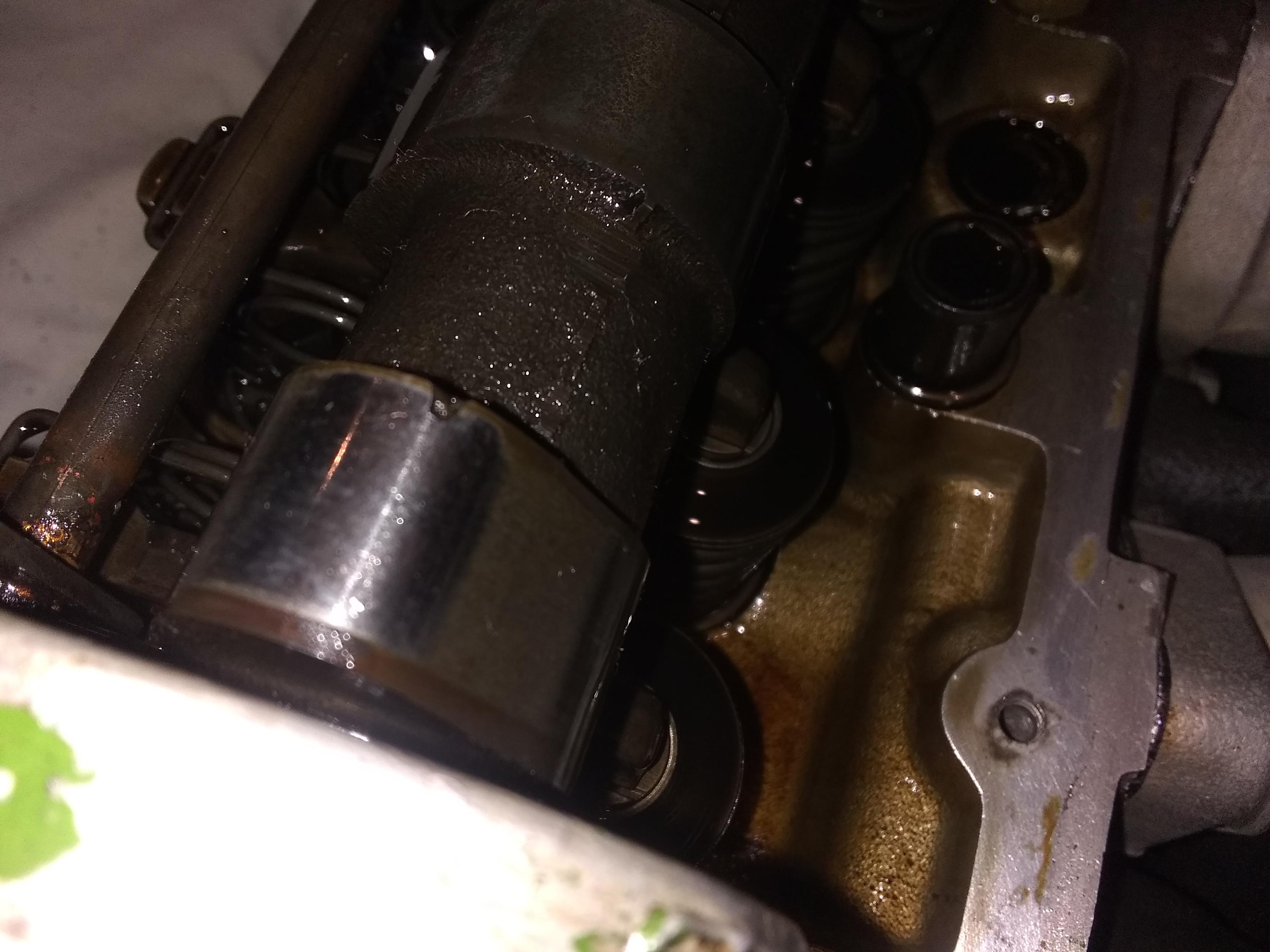

The refurbishment of my 1971 Z has been coming along. I got the engine compartment detailed and its running well. I thought I was done working on it for a while.

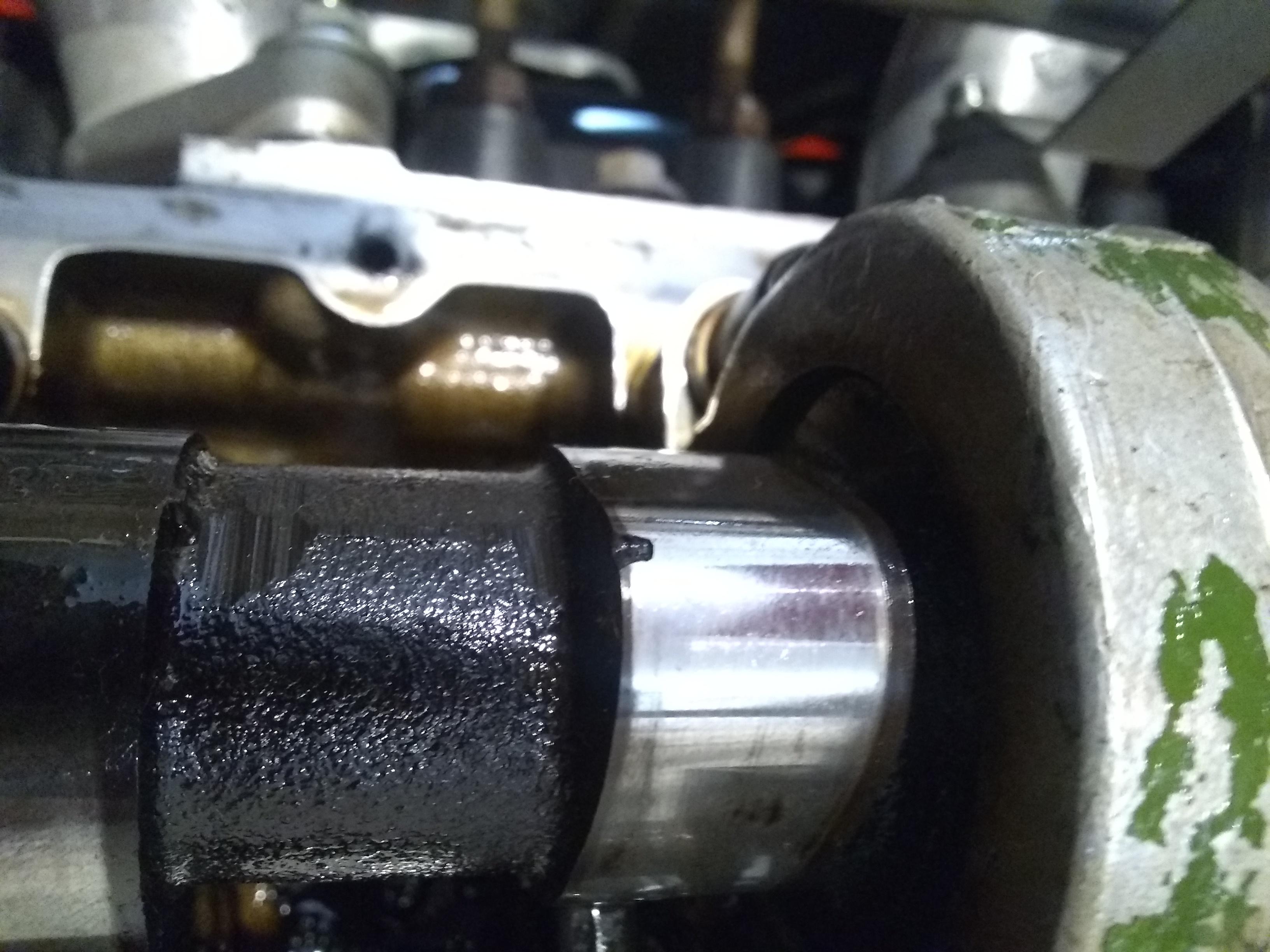

There has always been a ticking sound in the top end. I was re checking the adjustment on the valves and I think I found it. There is a chunk out of a valve lobe. There is a little scoring on the rest of the lobe but nothing crazy. It seems like it should be replaced right?
I would like to use this opportunity to upgrade to a cam with internal oiling and block off the oil rail. I would like to keep the cam stock if possible. I can only find performance cams. It looks like I should change the rockers too. Do they make a stock internally oiled cam kit that will fit a 240z?

I’ve got extra stock cams for early heads - spray bar . That doesn’t look terrible but could be source of tick. Sometimes these motors tick a little . Rocker condition should be inspected .
Stay with stock cam - cmon - cam it !!!!!
If I had to replace a cam, I would never go back stock. Now if I wanted to appear and sound stock, I would just go with a little less aggressive cam
I would recheck lash and inspect the lifters. It has a little noise but not terrible. You could always adjust on the tight side of the spec

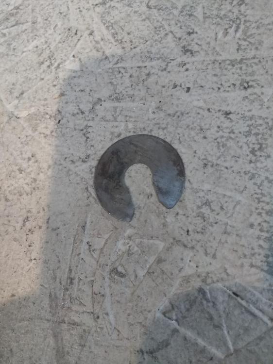

This is kind of embarrassing, but I found a part in my parts washer. I don't know what it is. I think it has to do with the brakes. Maybe the master cylinder. Can anyone identify this part?
