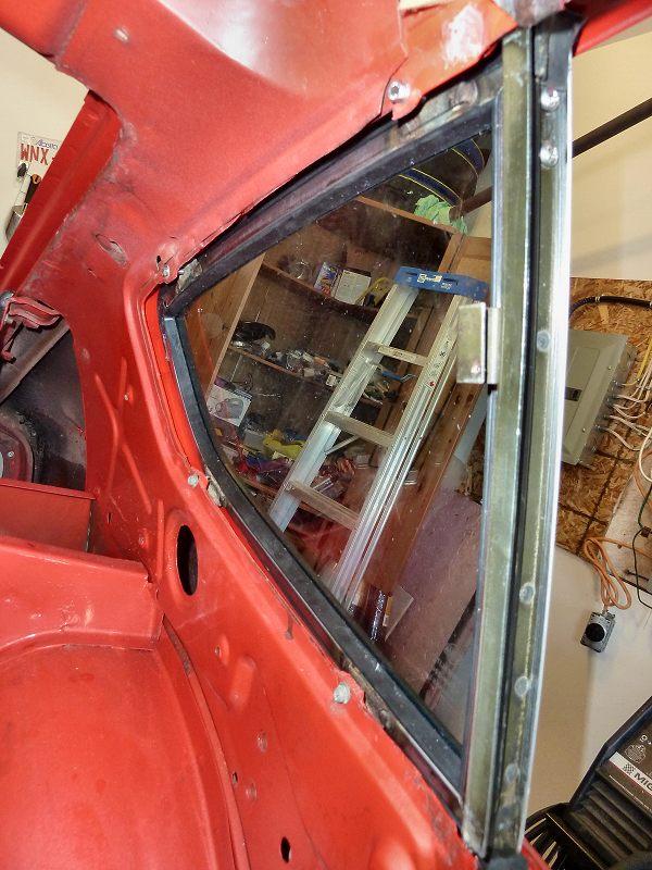

Being struggling with these for FAR too long this afternoon.  Yes, the seals are installed correctly, with the longer "leg" of the seal's "U" toward the outside.
I knew it was going to be a struggle, but holy cow.  I can get the bottom 2 screws in (barely), but the top two end up 1/2" or so off and will not go any farther.  Gap between the seal and the body at the back at the window.  I've tried silicone spray on the seals, and it helped a bit, but it feels like it's just bottoming out mechanically, not sticking.
Any and all advice appreciated.

I would warm up the seal, lube it and the body, then when you insert the window try to get an awl in both top and bottom holes at the back and draw the window in, a second pairs of hands can set a screw in the top and bottom hole in the front and push the window in from the outside at the same time.

Thanks guys.  The seals are brand new and soft and supple already, so heat was of limited effect.  I also didn't want to remove them since they're already bonded to the quarterlight frames with weatherstripping adhesive.
This was the winning technique:
I pivoted the rear corner up and in just enough to be able to insert a thick drift punch (my "awl") through the top rear holes and draw it toward the back.  I was concerned I would crush the threads but it was OK.  While holding it with one hand, the other hand secured the top front screw.  After having lubed the bottom of the cavity, I was able to push the bottom of the window in enough to secure the bottom two screws.

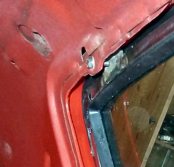

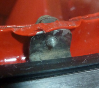

I just did this recently and for sure it's not an easy task, I even tried ratcheting straps without success. I lubed the seals with silicone spray and trick for me was to fasten the first top screw (facing the front of the vehicle) the bottom screw directly underneath and applying  appropriate pressure.
Hope this helps.

1 minute ago, 240260280 said:
The trick it to buy longer screws or bolts and bring the window in a little at a time until you can replace each long screw one-at-a time with a shorter screw.

Good point!  Two thoughts:
- I am going to retrofit (slightly) longer bolts with an actual hex head.  Way too much pressure on the tiny phillips screws and they strip out too easily.
- Wick Humble says the later Z actually went to longer screws b/c (his theory) the factory assembly line workers were having the same issue we are...
