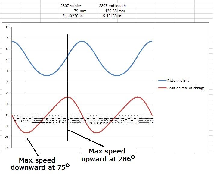

Searching through my stack of old CD's was fruitless. I was able to start over though and here's what I was able to whip up so far. Using the 280Z stroke length and center to center rod length, I get the following:
Note that for my calculations, I used everything pointing straight up (TDC) as" zero degrees". So the maximum piston speeds occur at 75 degrees off vertical. About 75 degrees after TDC when going down, and about 75 degrees before TDC going back up.

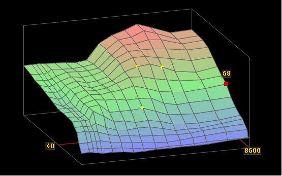

Here's my VE table. At the front is closed throttle, the back is full throttle.
2e78302f65e4c85978eec66382b3f559.jpg&key=7d5522be7b75814693cb3782e733937b09ca0678dafa10da65fa75961a2e6584
This is great Jon - it looks like your engine comes on song at 4K rpm. Does this lot correlate with your BHP curve?
How did you get this table? What are the parameters used to generate it? Does it take into consideration things like inlet tract / header length etc or is it purely what happens in the engine by itself?
It comes from Tuner Studio (I'm a tuner too, u get me bro?) It's the fuel table for my injection, so it's actually a pretty accurate reflection of the VE and includes all the bits and bobs from the airbox onward. Yes, it does correlate to where the power is well.
In a stock engine I guess the action starts around 2500, so I think the rising VE and likelihood of knocking is probably why the ignition curve stays flat.
Maybe in theory one could start adding more advance again after the the torque/VE peak is passed, but that's would be very hard with springs and weights!
