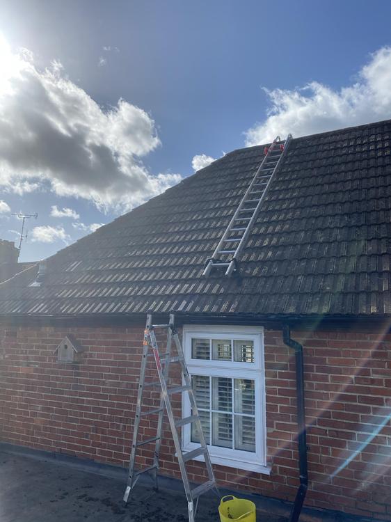

Re. The state of the world as is, I don’t think I’ve done this much intensive work on the house as I have been of late. Even been fixing the roof in between monsoon like showers. My wife is also on indefinite working from home and the school just wrote to say they may close physically and go google classroom next week. Quarantined with the kids!? Arrrrrghhhhh!

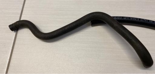

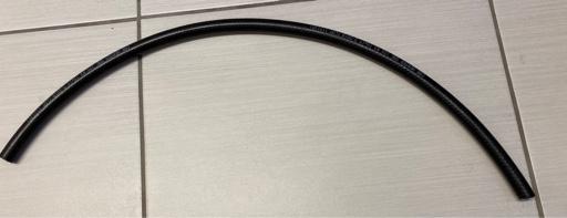

Funny you should say that, I’m about to turn this ....
Into one of these ....
