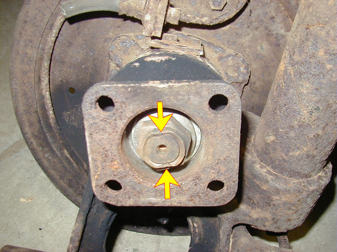

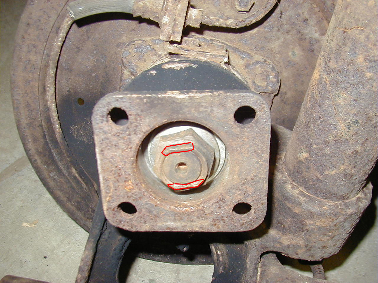

March 17, 20205 yr comment_594565 I am surprised you need to remove the peened area, I assumed it was not really over any threads, and it was only there to prevent backing off from vibration, not an impact driver. Have not done this yet but will use the ZX nuts when I do, good tip. Link to comment https://www.classiczcars.com/forums/topic/63681-78-280z-rear-strut-removal/?&page=2#findComment-594565 Share on other sites More sharing options...
March 17, 20205 yr comment_594572 46 minutes ago, Dave WM said: I am surprised you need to remove the peened area, I assumed it was not really over any threads, and it was only there to prevent backing off from vibration, not an impact driver. Have not done this yet but will use the ZX nuts when I do, good tip. I've seen several videos of damaged threads from not removing the peened section of the nut. BTW, the ZX nut part number is 43262-W1200 Link to comment https://www.classiczcars.com/forums/topic/63681-78-280z-rear-strut-removal/?&page=2#findComment-594572 Share on other sites More sharing options...

March 18, 20205 yr comment_594650 Some pictures to describe what Jeff G did............................................... Link to comment https://www.classiczcars.com/forums/topic/63681-78-280z-rear-strut-removal/?&page=2#findComment-594650 Share on other sites More sharing options...

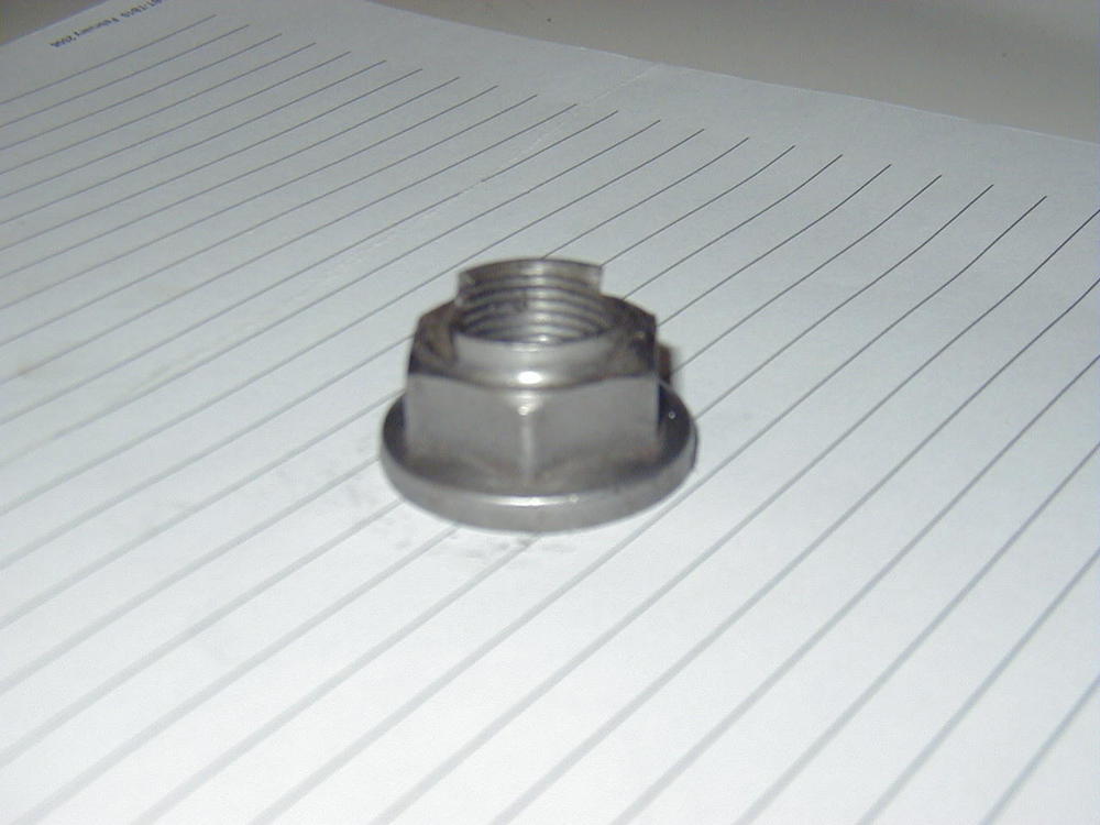

March 18, 20205 yr comment_594652 The ZX's don't have the flats on the axle. Here's the nut. https://www.thezstore.com/page/TZS/PROD/classic22e06/23-4572 Link to comment https://www.classiczcars.com/forums/topic/63681-78-280z-rear-strut-removal/?&page=2#findComment-594652 Share on other sites More sharing options...
March 18, 20205 yr comment_594662 The ZX nut is a prevailing torque nut which means it is slightly out of round at the small end. It's a very common design that the entire auto industry uses for critical fasteners. Link to comment https://www.classiczcars.com/forums/topic/63681-78-280z-rear-strut-removal/?&page=2#findComment-594662 Share on other sites More sharing options...

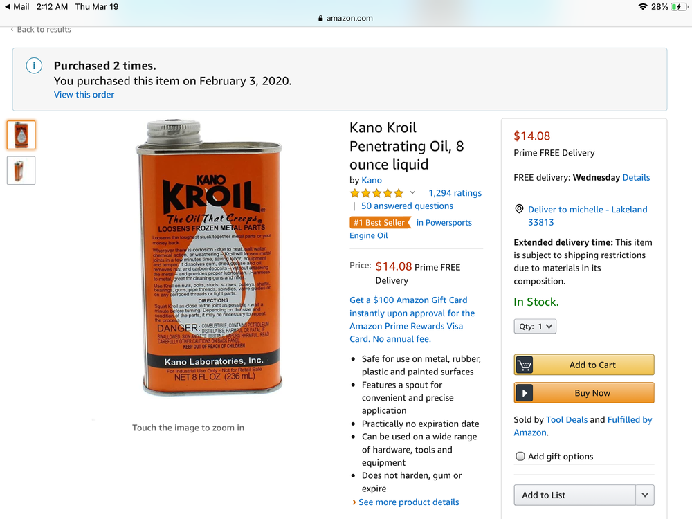

March 19, 20205 yr comment_594705 Just finished my suspension rebuild. One product I found for anything frozen/rusted shut is Kroil penetrating oil. It’s an amazing product. Found it on Amazon, a little pricy but well worth it. Out performed anything else I tried. Link to comment https://www.classiczcars.com/forums/topic/63681-78-280z-rear-strut-removal/?&page=2#findComment-594705 Share on other sites More sharing options...

March 19, 20205 yr comment_594729 8 hours ago, Yarb said: Just finished my suspension rebuild. One product I found for anything frozen/rusted shut is Kroil penetrating oil. It’s an amazing product. Found it on Amazon, a little pricy but well worth it. Out performed anything else I tried. Used to get it at work. Also found that the local NAPA store carries it. It really does work great! Edited March 19, 20205 yr by crayZlair spelling error Link to comment https://www.classiczcars.com/forums/topic/63681-78-280z-rear-strut-removal/?&page=2#findComment-594729 Share on other sites More sharing options...
